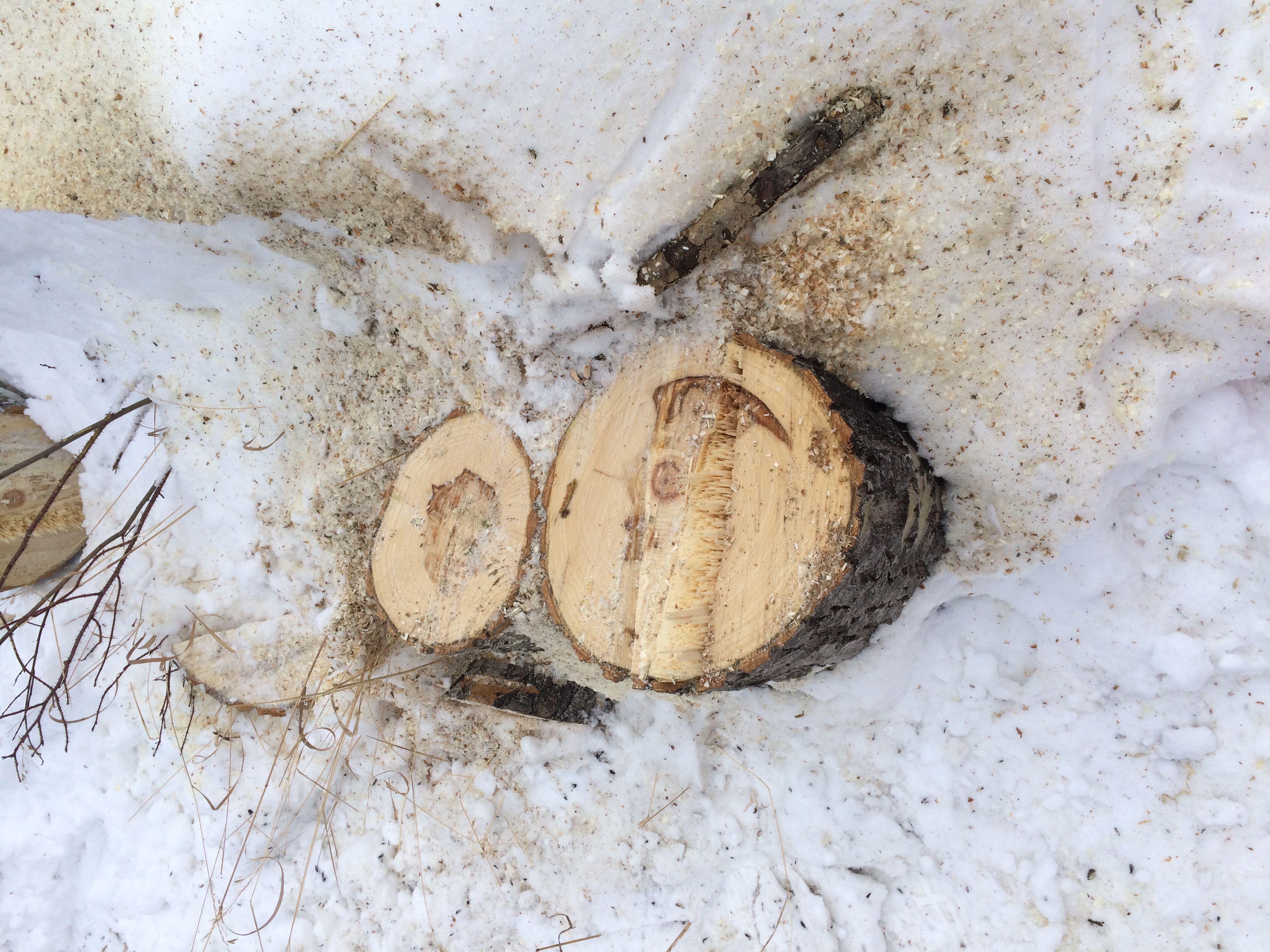

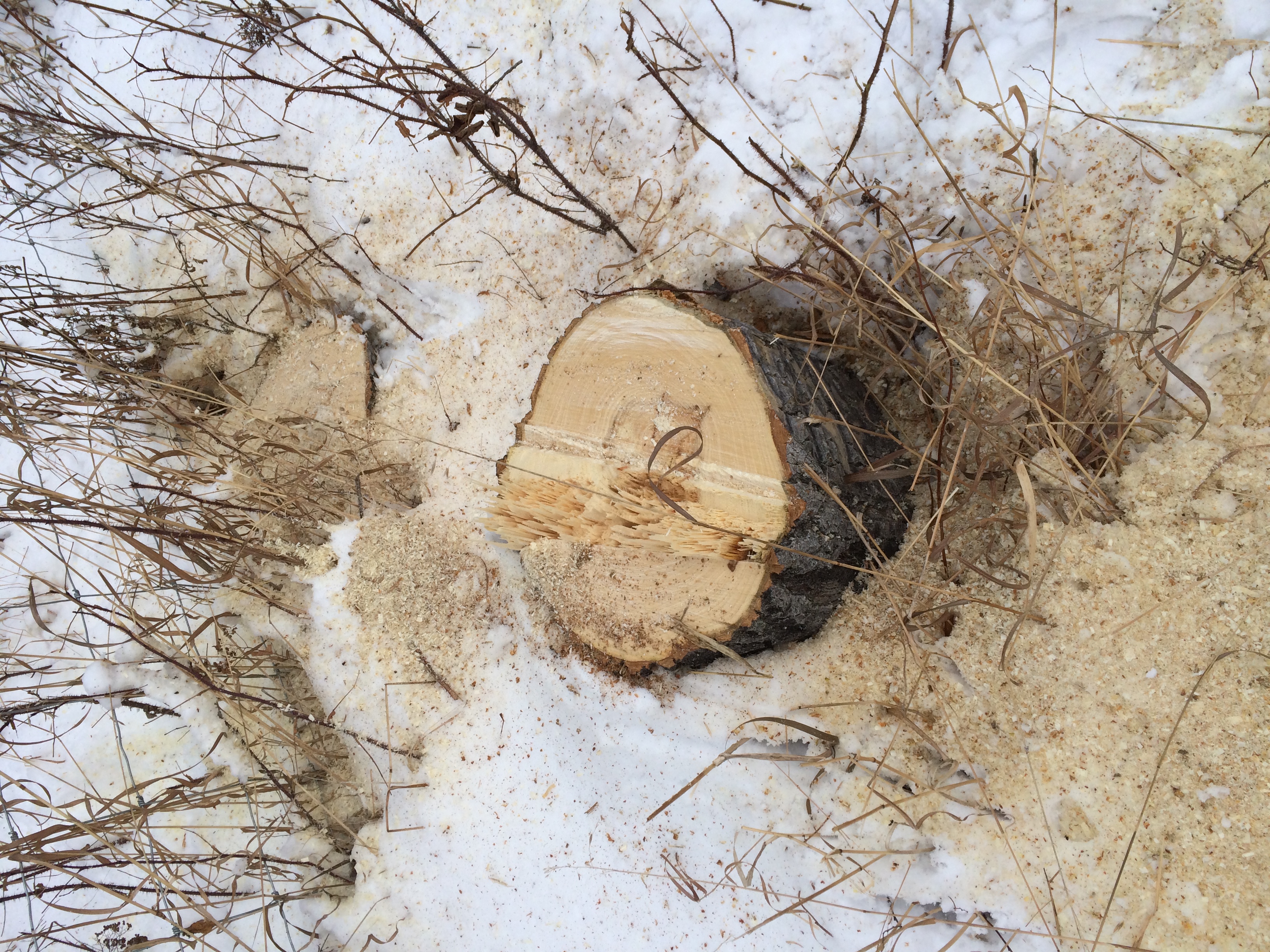

Poplars are pretty spring at this time of the year, the sap is beginning to run. I just pulled them close to vertical, cut the notch and a back cut image.jpegimage.jpegand the pulled em over with the winch.

I just pulled them close to vertical, cut the notch and a back cut and the pulled em over with the winch.
Backcutting when there's a lateral strain (either due to pulling with a cable or gravity (leaner)) on the trunk is when you get a barber chair. Look up the Youtube videos. Very dangerous.
