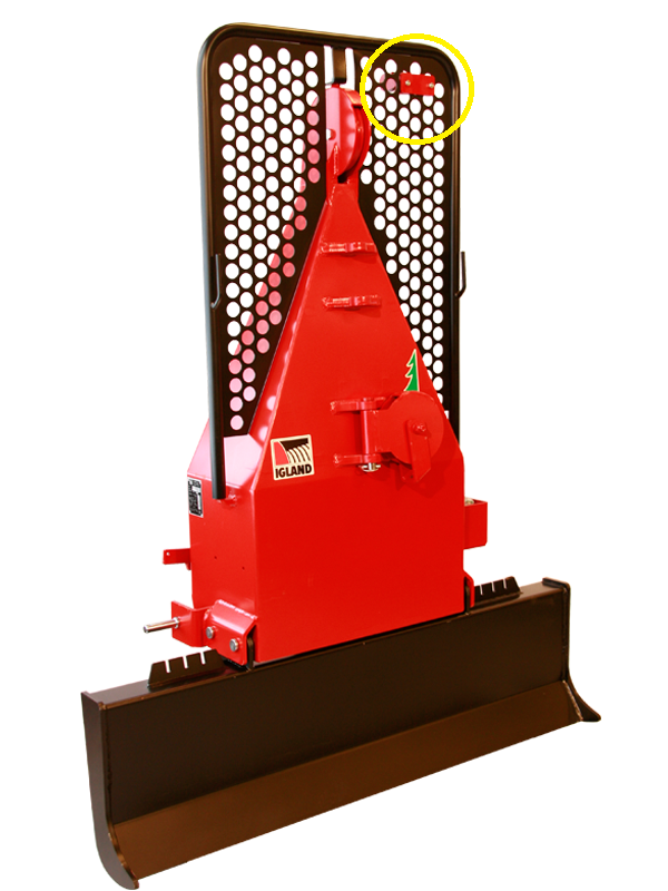

4501-2.png That is the pulley for the pull rope to activate the clutch, its on a swivel so you can pull from any angle.

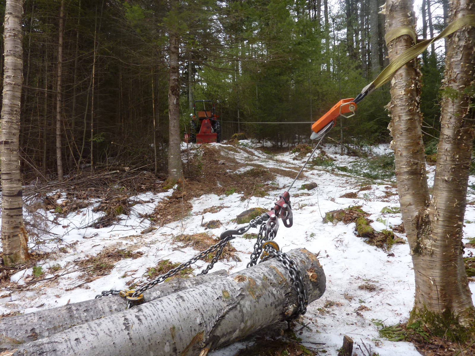

From my experience when I lose log in a hitch It is not because the chain came out of the choker hook it is because the chain loop slid or was pushed of the log. Most times I have to unhook the chain from the choker and make a new loop around the log. If you lose a lot of logs try taking two wraps of chain around them before going thru the hook especially light logs where you don't get much bite or slippery logs like beech. Or choker them father back behind a bulge or flare. You can also lock the choker on with the slider but it might be hard to unhook at the landing. Another thing to think about is try to make the free chain lengths on each log such that the slider tightens your choker before the trailing log comes up along side and pushes the loose chain off. Hard to explain but look in the picture and you will see the hook log is well back behind the chain on the top log so the hook log can't come up and slide against the top log and push the choker off before it is tight. Also the top lop has two wraps. Every one looses a log once in a while but if it is common place try doing things different to lessen the problem.

By the way nice pic. Gordon, let me guess, that wasn't taken today was it. What we doing with Popular, boards or post?
