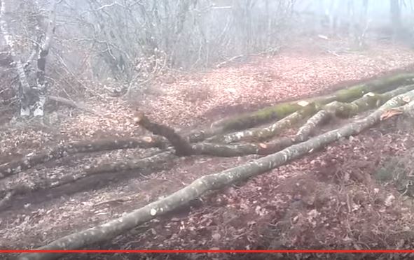

This guy has my stile of logging, pull to the max, then a little more. He has a nice tractor and winch for getting trees off a mountain, I see where the hand held remote come's in handy here, better then doing the rope-a-dope. My tractor could probably pull one of those trees.
TREUIL TAJFUN 1 TONNES RADIOCOMMANDE FALARD - YouTube
   / Skidding Winches #256
Looking at those logs he was dragging makes me wonder the value of keeping them that long. The last 20' or 3 meters seem small.

Yes those trees did look really long, must be that mountain affect, I'd have to cut them in half so I could pull one. I usually go down to 2 or 3 inches and leave the limbs on, cut off out at the would pile, or sometimes I cut them off in the woods and load em in the bucket, another good use for a loader, which why I just understand why a lot of overseas logging is done without a loader on a tractor.
