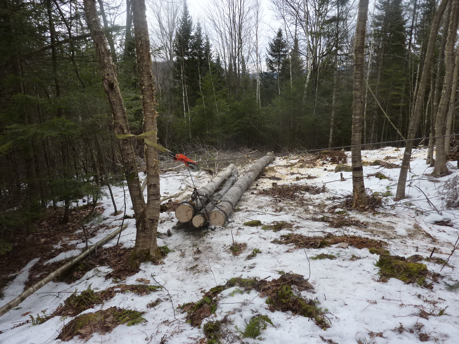

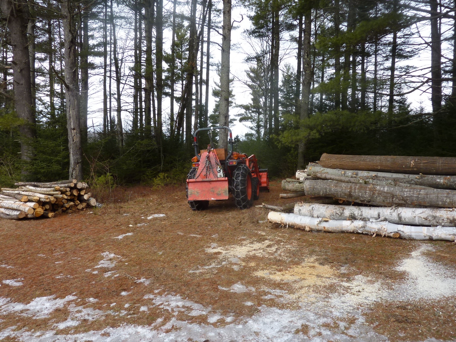

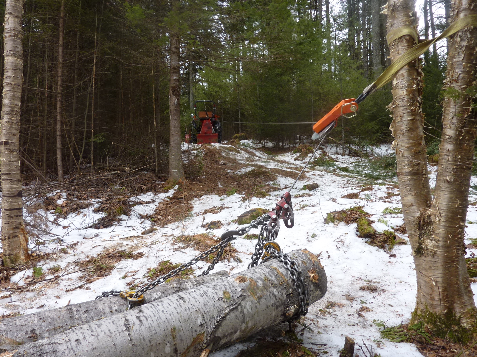

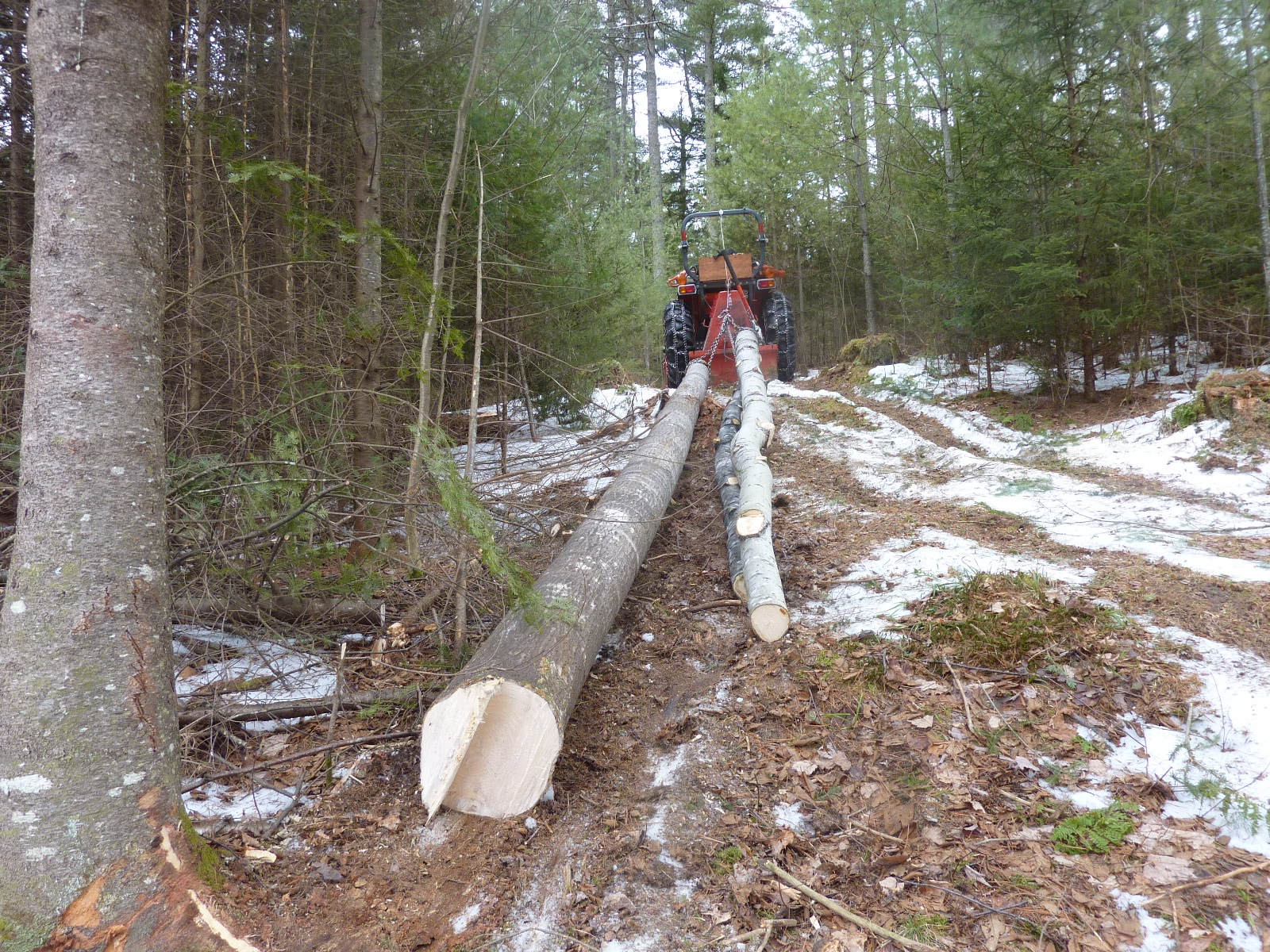

I needed some 2x4's, so I headed to my woodlot and skidded out two 24" wind damaged white pines,
Then off to the mill I go, to turn them into construction lumber!

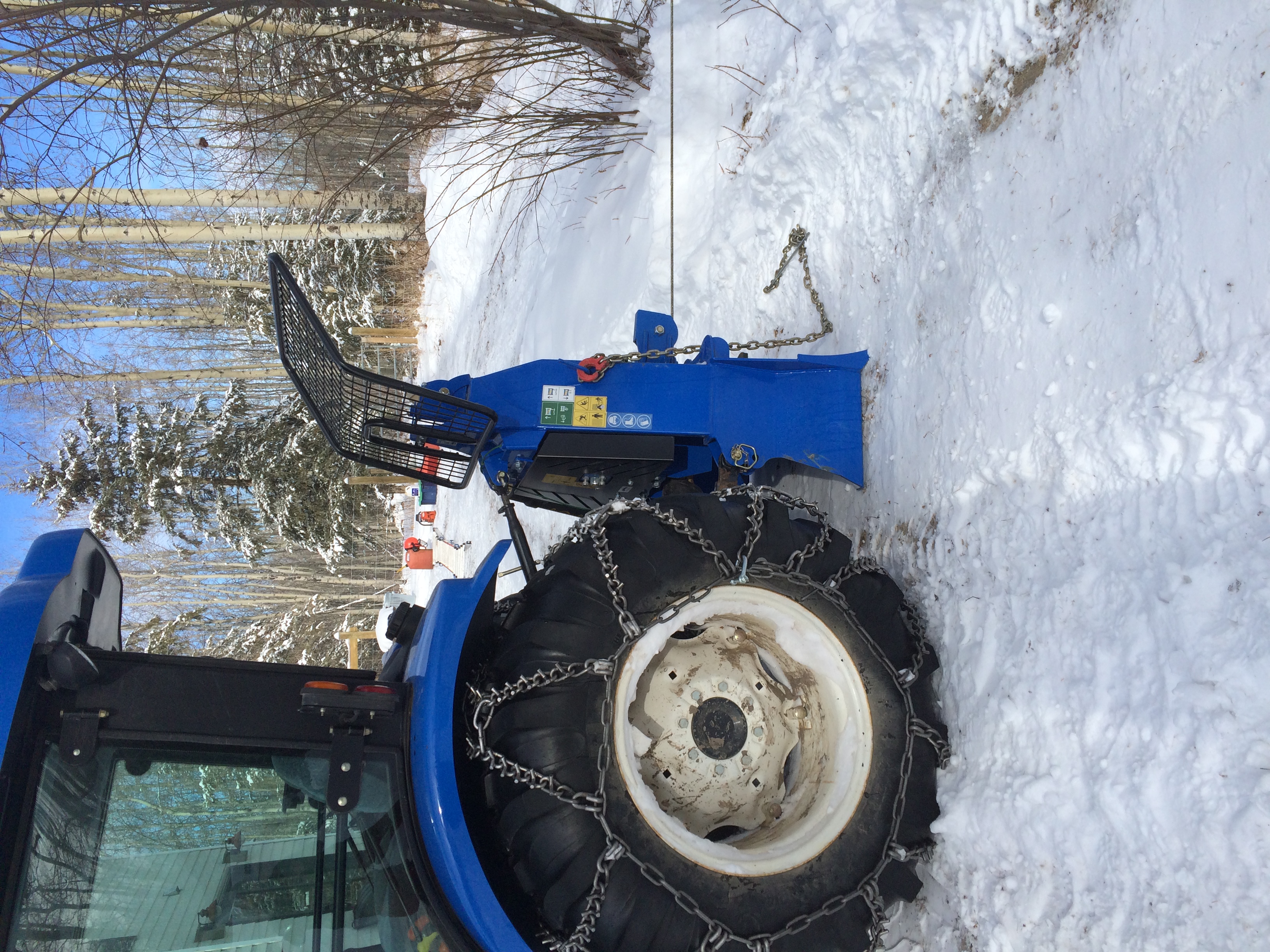

Gordon, do you know if any of the Farmi winches are QH/i-Match compatible?
I don't believe any of the winches (at least Farmi's) are QH compatible. I found with my QH and JL501T that the top link is too high to use. After seeing how the winch works I believe I know why this is. Instead of having the top link arm and lower arms parallel, which lifts an implement straight up, the arms are not parallel. Non-parallel arms will kick the bottom of the winch outward when lifting, this creates a "shelf" and helps support the butt of the logs being hauled. It is quite ingenious and works very well (at least on my tractor).
