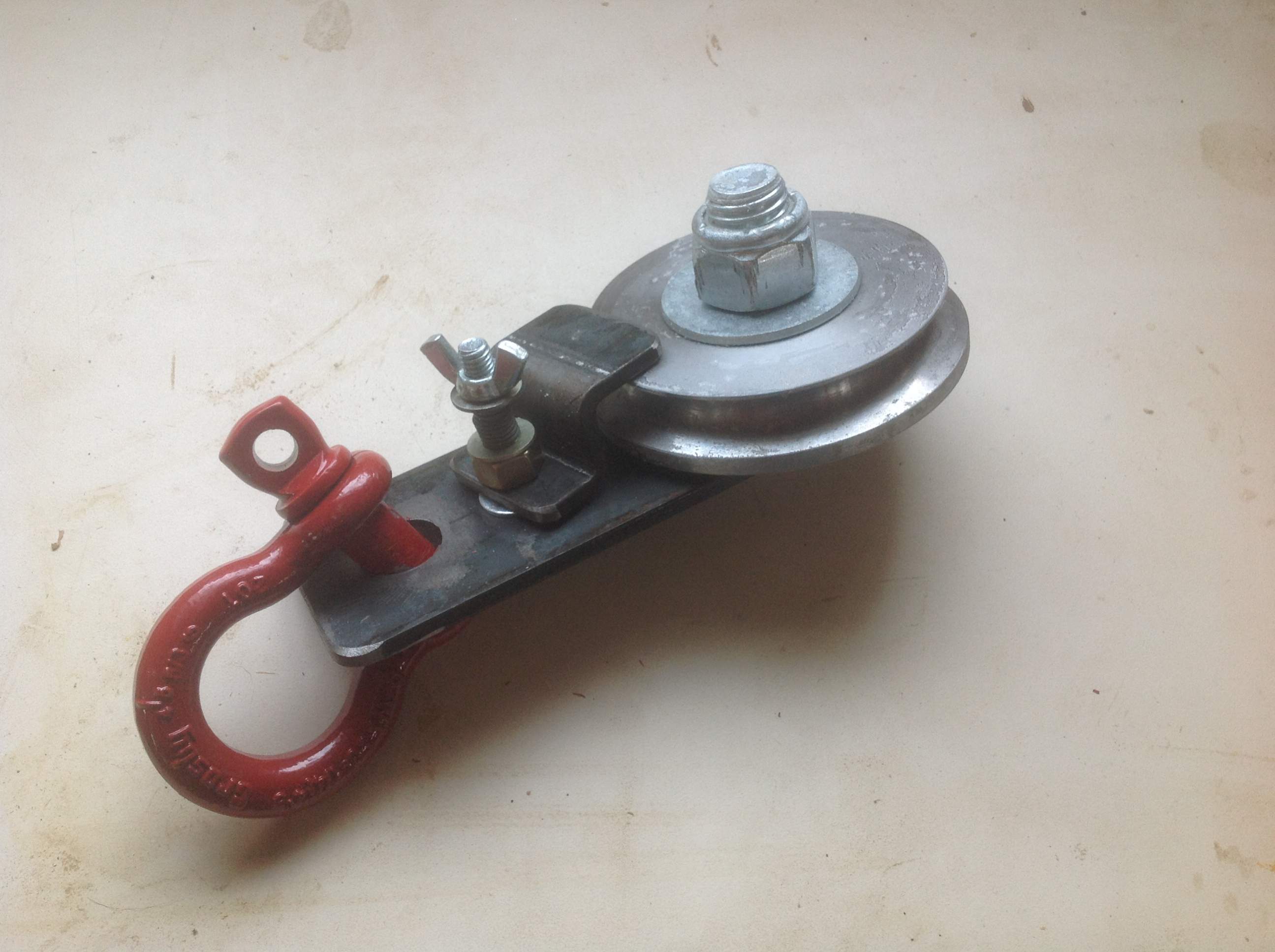

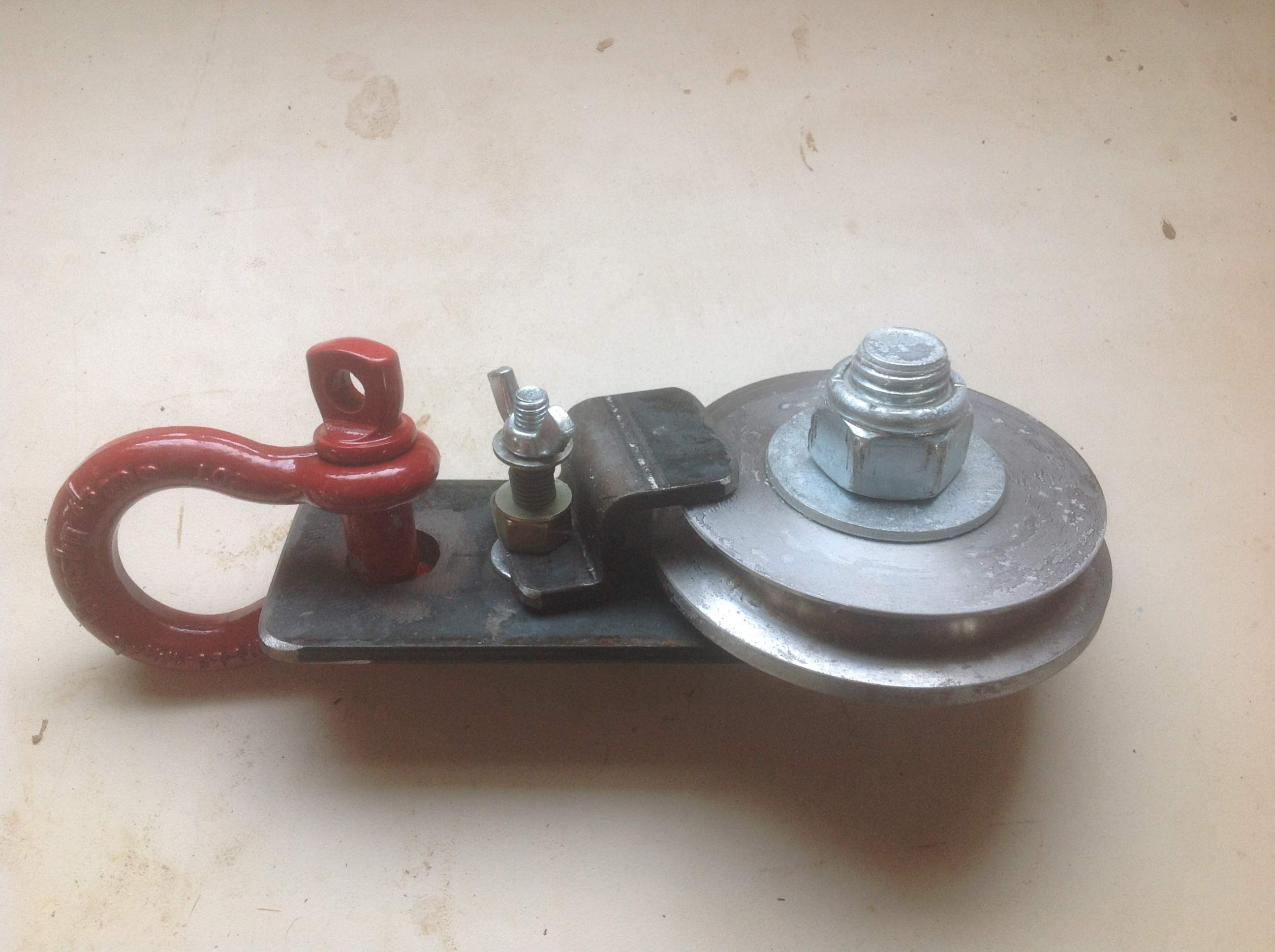

Built a self releasing snatch block. Don't know if it works yet. Hope to try it out this week. Not to sure about the cable keeper, may have to rethink that. This was about $275 cheaper than buying one. image.jpgimage.jpg
