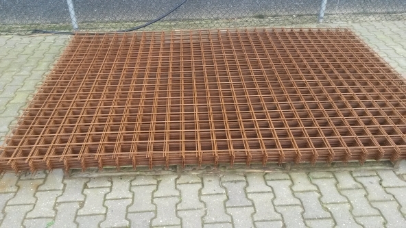

Hacks will try to use wire instead of rebar, and if they do use rebar, they try to leave it on the ground and not put it on chairs.
About wire vs rebar, i see guys on youtube throw some rebar on the ground (watching Diesel Creek right now) and thats it.
Here in Holland, individual rebar is only used in highly loaded high rise constructions. For floors or slabs the default rebar is nets, 5, 6 or 8mm rebar press welded into 4x4" or 6x6" mesh nets. Are these nets used in North America too ?
That's what I used on my shed floor, but in my shop addition, they used 1/2" rebar at 24" O.C. each way. Personally, I don't really trust that the mesh won't rust away over time, but in my shed small slabs, etc., I just don't worry about it. I know that, theoretically, the concrete prevents air from getting to the rebar/mesh and therefore should help prevent rust, but it doesn't always do that.
They are. It's called "re-mesh" here and it's commonly used for floors and slabs of 3-6"/75-150 mm.
