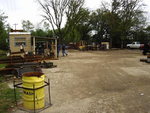

Think I posted about a sled trailer. Well the old one is sold (gone) and the new one has begun. It's a 14' sled type, 20.5x8.10" wheels/tires rated at C (1150# each). The axles are 3500 leafs but my max gross is 4600#. When the tires wear out maybe I'll move to D tires. I think they are 1500# each. The deck with is 90". Wide enough to load my ATV's side by side, and easier to slide sideways than a 6'6" trailer. All frame members are 5" channel (6.71# foot). So fas it's all scrap metal at $.25 a pound. Much cheaper than new. I know I will have to buy some more new unless the scrap yerd gets in some decent 2x2 angle. I need this to complete the side rails and other fun stuff.
It all started here at the yard, SSS Steel in Houston, Jenson location....

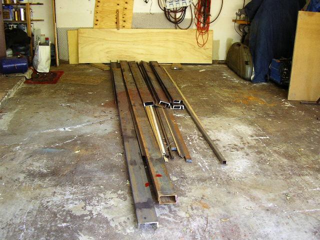

I borrowed my BIL 16' tandem and brought home the steel. 7 x 20' sections of the channel. Also bought 3 20' pieces if 1/4" 2x2 angle. I wish I would have picked up double of that. A little rough but a twisted wire brush cleaned it up. The channel looked new, almost no rust.
I used a Milwaukee 14" chop saw to cut it up and pile it under my wifes Suburban.

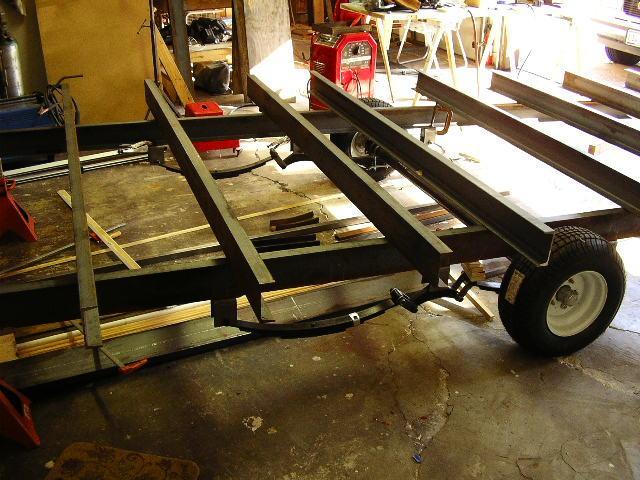

Next pic is after some work on Saturday. I got the second axle and tires and we located the axle. Went with the standard 60/40 with the split at the equalizer. Boy getting the axles was a bit of a chore, longer than I thought. The springs want to flop down, hard to keep the W in position. My son suggested just sticking to a measurement once we get 1 in place and go from there. That worked perfect (he's smart and glad he'll be supporting me one day!!). I tacked up a couple more of the cross members and took it for a test spin. My wife drove while we were in the back. It did real nice. The axles are perfect except one was out 1/32". Good enough!. You can see how I spaced the beams, tightened them up near the axle. The front are on 2' centers, the back a little closer.

The axles and the W. On the bumps and stuff the equalizer works well.

Nice, I looked at the first attachment before I read it and said to myself "that looks like the Triple S surplus yard", and it was. I've spent many a hour there.
   / Sled Trailer Build...
#16
Yep they are starting to reconize me there. I just wander around the surplus yard at lunch sometimes. Of course the real action is at the check out counter...:)
But I try and stay away from Saturday morning. On a nice day that can be a rat race with all the people there. Get there about 8 and it's not to bad.
