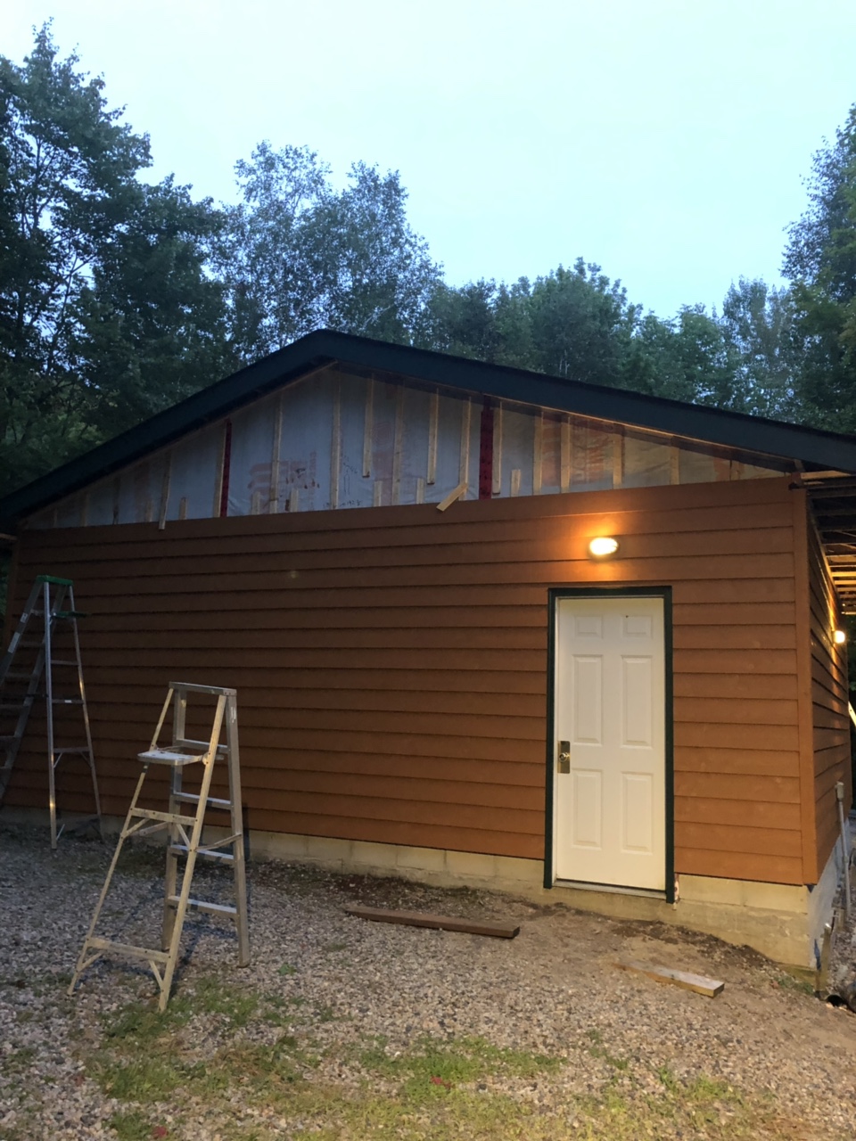

Have a friend helping me with the (7”) garage siding. He has a Rigid 12” compound slider. Problem is, we have to cut angles for the 4/12 itch roof, and his saw cuts too short.
He wants to use a jigsaw. Another problem is that the siding is bevelled. Have to think about this.
   / Sliding miter saw #25
For that kind of situation I set up a plywood jig with a steel straight edge and use a circular saw. One set up will do all the cuts for both gables if the siding is flat. If it is beveled you need two setups.
No jig saw!

Long angles like that I would never lay it on a slide saw . Lay out angle cut with circular saw Take your time It's a skill builder any wood butcher can cut a 90 degree cross cut skills come in when you have to cut angles and notches .:drink:
