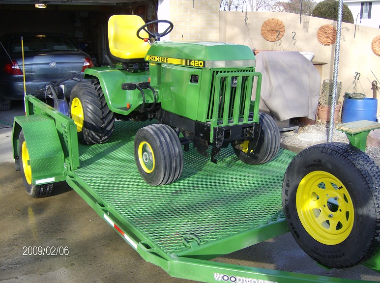

I needed tubes for the V61 tires anyway, so I cleaned & epoxied the bad spots & repainted. ~~ grnspot110

Thats a sweet looking tractor. I think I'd have to trailer it around town to show it off!:D
