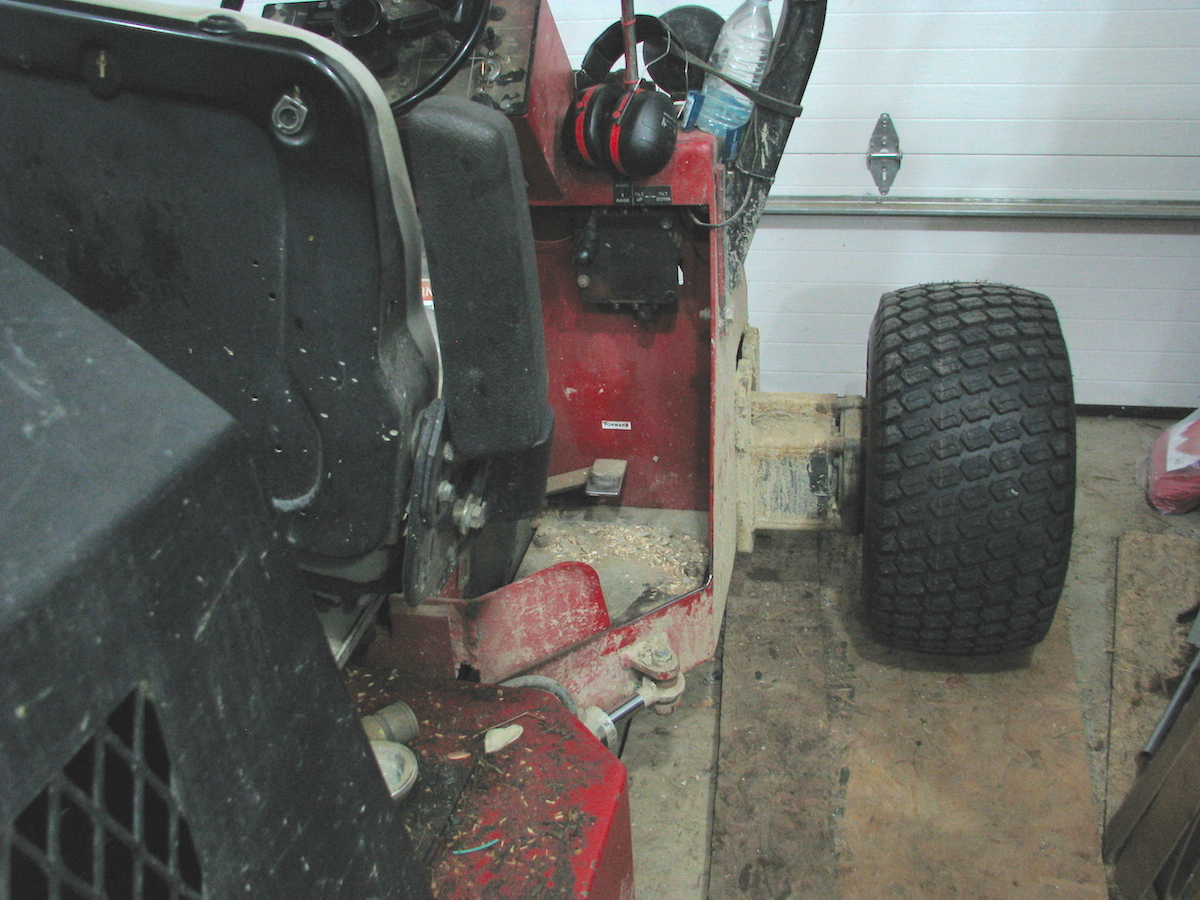

Have any of you that have slope mowers converted from dual wheels to single wheels? If so what was your reason for doing it? And also what tire tread did you get? I am thinking of converting my 1845 dual wheels to single because if you run duals in snow you end up with snow build up between the tires and the same with mud. On one occasion it broke the valve stem off. What are the negatives of running singles besides losing some slope capabilities.

I have run my 1850 with only singles for a few years now. But they are on different wheels mounted with adapters that make the stance wider. It helps with installing chains etc too. The only time I would put the duals back on is if the ground was very soft or if snow plowing around very deep ditches. I have been on 30° slopes no problem. I looked and my site went down today so I am in the middle of a restore.

I talked to Terry and he said I would need new wider rims and for tires he said 26 x 12 -12 . Ken what size spacers did you use?

They are not spacers but adapter plates to allow a non-PT wheel to be used. I had purchased some inexpensive tires mounted on wheels after being told about them here. Here are pictures of the adapters installed on the wheels and how much offset is provided by the new wheels.
Ken

Didn't your 1850 have 26 x 12 - 12 tires from the factory if so why did you go with 24 x 12 - 12 tires? I bought a set of Kubota tractor tires and rims but they will not work, the bolt pattern is right but the hub is in the center of the wheel and the tire goes up against the frame and brake.

Sorry, whatever size is factory is what I have which now that you mention it, I believe is 26 x 12 - 12. My website is down so I was going by memory.
That would be a pretty easy spacer to make. Harder would be to cut off the hub and reweld with an offset.

I generally run singles on the 1850, definitely increases ground pressure and sinks a bit more on soft ground. But I rarely need the duals so I don't run them.
