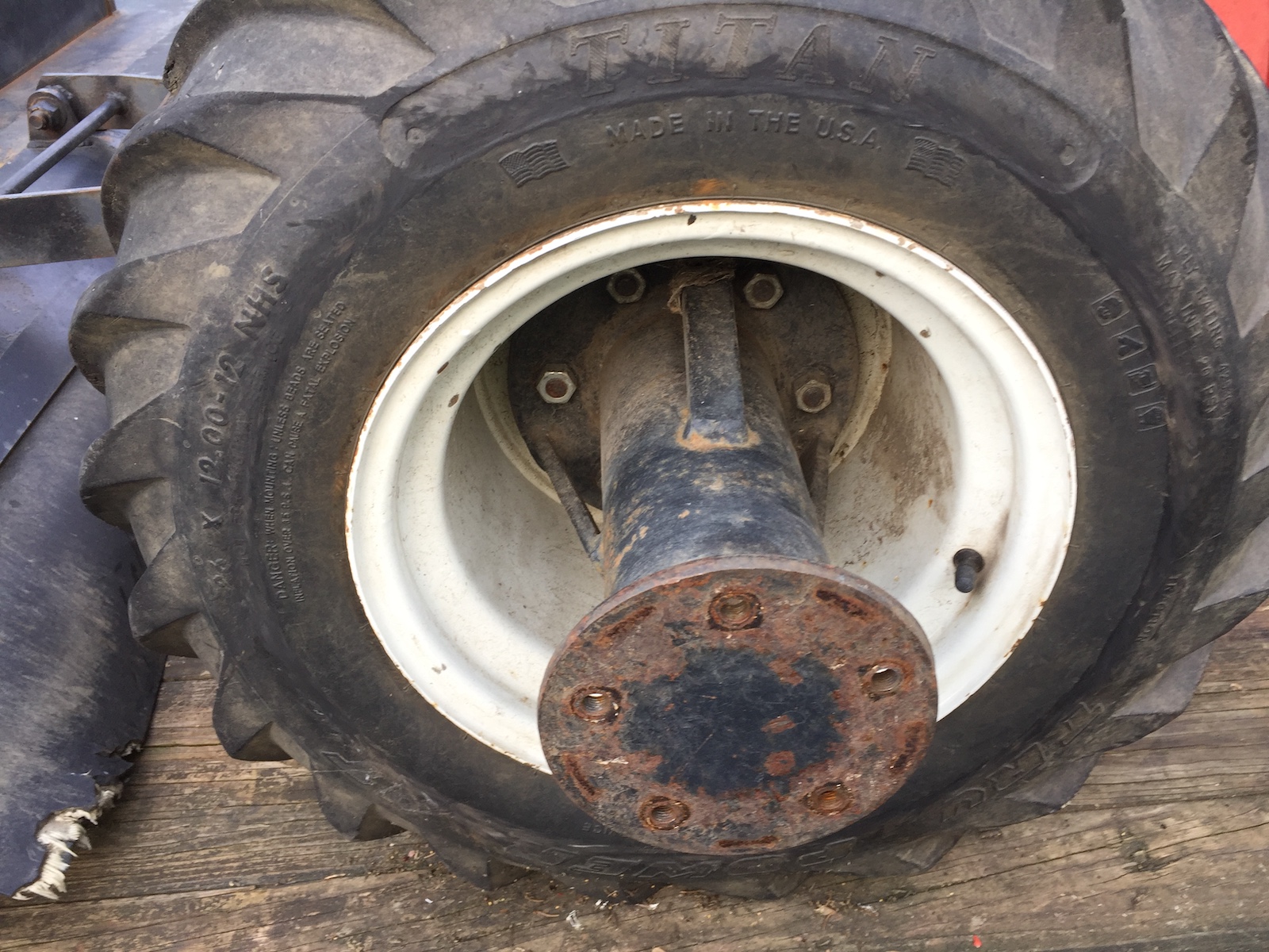

Mine has long studs. They go through the inner wheel with lug nuts, through the spacer ring, through the outer wheel with another set of lug nuts all on the same stud.
   / Slope mower tires and wheels #15
They have had several different ways of mounting duals. Instead of long bolts and a spacer ring, here is how it was done on the older PT1850 I bought:
Ken
#16
Looks almost the same as my 1845

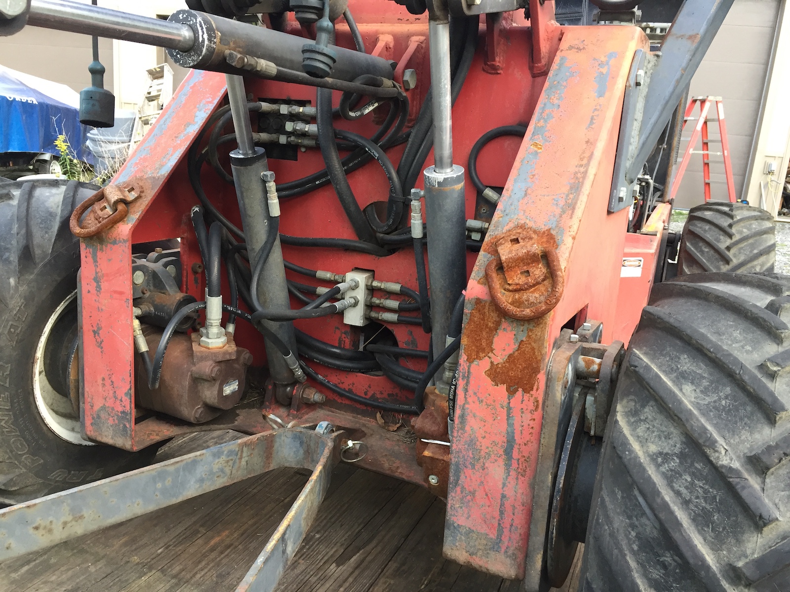

So are your wheel motors mounted inside your frame?
I'll snap some pics when I'm out there tomorrow just to add to the brain trust
   / Slope mower tires and wheels #18
The older PT1850 with the hub extensions has the motors inside the frame, mine has them outside.
Ken
   / Slope mower tires and wheels #19
Here are pictures comparing the two different ways they did the wheel motors on mine (older machine then newer):
Ken
