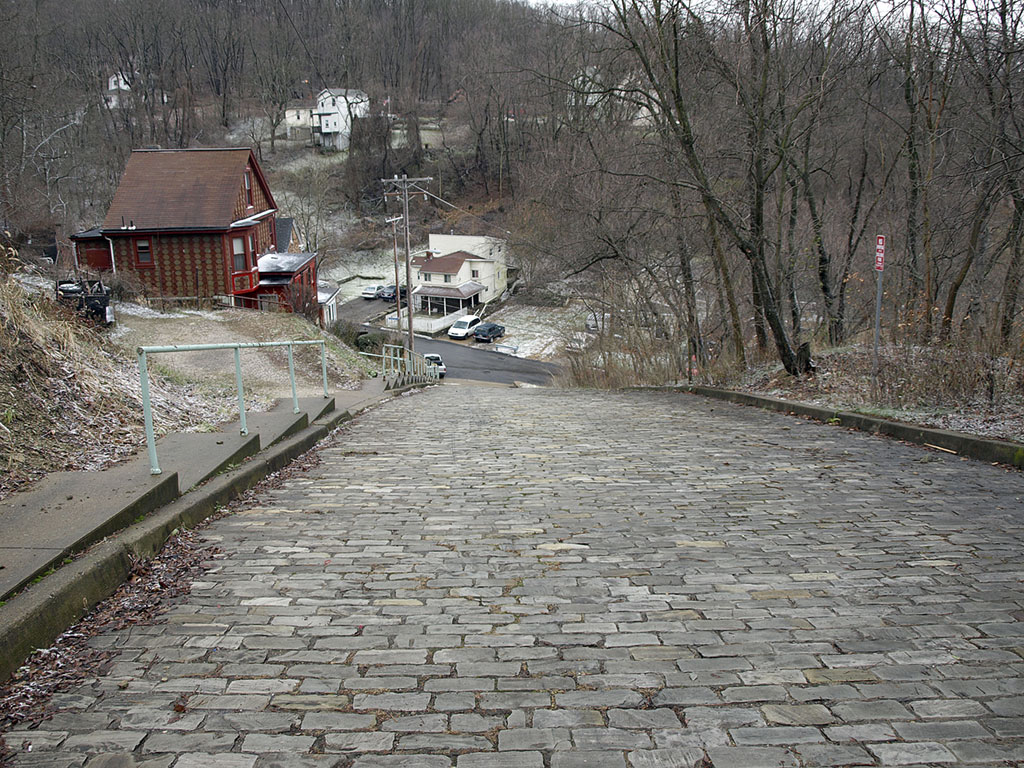

This is Canton Ave. in Pittsburgh. It's one of the steepest roads in the world. I've driven it a couple times in our car. It gives me the creeps. It's listed as a 37% grade which is about 20 degrees. Now considering a Power Trac slope mower is rated at 45 degrees.... YIKES!!! :laughing:
