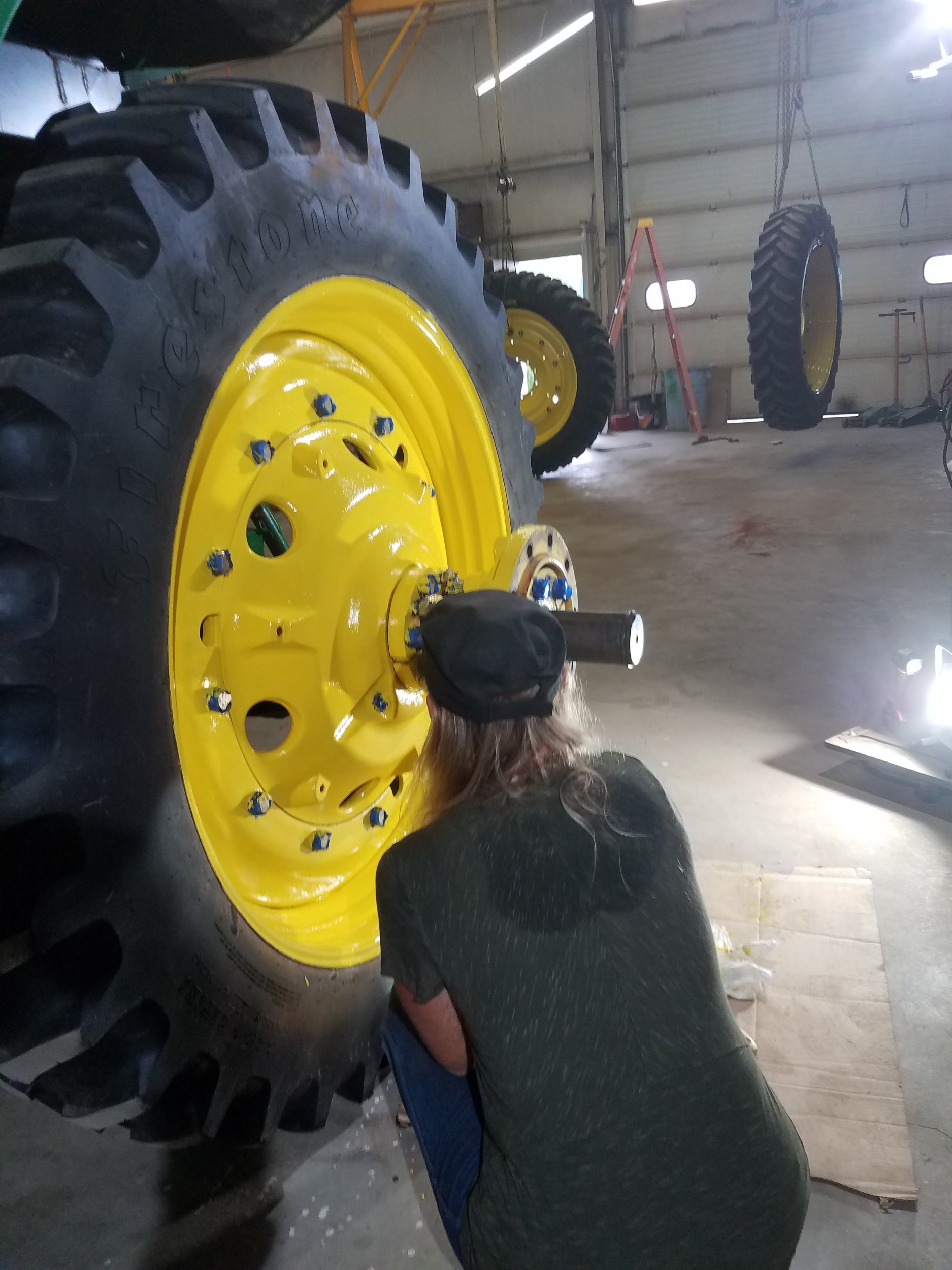

I had some big ones on a fert spreader. They were always low and so big they were anoying to fill. I put a gallon of slime in each one and havnt added air in 20+ years. You can work on rears on the unit but for me its so easy to take them off and I can wash/paint if I want.

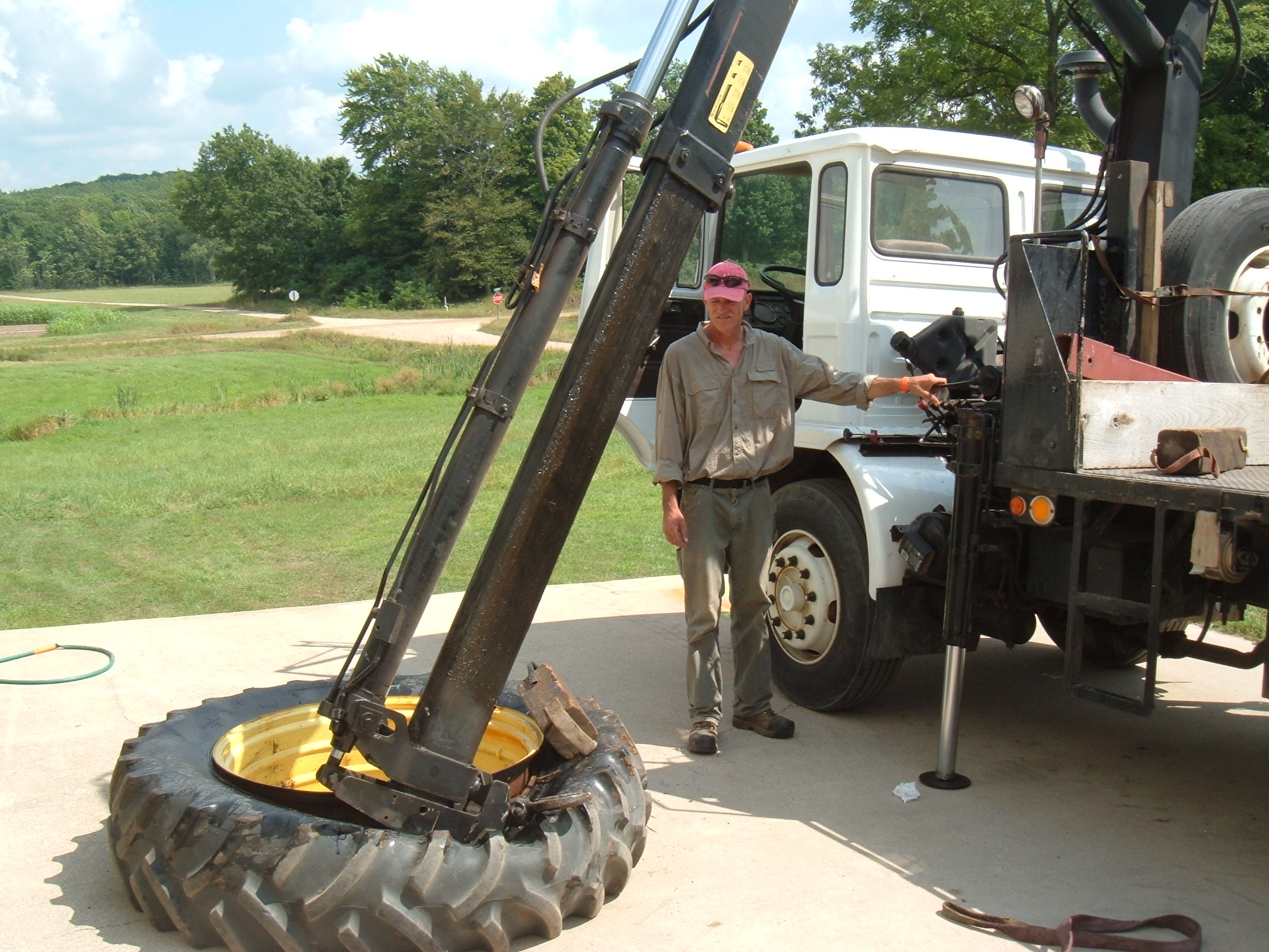

I usually take them off outside for work and use crane on truck vs indoor especially if they are loaded. I just replaced a front on another tractor and not loaded and do not put tubes.
My neighbor has a fit and insists on tubes in everything and always have flats, the cost of the tubes on little ones, damaging them, would be cheaper to simply replace.
