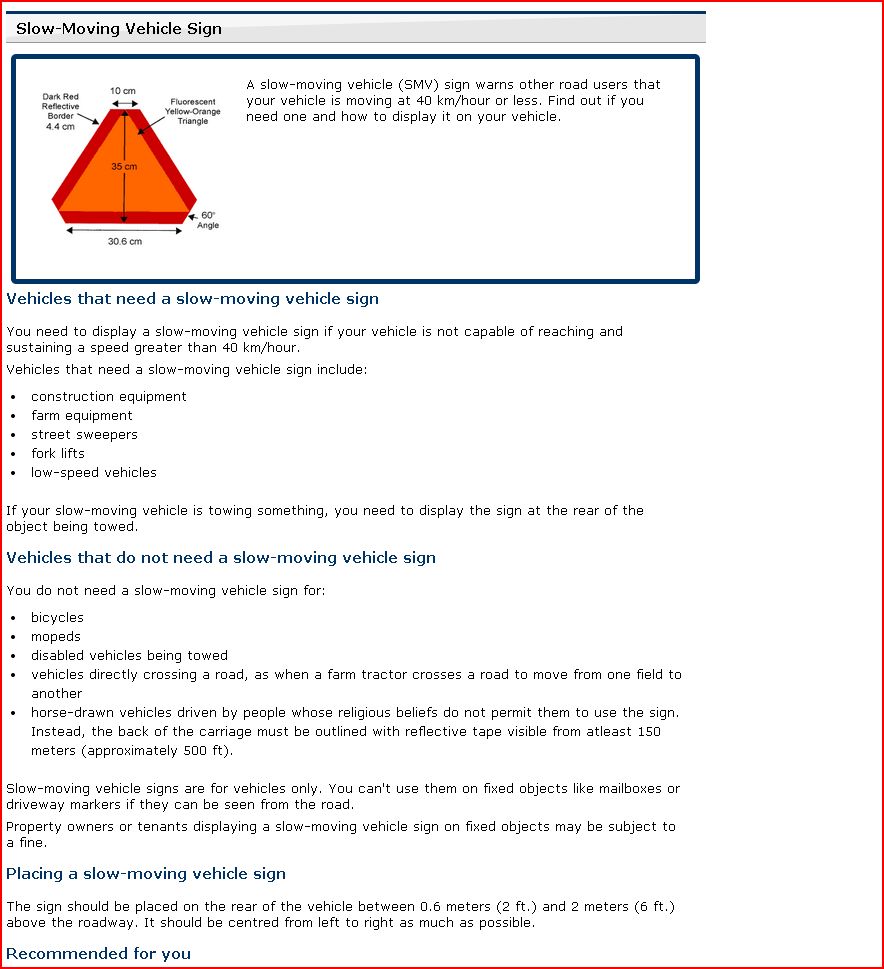

I Googled it. Here is a link to the Ontario law:
Slow-Moving Vehicle Sign
The search also brought up a Wikipedia entry:
Slow moving vehicle - Wikipedia, the free encyclopedia
I only post this for information and not to express an opinion on this thread.

Still waiting for somebody to post up the actual law and not supposition.
NY law:
http://codes.lp.findlaw.com/nycode/VAT/III/9/375 said:
New York State Vehicle and Traffic Law Section 375, subdivision 36, paragraph (c):
(c) The use of such emblem shall be in addition to any lighting devices, flags or other equipment required by law. Such emblem shall be used only on farm machinery and implements of husbandry on road construction and maintenance machinery, and on such other vehicles, machinery and equipment as may be specified in regulations issued by the commissioner. All use shall be in accordance with such regulations. Use of such emblem as a clearance marker or on stationary objects on the highways is prohibited.

Rock knocker, FWIW, here's the code section in Virginia: https://vacode.org/46.2-1081/ See para. D.
I took a quick look for Washington State and didn't pop out a corresponding code section, but there might be one. It's still a state-specific limitation at this point, as far as I can tell.
