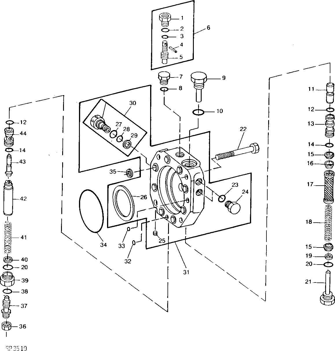

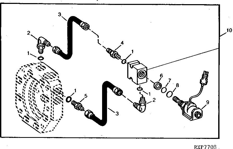

The "tee handle" that jd110 referred to is the manual destroking screw(parts key #6). Hyd pressure trying to build up while attempting to crank engine can cause slow starter rpm's. If battery ground cable hasn't been relocated from battery box to engine block I'd suggest to do so. JD also offered an electric operated destroking valve. RE40463 elect destroking kit ADD 603.89 USD

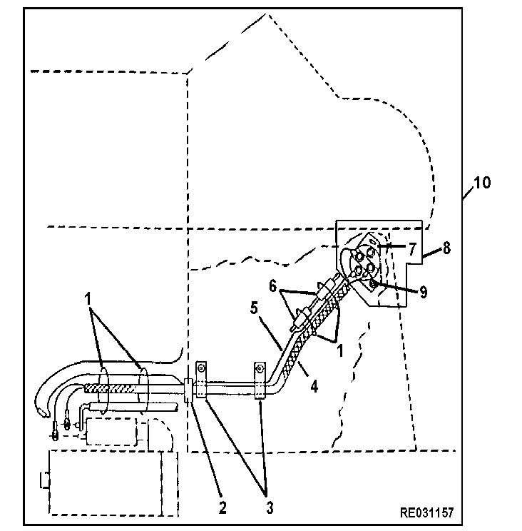

Yrs back JD introduced a starter relay kit to help alleviate the intermittent starter engagement that you referred to. The kit provides starter solenoid activation wire with more volts when engaging starter.
