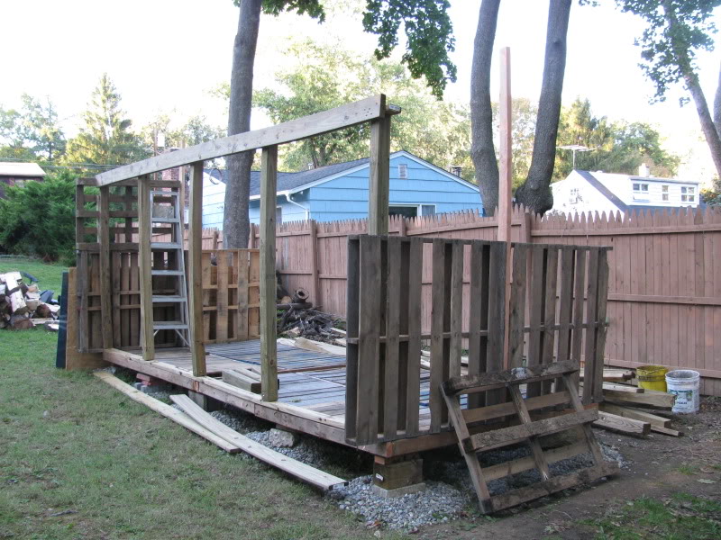

Any photos of your pallet shed? I am thinking of throwing one together for wood storage.

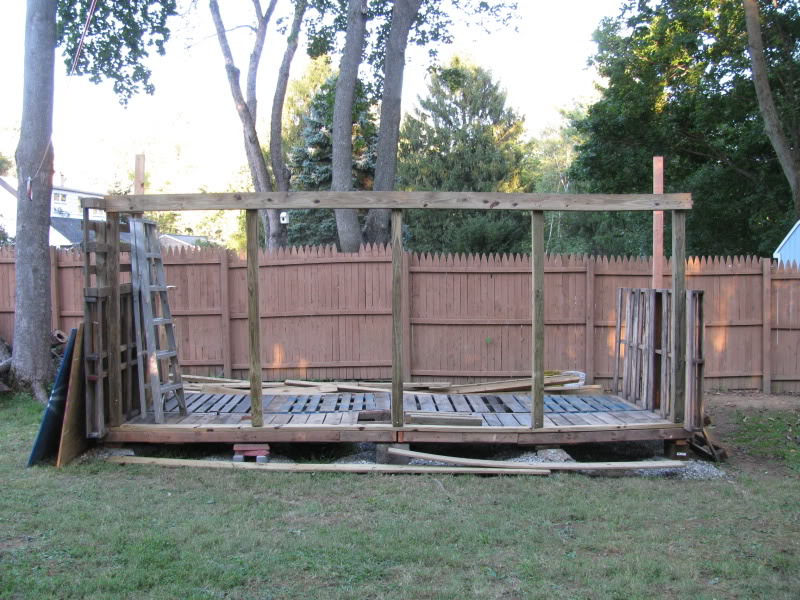

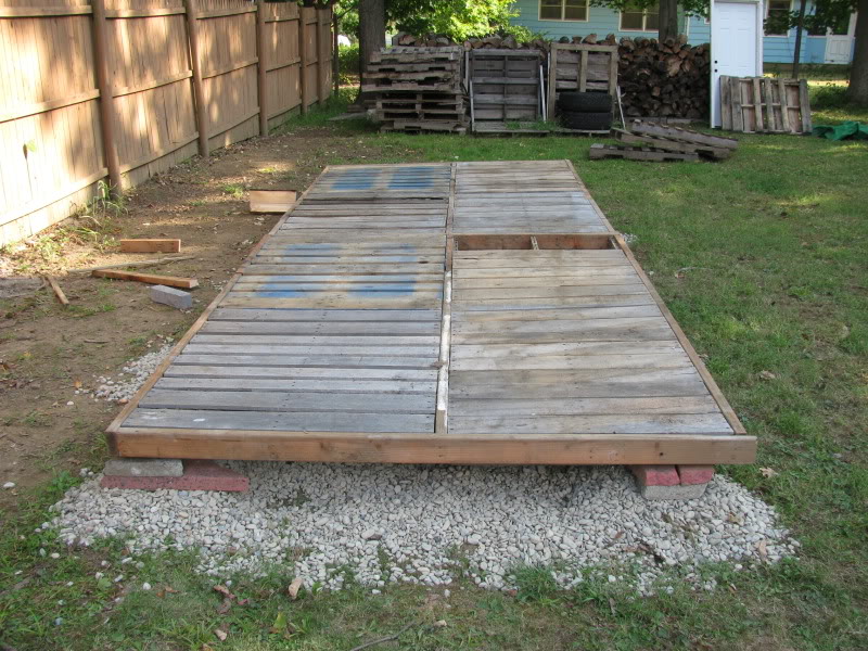

Built entirely from pallets and $30 worth of lumber from the junk pile at Lowes... It was about 16' x 8' and held about 5 cords of wood, but as I said, it's kind of falling apart, but it served it's purpose for five years. It's time for something that will last.

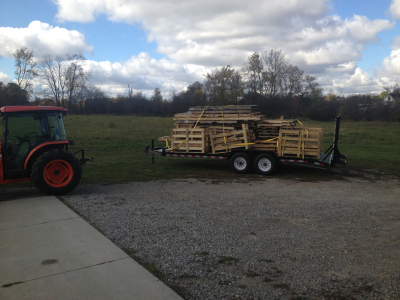

This is freakin sweet!!!! I happen to just get a shipment of pallets
from a buddy and am looking for ideas.... This looks like the Taj Mahal !!!!
