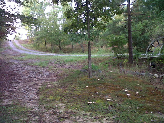

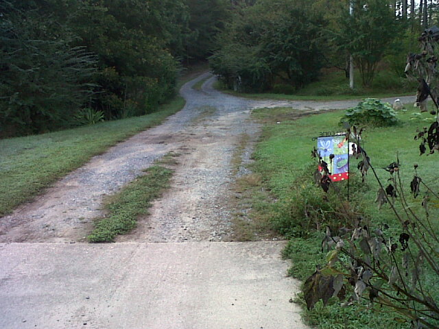

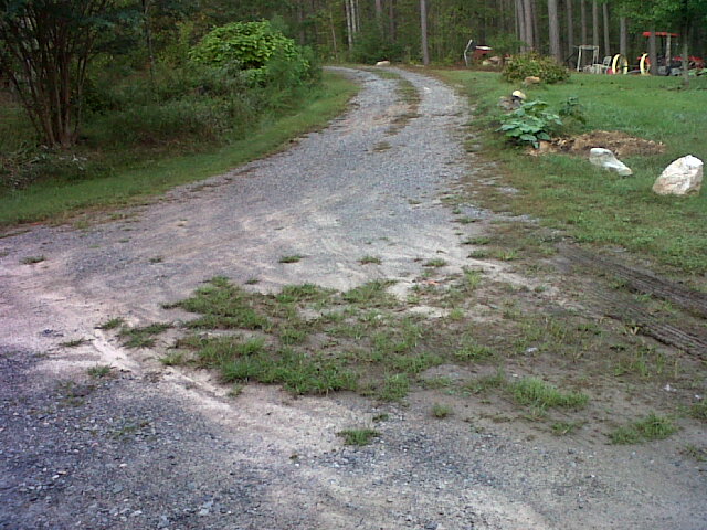

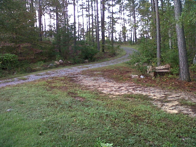

OK, First pic is from the concrete in front of carport looking towards steep side. Second is looking up the hill on the steep side. Third should be the "Y" at the bottom of the loop by the concrete. Last pic is an attempt to get the less steep side from bottom to top (barely visible in the trees).
I may have misunderestimated the angles, but they are flipping STEEP! :shocked:
