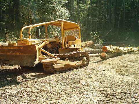

I agree. What used to be a few years ago but has turned into many; the owner of our logging crew thought that a D6 (old style) would be a great addition to the 3 skidders he already had. We tried this thing in the winter. It lasted two weeks before he gave up on the rental. The dozer was absolutely scary on hard packed snow and ice when on even the slightest slope. One guy who drove it for a day, got it high centered on stumps 3 times thinking he was still on a skidder. Plus it was "slow" and really couldn't take more of a bite of stems than our largest skidder. It was perfect for cutting trails but most folks who owned the land we harvested on, didn't want anything more of a trail that a skidder would make.
It took a short time to learn a dozer wasn't for us. That being said, I'd still love having a small dozer.....and a mini x...and a dump truck. Basically, everything I fell asleep with that was in the crib when I was 3 only a bit bigger
