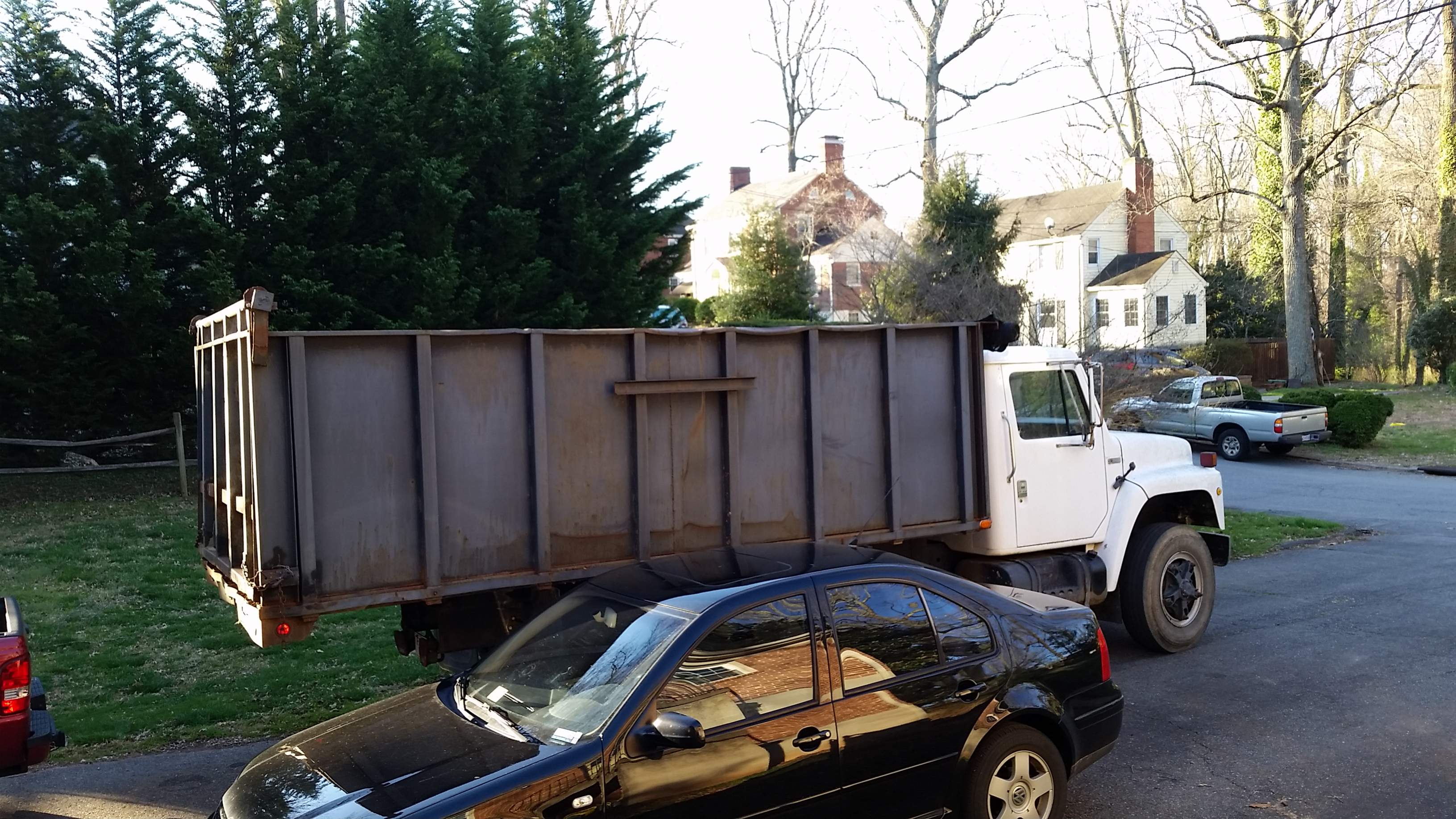

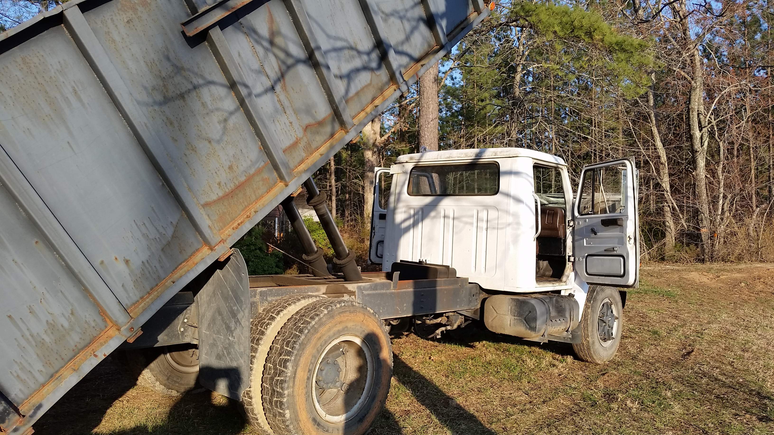

Here's my $5K 16ft dump trailer I just got :)
... It's convertable too!
