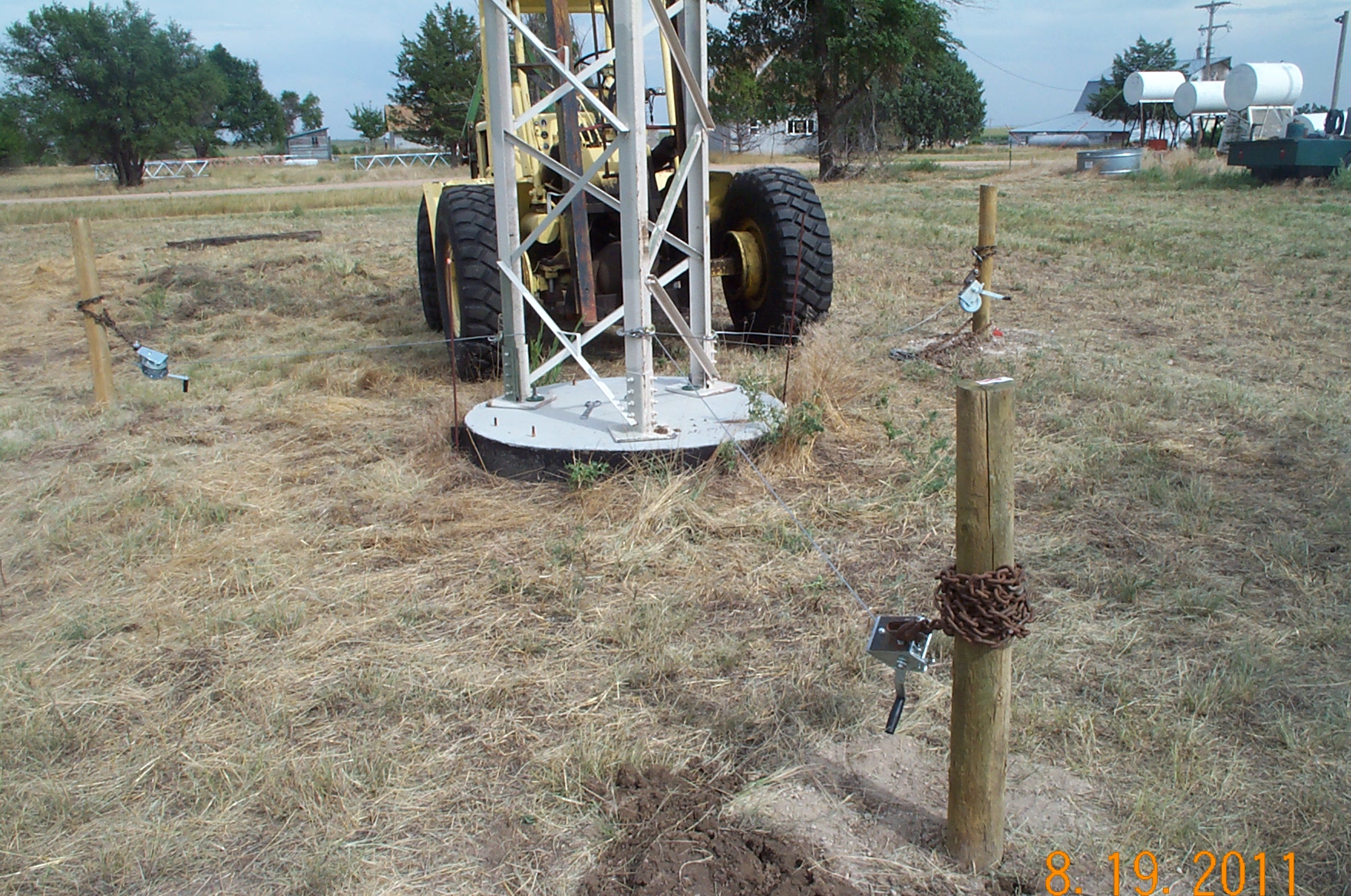

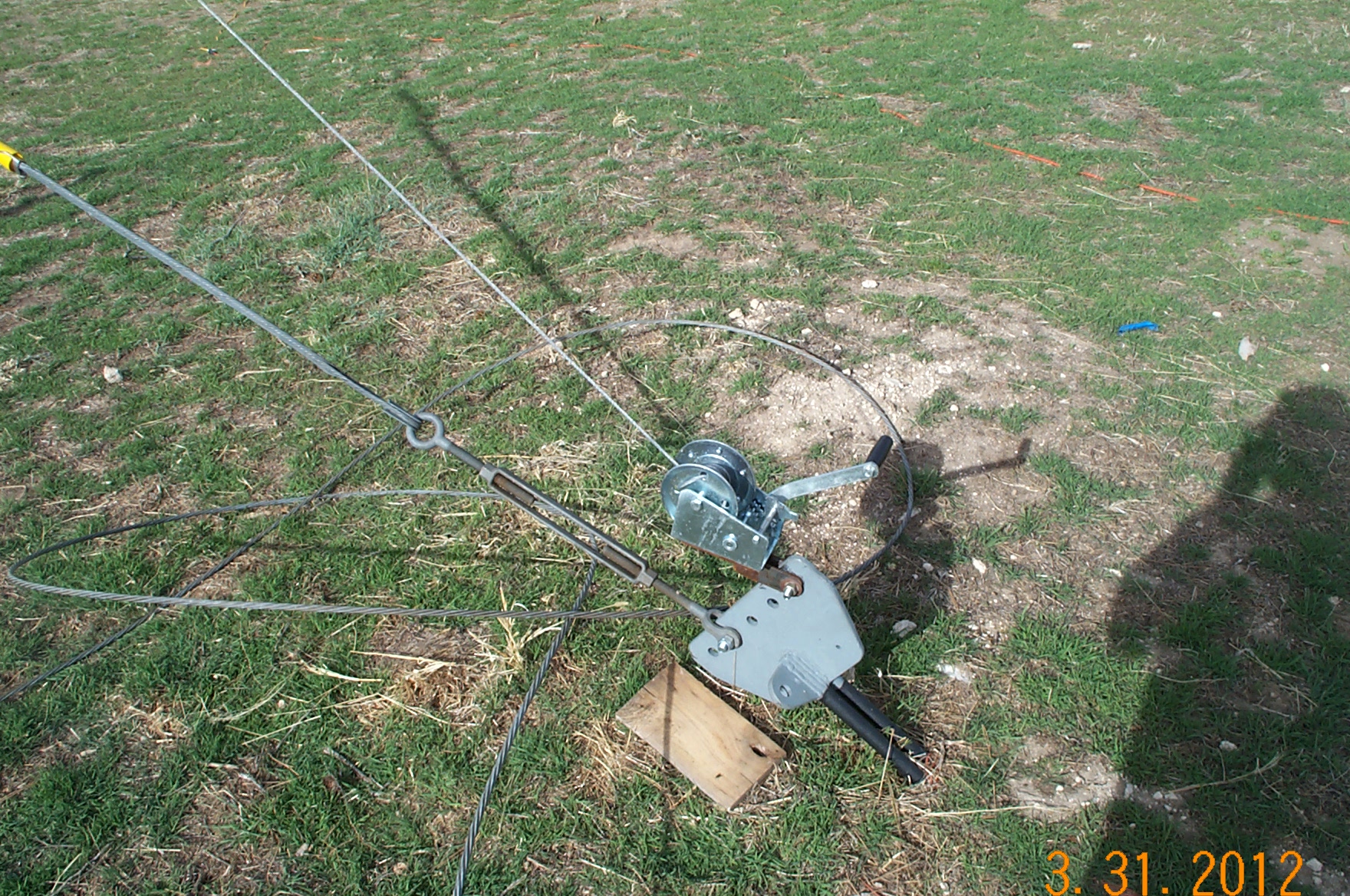

how did you do it with the come a long? I would think one could do some thing similar. A plate with a couple of short chains on it, or a hook to fit over the roll cage, bar. I know the pictures are of a hand winch, but I can not see why a small power unit would not work as well, this what I made to help assist me when I set up a tower once,
added one more picture, when I was typing earlier could not fine one like it, of the small power winch mount.

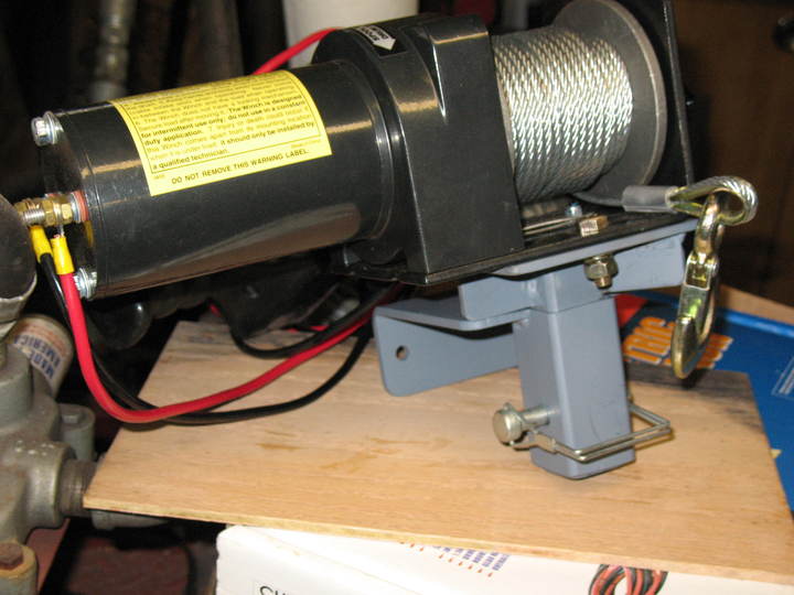

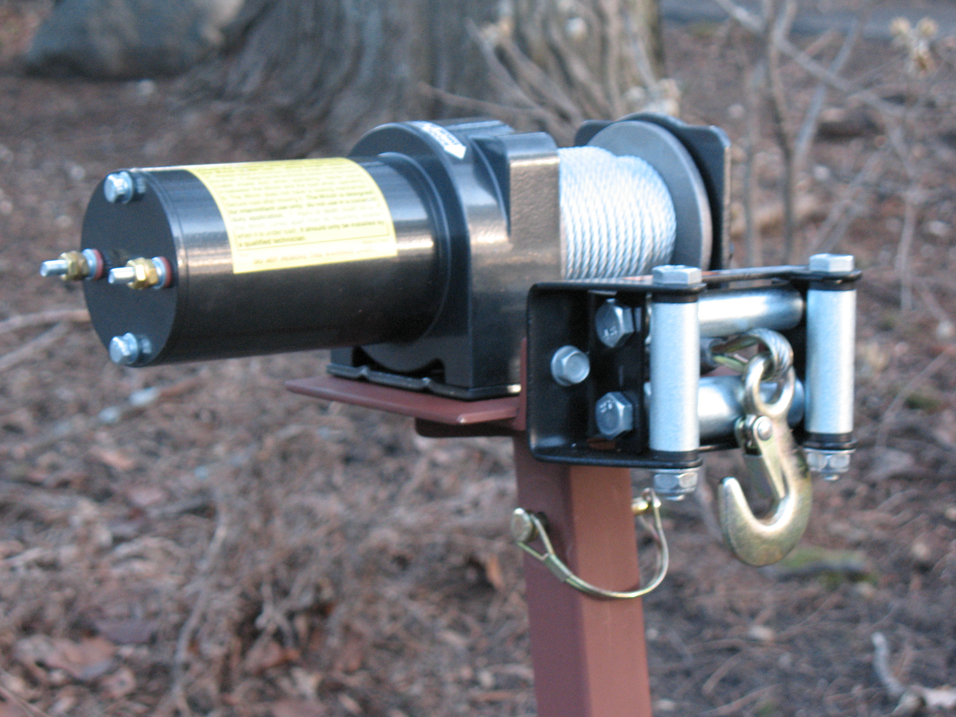

/ Small electric winch mount setup. #11
I use a small receiver mount. 1 1/4" tube for winch base and 1 1/2" -1/8" wall tube for the receiver.
The first pic is of a trailer tounge mount.
The second pic is a mount for the front of another trailer.
Last pic is the winch on a log splitter lift.
