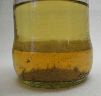

Papasmirf is right on about the ethanol. It's crap. The only reason it isn't a problem with cars is that it doesn't spend much time in your car--you run it thru & get fresh. Here you can see what a friend got out of his motorcycle tank after it sat all winter.

I have two neighbors with fairly new cars. They started using gas with 10% ethanol and both were unaware of the potential problems until their cars started breaking down. Both had several large repair bills.
