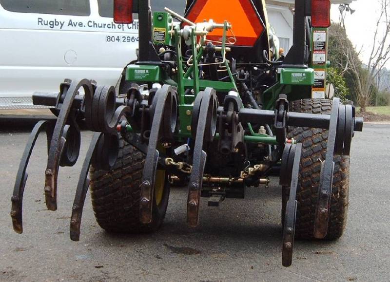

Attached is an old JD M soil ripper with 7 shanks, converted to 3ph for my 4010. The 4010 pulls it full depth.
Ralph

Deere755 my cultivator is like the one in the Leinbach photo posted by ChuckinNH. It is similar in size and weight to the model CA7 in the Leinbach information. Hope this helps,
