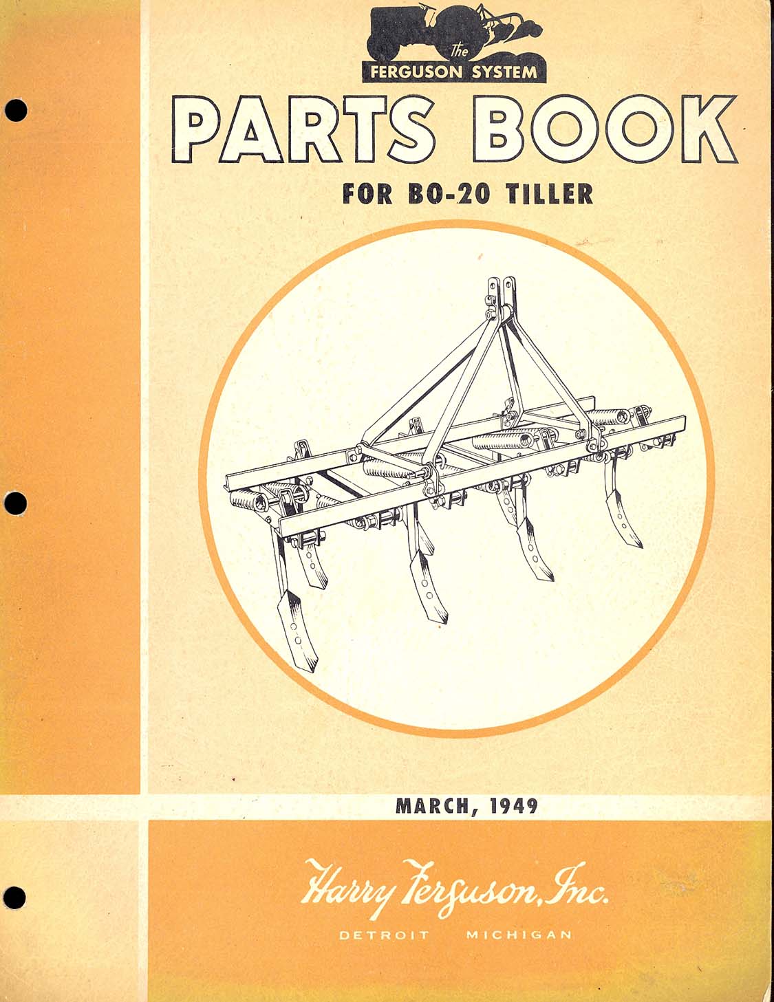

1. I see tool bars with a single bar and tool bars with multiple horizontal bars. But I am a little confused and have really basic questions. Other than the number of items you could mount on one, is there some benefits to having multiple rows of bars?
The greater length of a multiple tool bar implement, the smoother and leveler the output behind the implement will be after one pass.
2. Also on the chisel plows, I **really** see many differences on what people call a chisel plow?
Tractor and implement nomenclature is not very precise. To me, a chisel plow is a conservation plow with a heavy reset spring protecting each shank. For compact tractors other names for this implement are ALL PURPOSE PLOW and FIELD CULTIVATOR.
The English inventor (1936) of this implement, Harry Ferguson, called it a TILLER but that name is no longer used for this implement.
