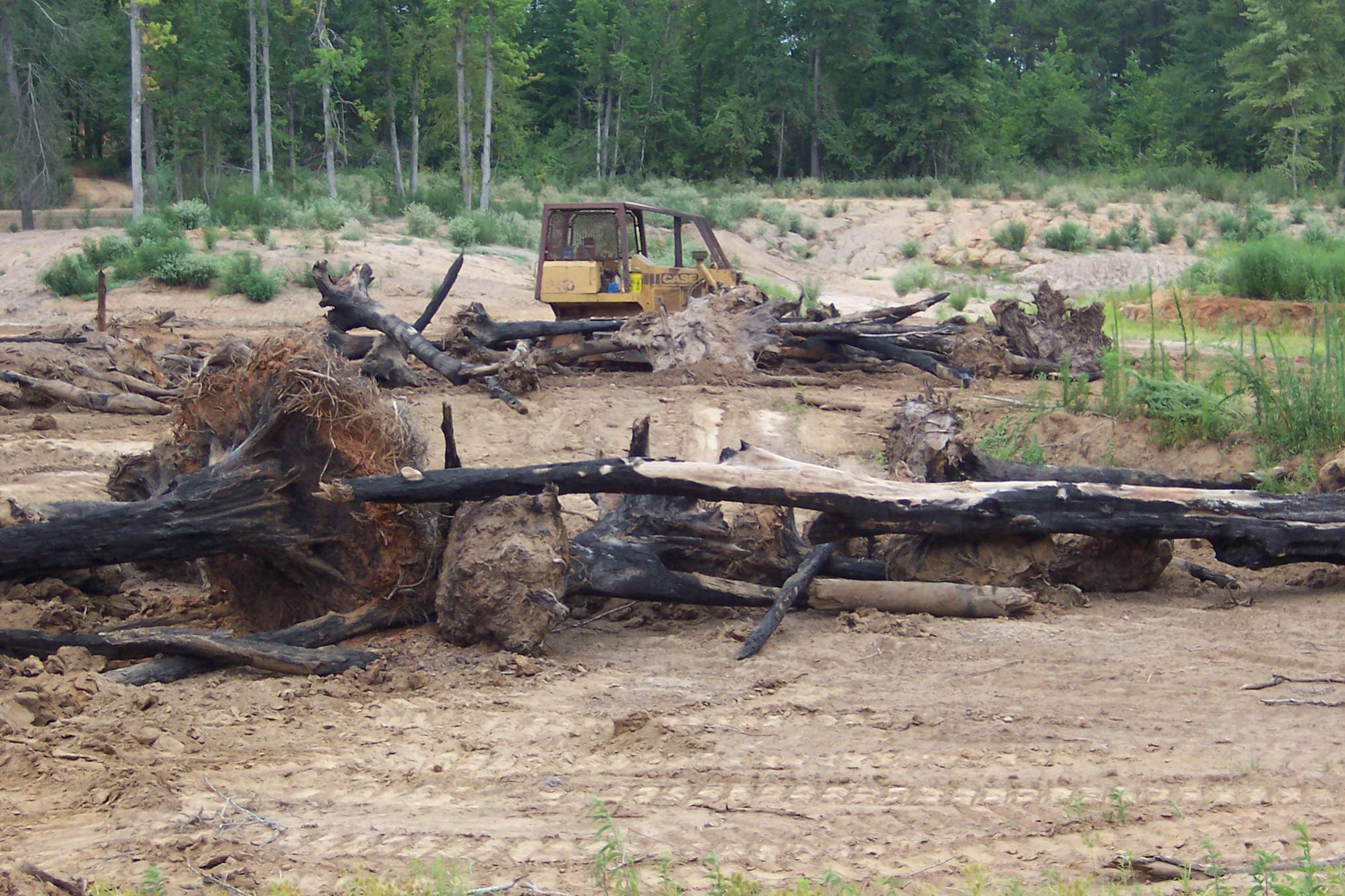

That's a real nice setting that you have there. The house looks amazing and the pond will only make it look that much nicer!!!!
I wouldn't worry about those stumps too much if they are going to be in the water and not part of the dam. You want to dame to be as free from anything organic as possible. No top soil in it and no roots or branches that will decay over time. From the picture, it looks like you are on the side of a hill and the water will be coming down the hill to fill the pond. How much hill is above the pond and is there any concern of too much water coming down and overwhelming your spillway?
The number one reason a dam fails is water running over it. The water erodes the dirt and it just keeps working it's way down until all the water is gone and you have a big gap in your dam. I've seen it happen about a dozen times around here and I'm sure I'll see it again. A big rain will put a lot of water in there quickly, you need to be able to get it out of there just as quickly once full.
Another concern is how tall will it be and how steep will the dirt be on the dam? You never want trees growing on your dam because their roots will tunnel through the dam and over time create a path for water to travel through the dirt in your dam. Grass that is maintained and mowed a couple times a year is a great way to protect your dam from erosion, which means it has to have a slope that you can mow. Rock, riprap and gravel are even better, but very expensive since it has to cover a lot of area and be thick enough to protect the dirt below it from erosion.

Thanks Eddie. I have two 8" pipes that will be filling the pond. The pipes carry runoff from surrounding hills. I was more concerned about not having enough water....So I guess Ill just have to wait and see. My plan is to make the back of the dam gradual enough to mow, and the emergency spillway will be packed with rip rap and will hopefully handle all the water Mother Nature throws at it. I will post photos as soon as the excavating begins. Water will be about 25' deep at the dam.

Just imagine the worse case scenario and then double it. When it rains and it's really coming down, you wont be able to do anything about it if you don't have enough rip rap on the ground to stop erosion. I saw a tractor stuck on the dam with a load of dirt in the bucket trying to get to the place in the dam where the water was running through it a few years ago. I guess the owner saw it happening and tried to get out there and stop it. I think he got lucky he wasn't closer to the opening when he got stuck!!!!

Thats a lovely spot for a dam! I think it will be much bigger than you imagined. Have to agree with Eddie about making the top of the wall wide enough to drive a dozer and the banks sloped so you can mow. Worse case scenario plan for the water to go over the top, if its wide and level the water will spread out without gouging a hole. I suggest you have the top levelled with a laser. Also consider means of draining the dam, I buried a pipe at the base of the wall. For my spillway I used old corrugated roofing sheets and covered them with rocks. Keep the pics coming.

If you will bring the dam about 3-4 feet above the emergency spillway you will allow the pond to catch the water the spillways can't handle and hold it for a few hours. If you are close to the coast you may want more as Virginia can see hurricanes.
An acre pond has a lot of water in it. You said dam was about 25feet of water. If you get an average depth of 12 feet. That is 12 acre feet of water which is almost 4 million gallons of water. Try and figure your average depth so you know your capacity.
