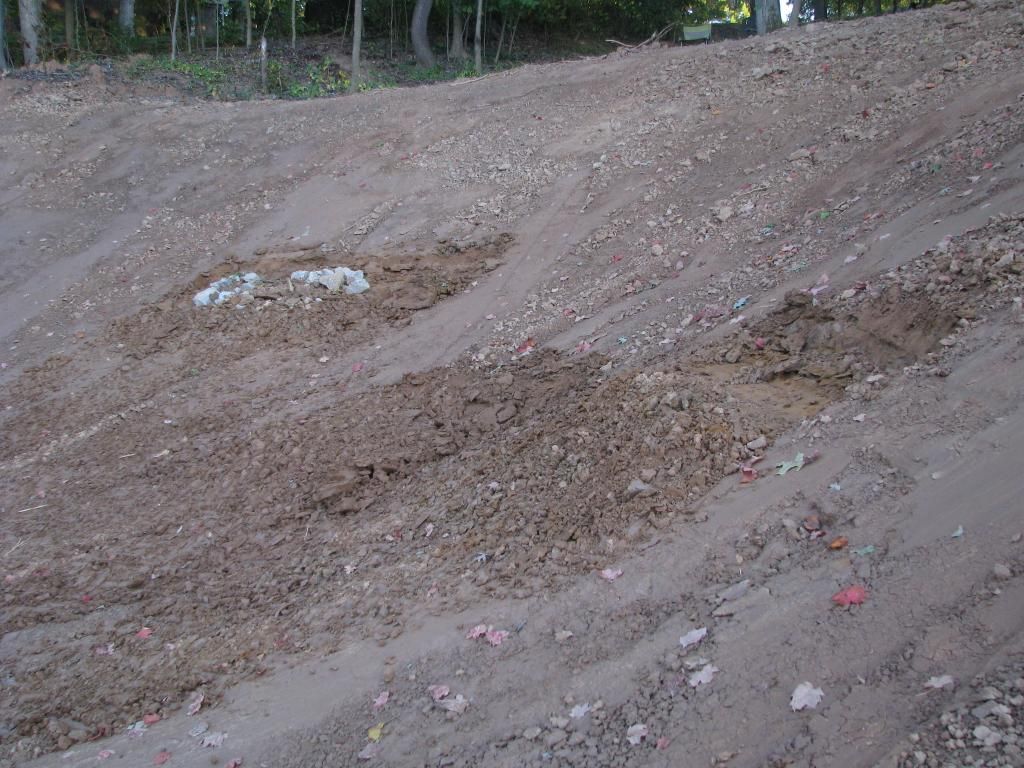

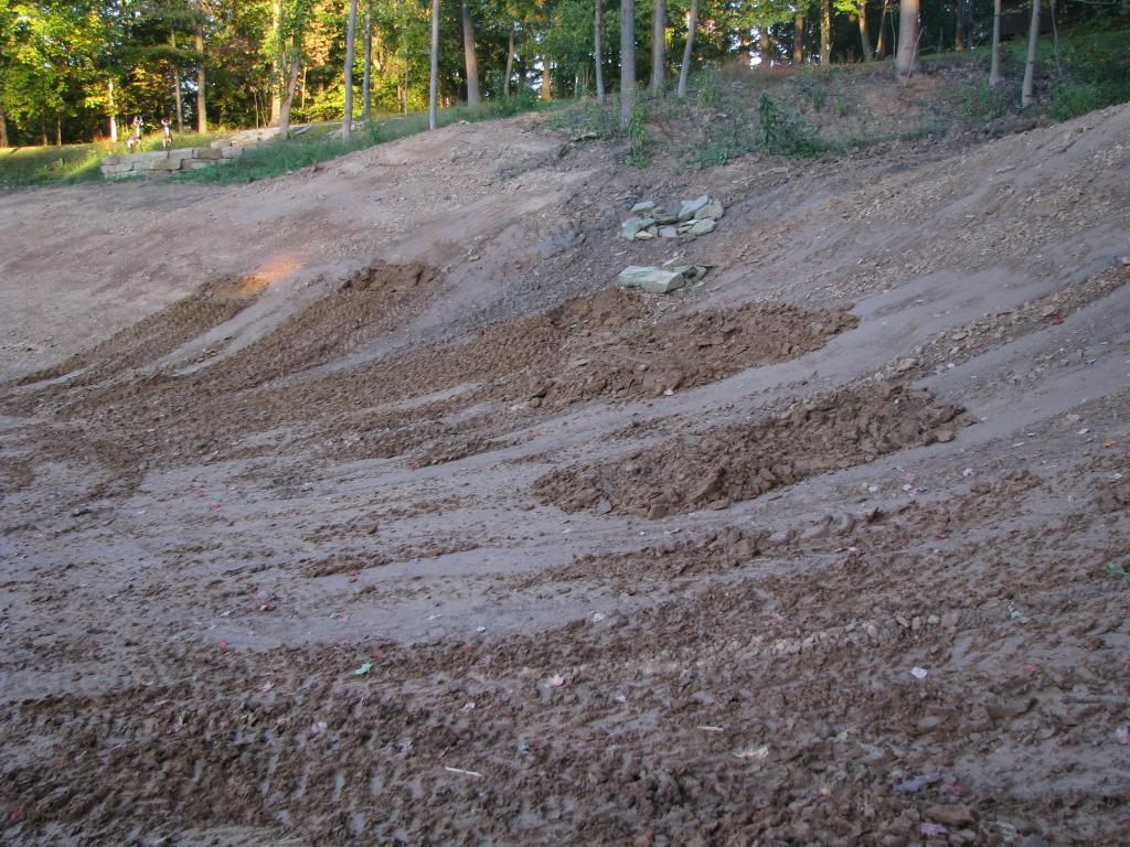

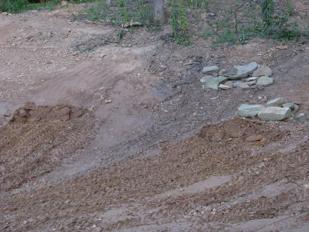

Ok, I cut a bunch of ledges and Ill do some more tomorrow. I put rock on some of them, should I do it on all of them?

It looks more like you are landscaping then creating habitat. The gravel you put down might work for spawning, but it's not enough to create any sort of a hiding place or barrier. Think of two foot drop offs and mazes that the smaller fish can swim into to escape the big fish trying to eat them. Dig a two or three foot ditch and then pile the dirt up next to it. Get some trees or stumps and pile them up into something a dozen or two dozen feet long at either end of the pond, or even in three places. Stack a dozen pallets on top of each other and put some cinder blocks on top of them.
If you plan to swim in it, leave the shore near the house pretty so nobody gets caught in it. Just remember that once it's full of water, you wont see any of this unless you have a few stumps sticking up through the surface. I did this by accident, and have found that it's great for birds and turtles to rest on.

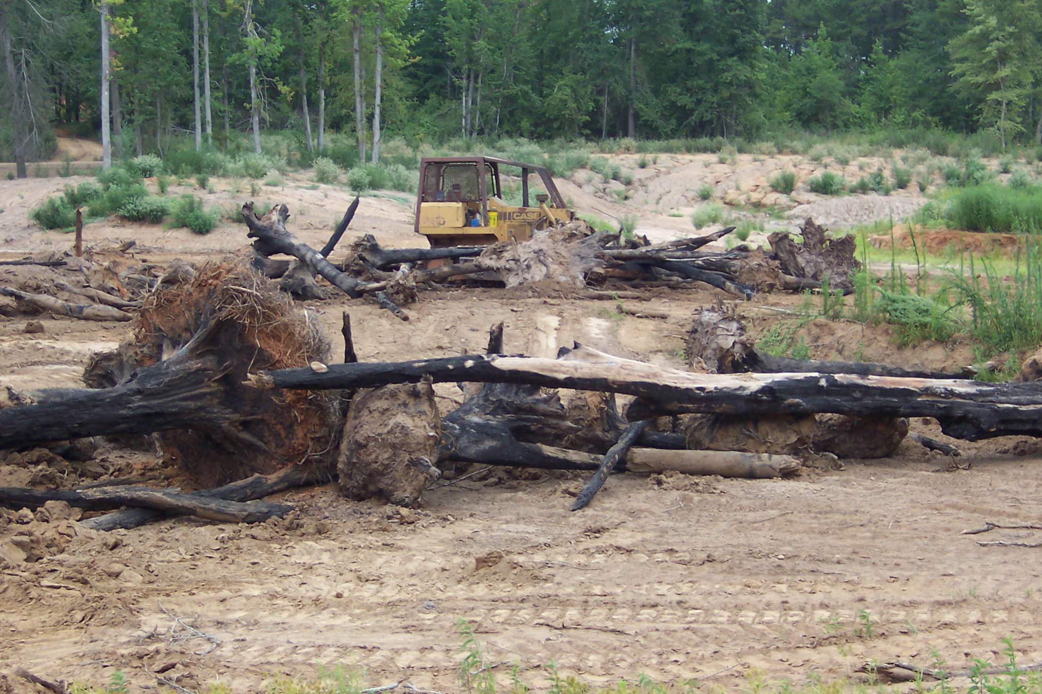

Thanks again for any and all suggestions/criticism/observations. We are in a very dry spell and will remain in one for a few more weeks, so I have time to move around in it. I have set rocks on top of everything to anchor. Would you suggest any structure on the bottom? I have a bunch of rocks. Here is the photos of the current structure.

That hollow log is nice. Lots of good hiding space in there.

Stacks of cinder blocks on their sides with the hollow sections exposed.
