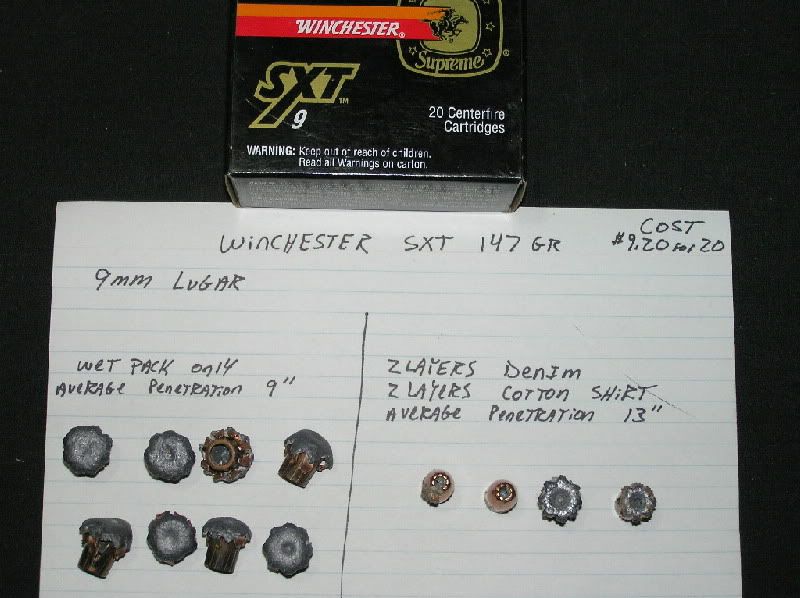

News papers taped into 12 inch stacks and then soaked in water for 24 hours. Line up 4 or 5 stacks of the saturated paper (more for more powerful loads) at the backstop and fire into them from different ranges. It's a poor mans ballistic gelatin. :) It works though. I test everything from my rimfire rounds all the way up to my 50 BMG rounds in it and it works great. It is a excellent way to see how a bullet performs (expanssion and penetration) and how different charge weight's effect it's performance. When I am testing a round as a self defense round I also lay old denim pants and shirt material across the front of the pile. This simulates penetrating clothing. You might be suprised how effectively clothing can prevent some hollow point bullets from opening up.
Edited to add: Here's a example of how clothing can effect bullet performance. Notice the rounds fired through clothing penetrate further but do not expand as well. This is one reason to test bullets yourself. Just because a bullet expands when fired into gelatin does not mean it will in real life when fired through something.
