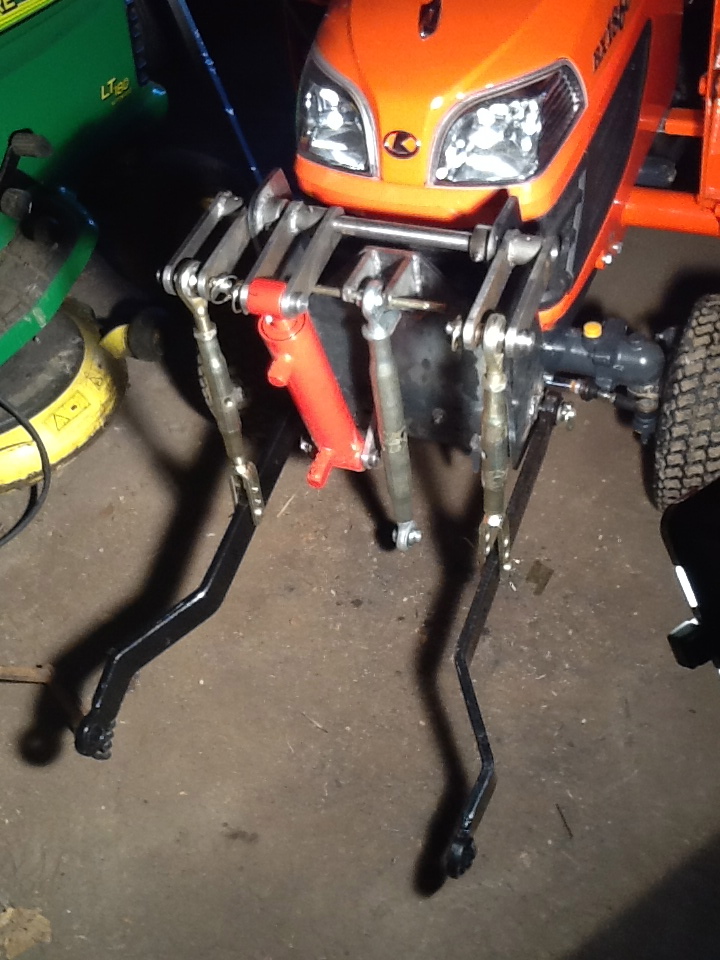

#22

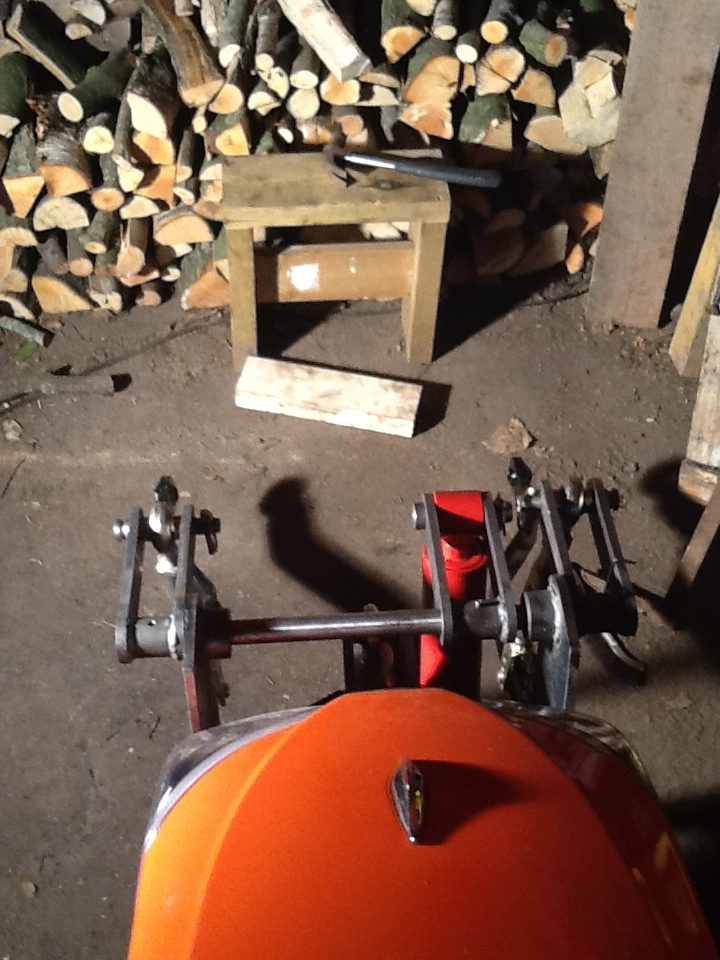

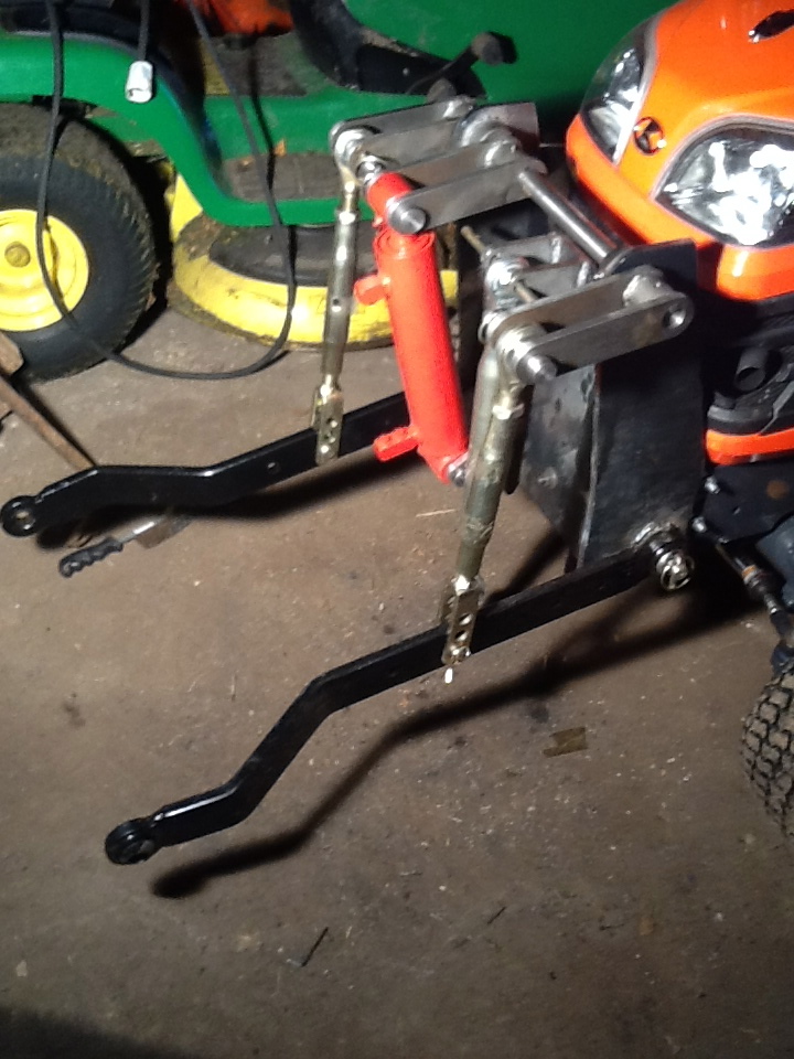

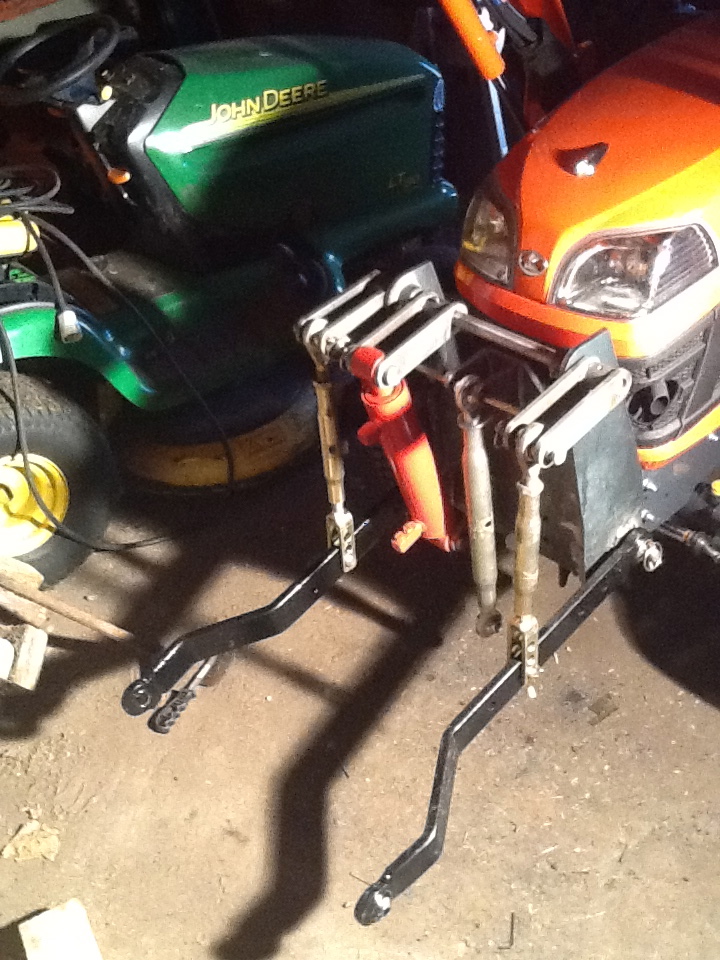

The front lift is getting ready. Hydraulic hookup and painting left.

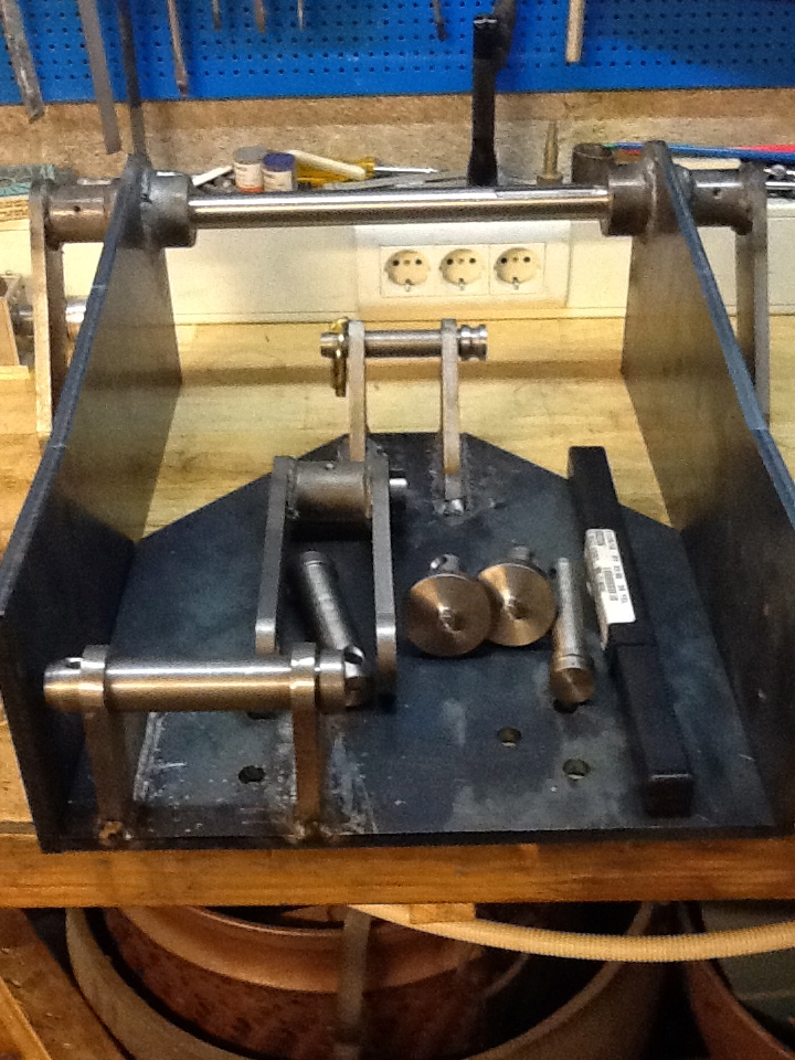

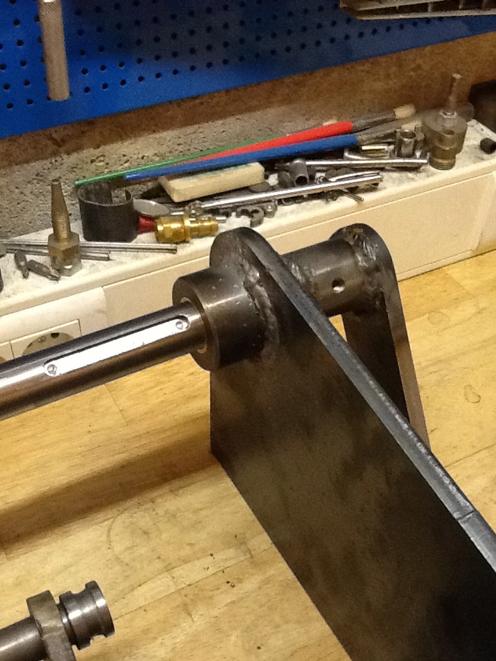

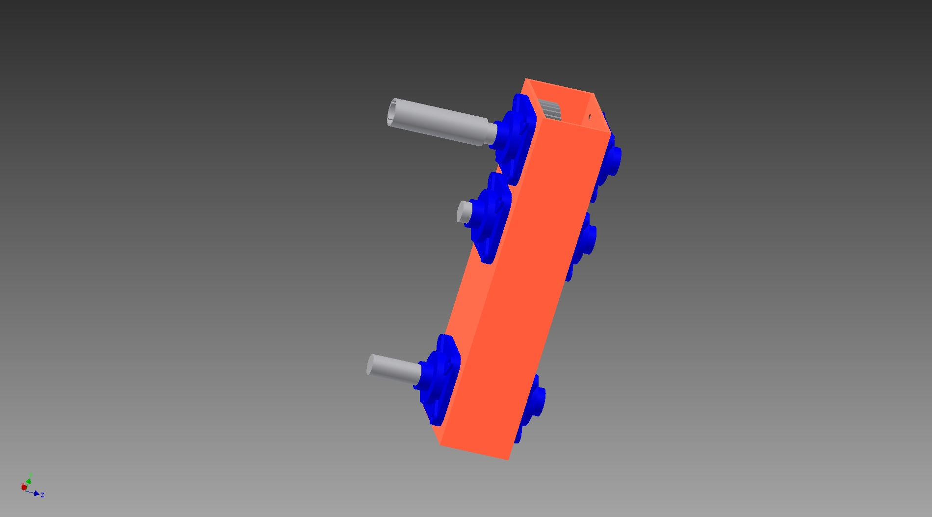

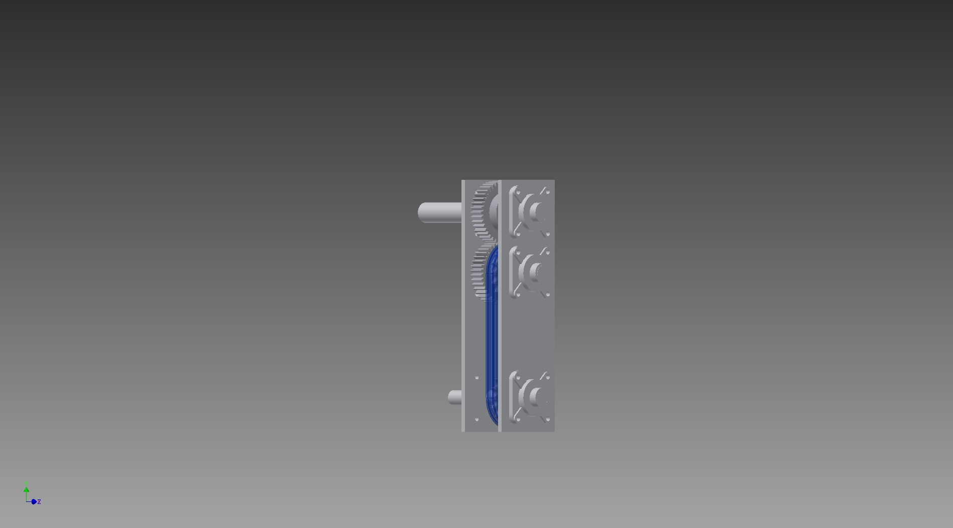

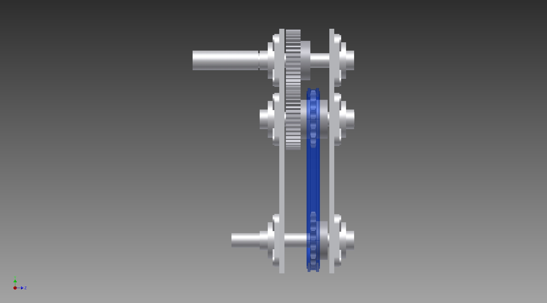

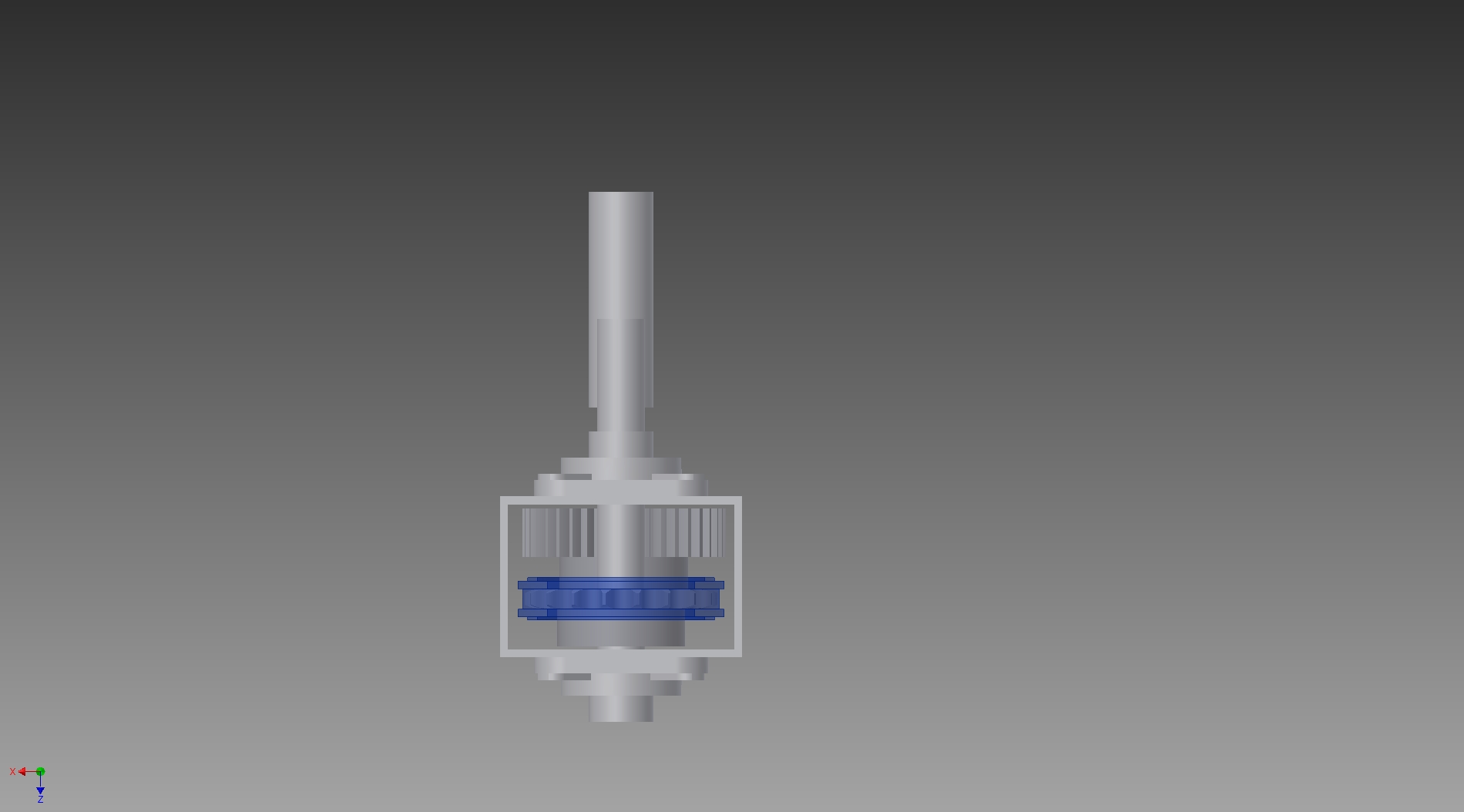

#30
Hi
Here are the design of the rear gearbox. To reverce the rev, I have put in a set of spure gerars Metric module M3 Z40 and further chain and sprocket #60. Than the rev should be correct. I,m putting the drive inside a rectangular tube 150x100x6. The first two images shows shows the drive mounted between plates.
