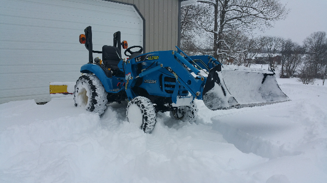

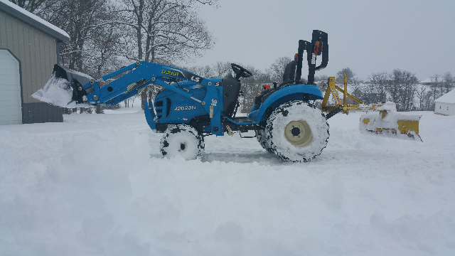

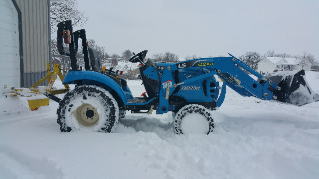

We got a lot of snow this year and my LS really did great. I use the front bucket in float mode and curl the lip of the bucket up about 2 inches. This let me push the bulk of the snow in front of me and at the same time I used a rear grader blade to scrape that last 2 inches as I went.
