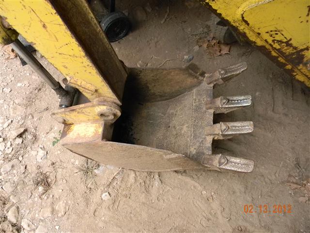

My backhoe came with two buckets of the same size. Most of the time, I seem to be digging to install 4" french drains or smaller conduit in yards, and the bucket makes a pretty large and messy hole.
I'm thinking about cutting one of the buckets to a smaller size. The mounting ears are about 6 1/2 inches wide and the overall width in the back is roughly 13 1/2 that tapers outwards to about 16" at the front lip. The teeth stick out a bit further beyond that to about 18-20".
I need to leave the mounting ears alone, but where do you think I should make the cuts to reduce the overall side of the bucket? The teeth are pinned in place and are replaceable.
It has been suggested elsewhere on TBN that 10" may be about the smallest one wants to go with a bucket in order for the dirt to dump out more easily.
Assuming 10" is about the right size, is it worth the effort to do this?

I think you'd be time and money ahead to just build a new one. There are a lot of different styles of homemade bucket here on TBN.
Another option is to sell the one you have and buy a smaller bucket.

It's a Terramite. Given their prices for parts, I'm relucant to buy another bucket from them and also am not sure what the market would be for selling one that I already have.
Really, how hard could be it be to cut out part of the bucket on each side with a plasma cutter and then stick weld it back together? I've got the stick welder, but no torch or plasma cutter. So I'd have to get my LWS to do the cutting, but I need to tell them what to cut out if it's worth doing.

If you really want a narrower bucket and you think that it will work in your soil conditions I would modify the one you have. There probably would not be much of a market for that size bucket since most of those backhoes came with that size bucket. You could use a small end grinder or angle head grinder with a cutting disc and that would take a little bit of time but you could get it done on your own. I use a carbide tipped saw blade that goes into a worm drive skill saw that is designed to cut mild steel that would make pretty quick work of cutting the bucket you have. I have a Woods backhoe and a new 24" bucket is about $850 plus shipping so I will be making my own.
/ smaller backhoe bucket? #6
I made an 8 inch wide one for trenching. Its too narrow and will not clean out when digging clay. Even the 16" that the backhoe came with gets stuck full of clay eventually.

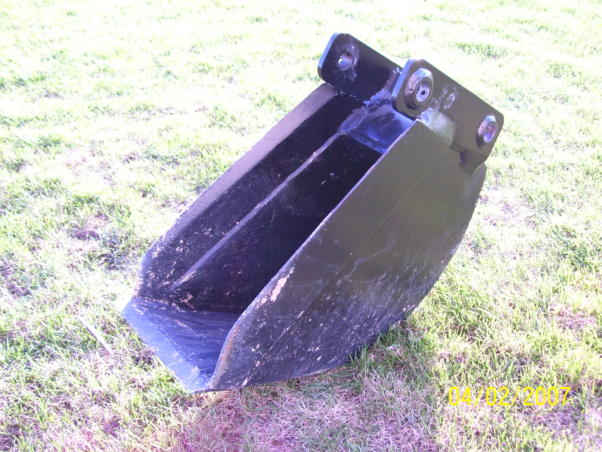

I decided not to listen to the advice of those who had gone before me, and made a small bucket.
I incorporated what is know as a dual taper design in my bucket. Which means it is wider in the front than the back, and wider at the bottom than the top. This is said to be the best design to help with sticking. And, I also put in the recommended hole to break the suction.
So much for that, my bucket needs to be unpacked with a shovel, on nearly every dip if the ground has any kind of moisture in it.
I have found if I wait until August, and don't dig deeper than about 18" it works great. Otherwise, this is exactly why God created rental stores, and 6" trenchers. :thumbsup:

Heres a link to an MFG in the UK that makes nice attachments. I have made a bucket like this one. It works good trenching gumbo Clay down south. Once you get down the trench makes the sides of the bucket. These are easy to make.
Whites Material Handling, Bristol - Clay Spades
I just made a template of my bucket and put it on the table burner and made the ears. I welded the sides and edge on the bucket and top. I tacked on the back then rolled it with the hoe.

My homemade 8" bucket has no flare. The post above that shows the Whites buckets, that's what you want if you are under 16", in my opinion.
