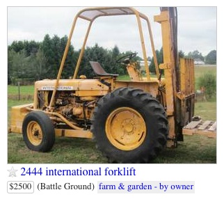

Maybe get an old lifting machine for your bale lifting?
Or a used conventional forklift suitable for your terrain.
Bruce
