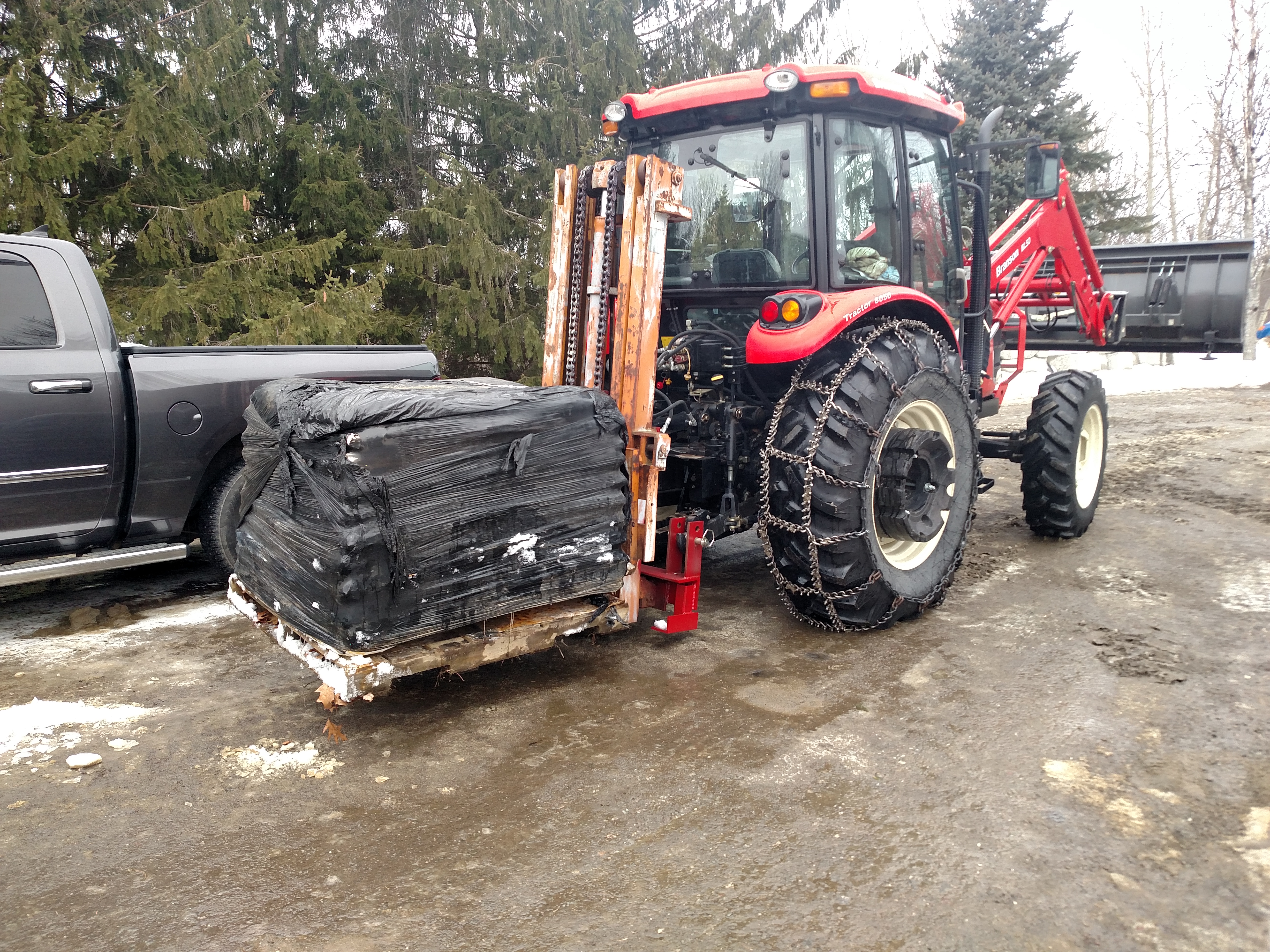

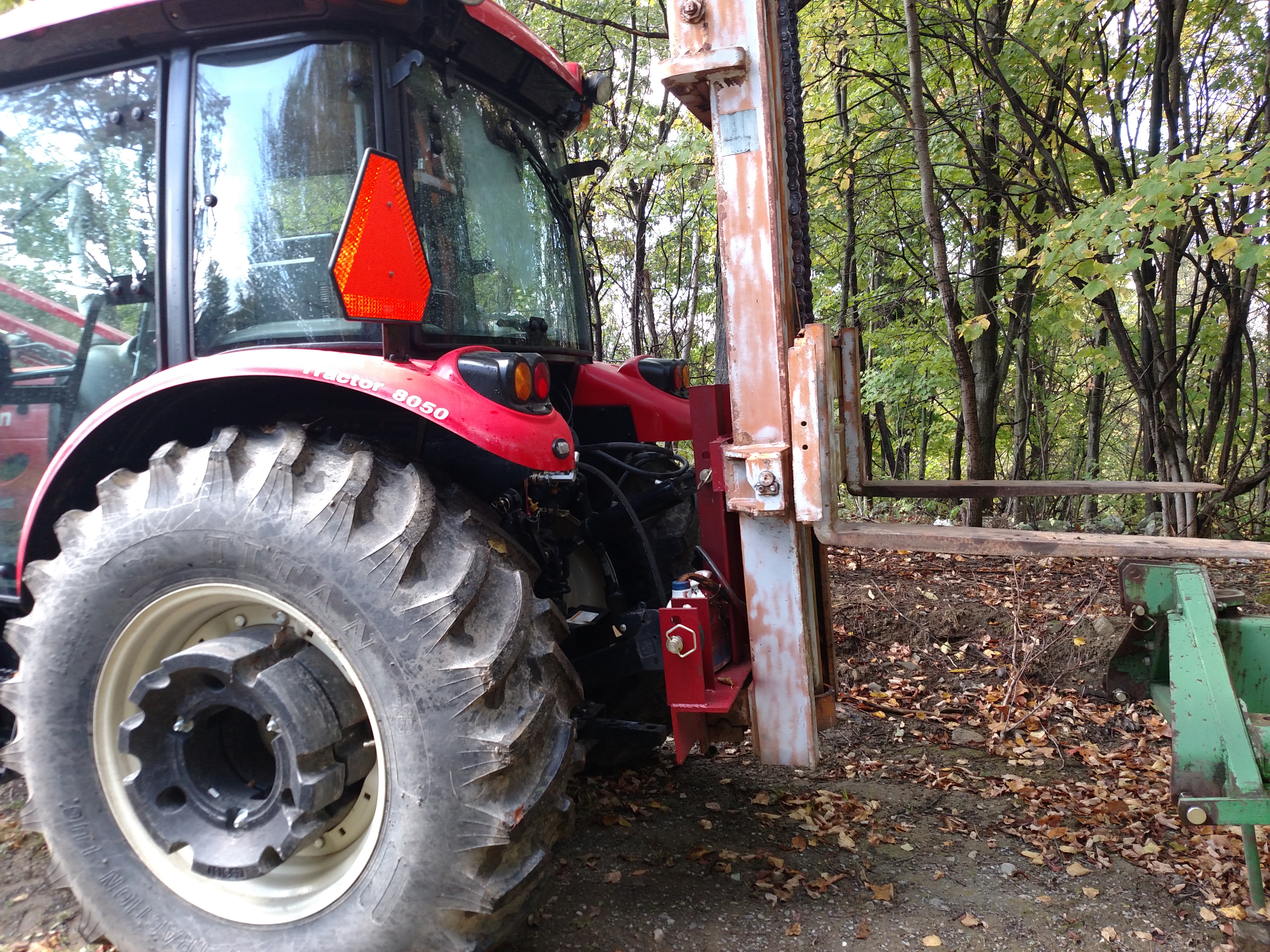

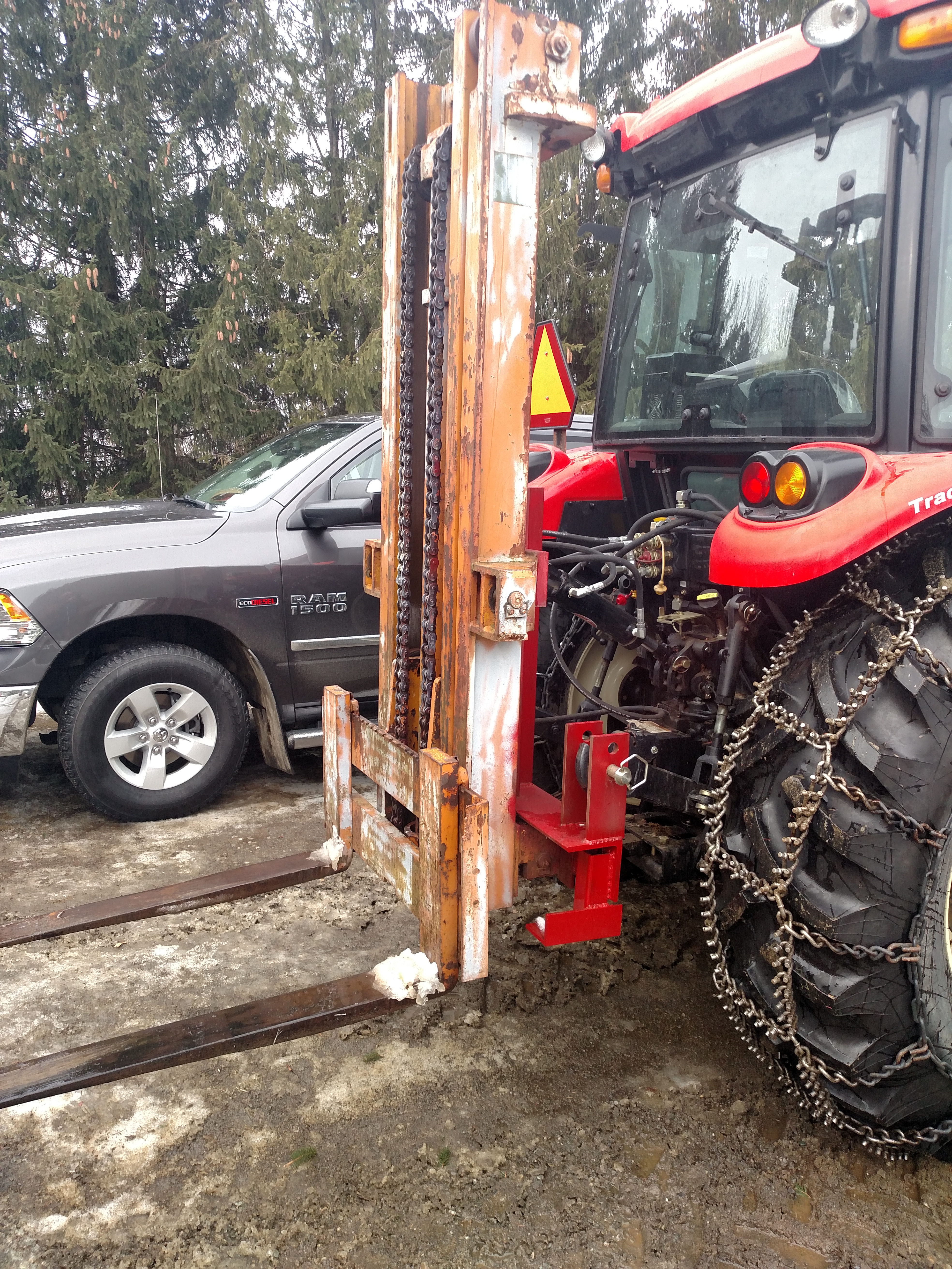

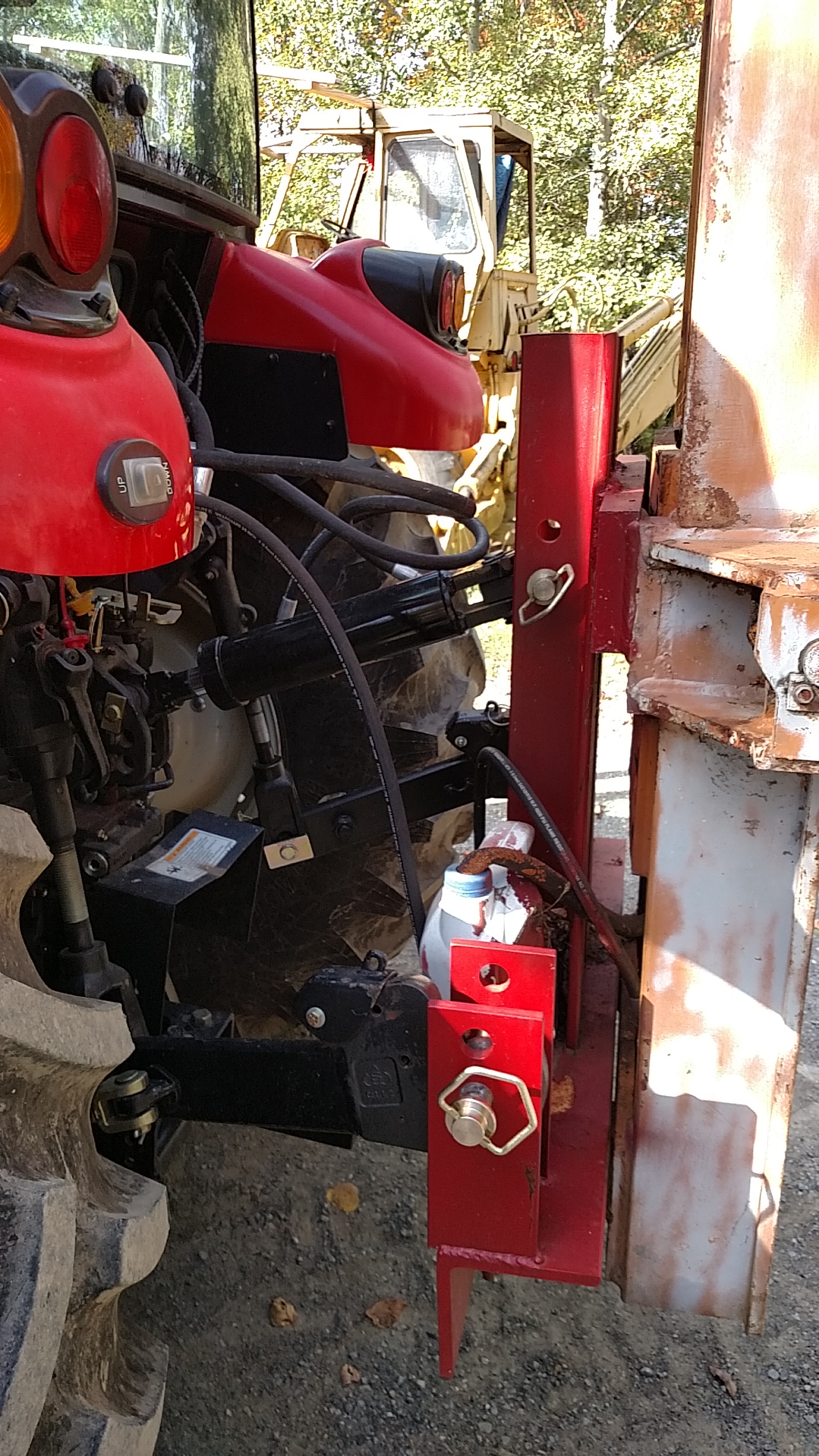

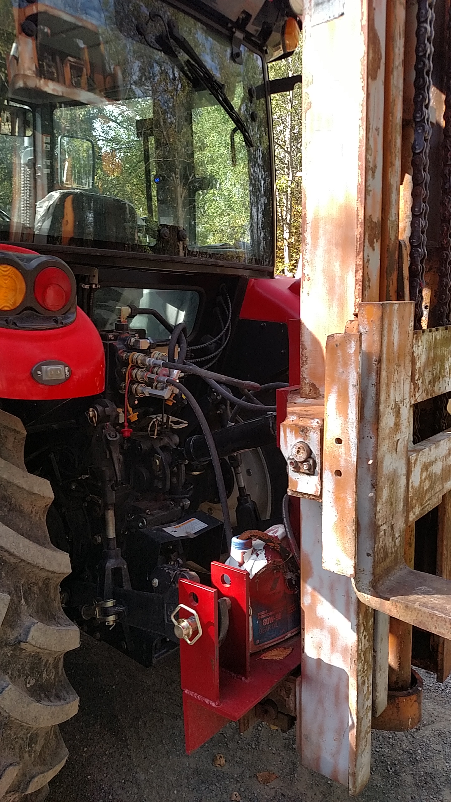

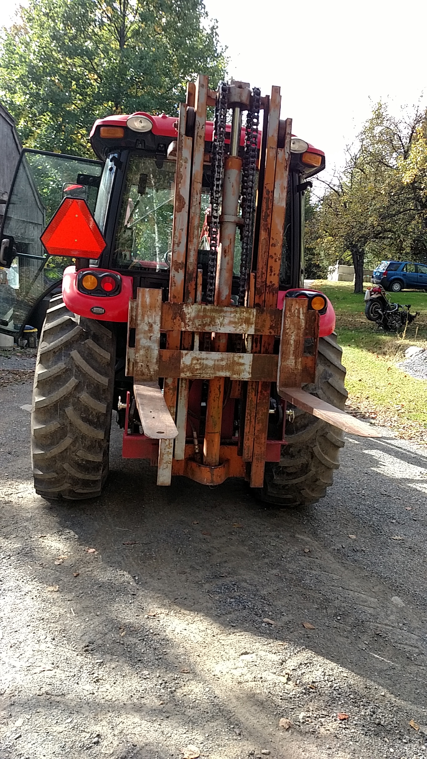

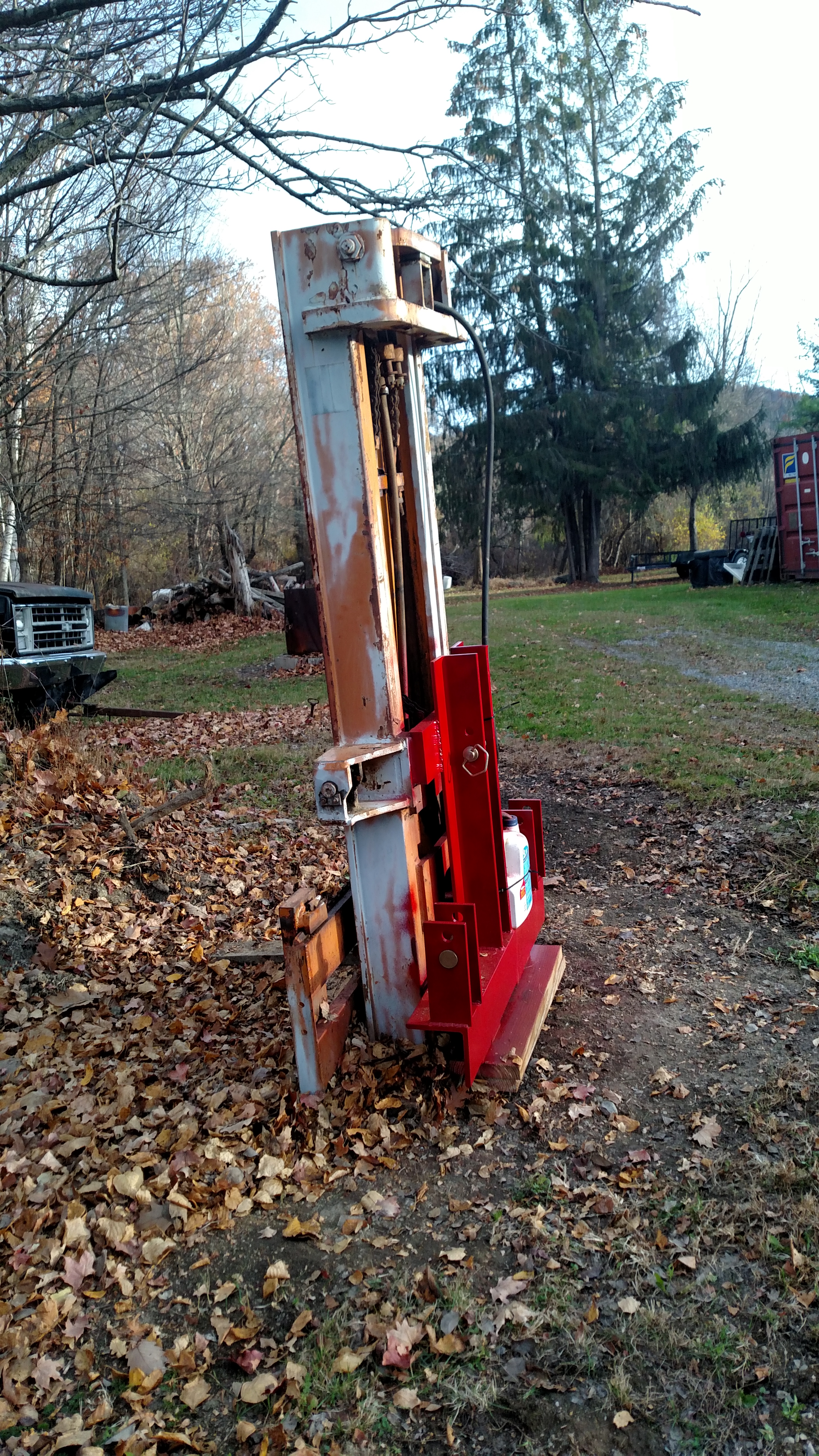

My 3 point fork lift is from an old mast and I use it on both my tractors which are open center and it's been used at the farm and all but 3 of those are open center hydraulic.
I use a hydraulic toplink to tilt the forks running that off of one of my remotes, I run the mast off another remote and I can use the 3 point if needed as I'm usually only running one cylinder at a time. On my loader on the open center system if I'm trying to curl and lift at the same time I can do so by just feathering the joystick for what I want to do.

I am borderline inappropriately aroused by this. Very nice forklift attachment! My setup will be a bit different. Your tractor is much bigger than mine. I'm sure the 3pt rating is plenty sufficient to carry the weight of the mast plus the load. Mine isn't. The forklift is is rated 5000lbs and I want to be able to carry every bit of that. Mast probably weighs 1000-1500lbs. My 3-pt is rated 2,700lbs, so subtracting the weight of the mast I could only lift maybe 1000lbs. So I'm going to keep the forklift axle and wheels under the mast. That's what will bear the load. The tractor's 3pt will keep the mast pointed toward the sky and basically just drag it around like a trailer. There will be some side load in tight turns so I'll have to be careful, but I'm optimistic about it.
I also plan to use a hydraulic toplink for tilt. Or maybe make my own hydraulic toplink out of one of the forklift tilt cylinders; wouldn't that be ironic.
I will give some more thought to what you said about running it open center. Thank you for sharing.

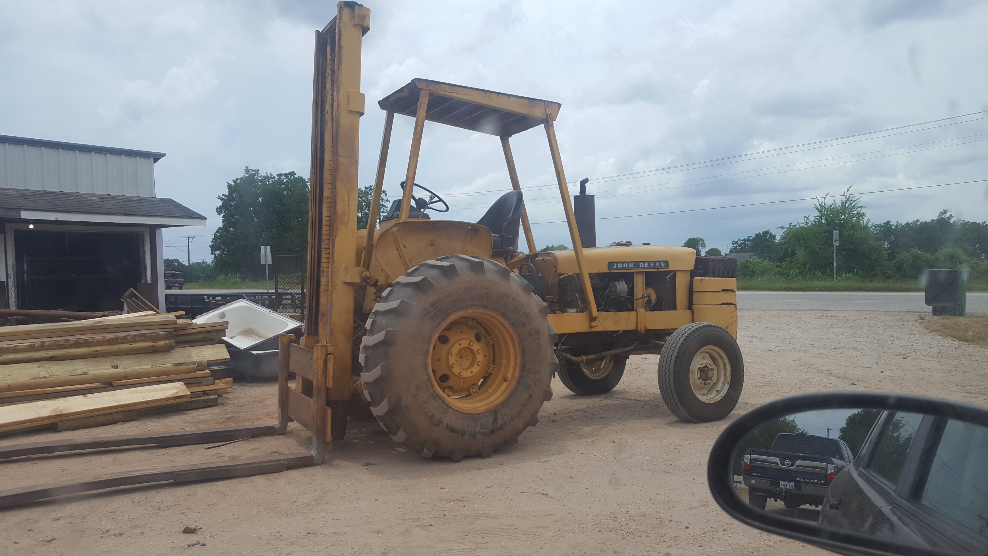

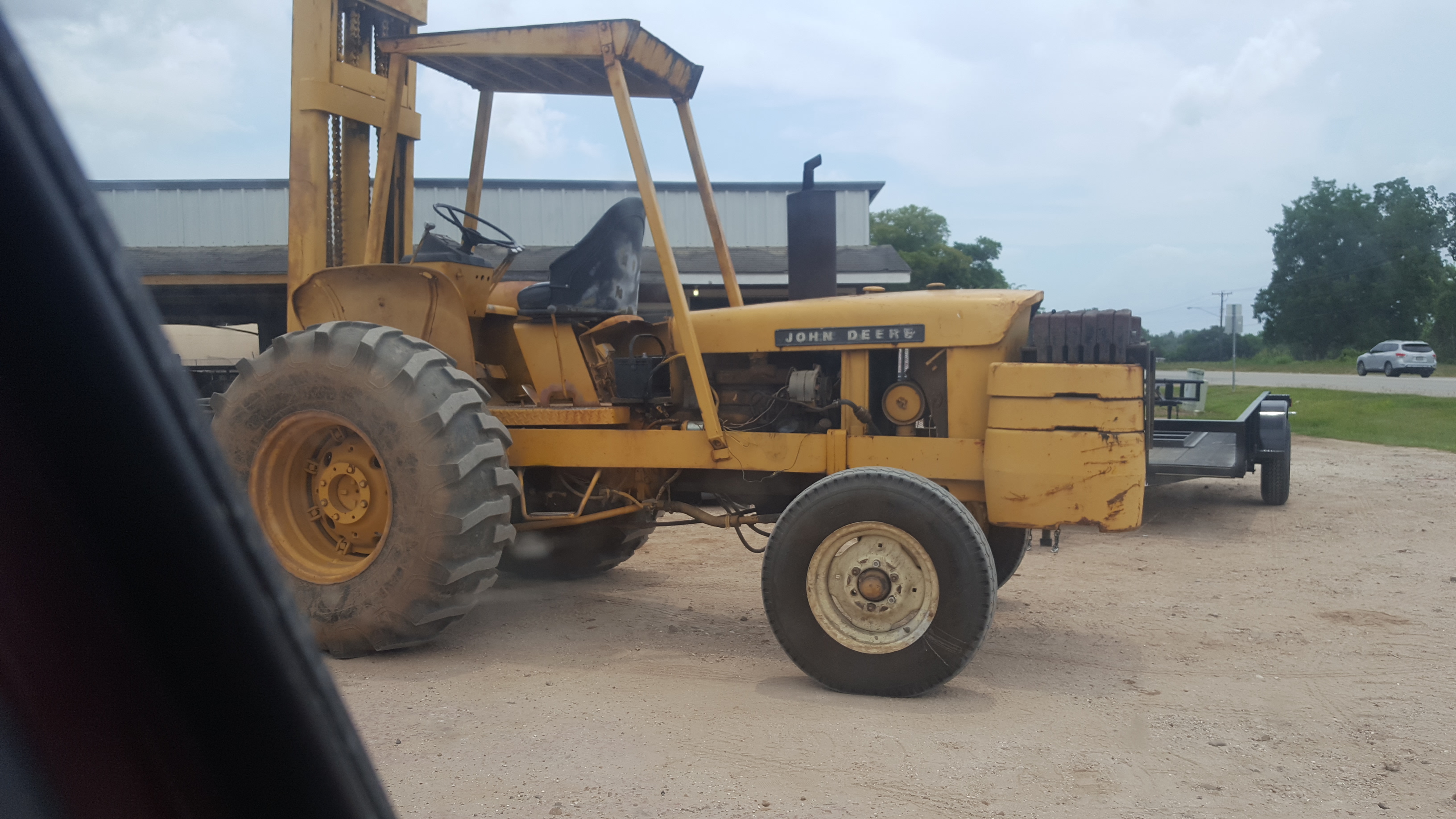

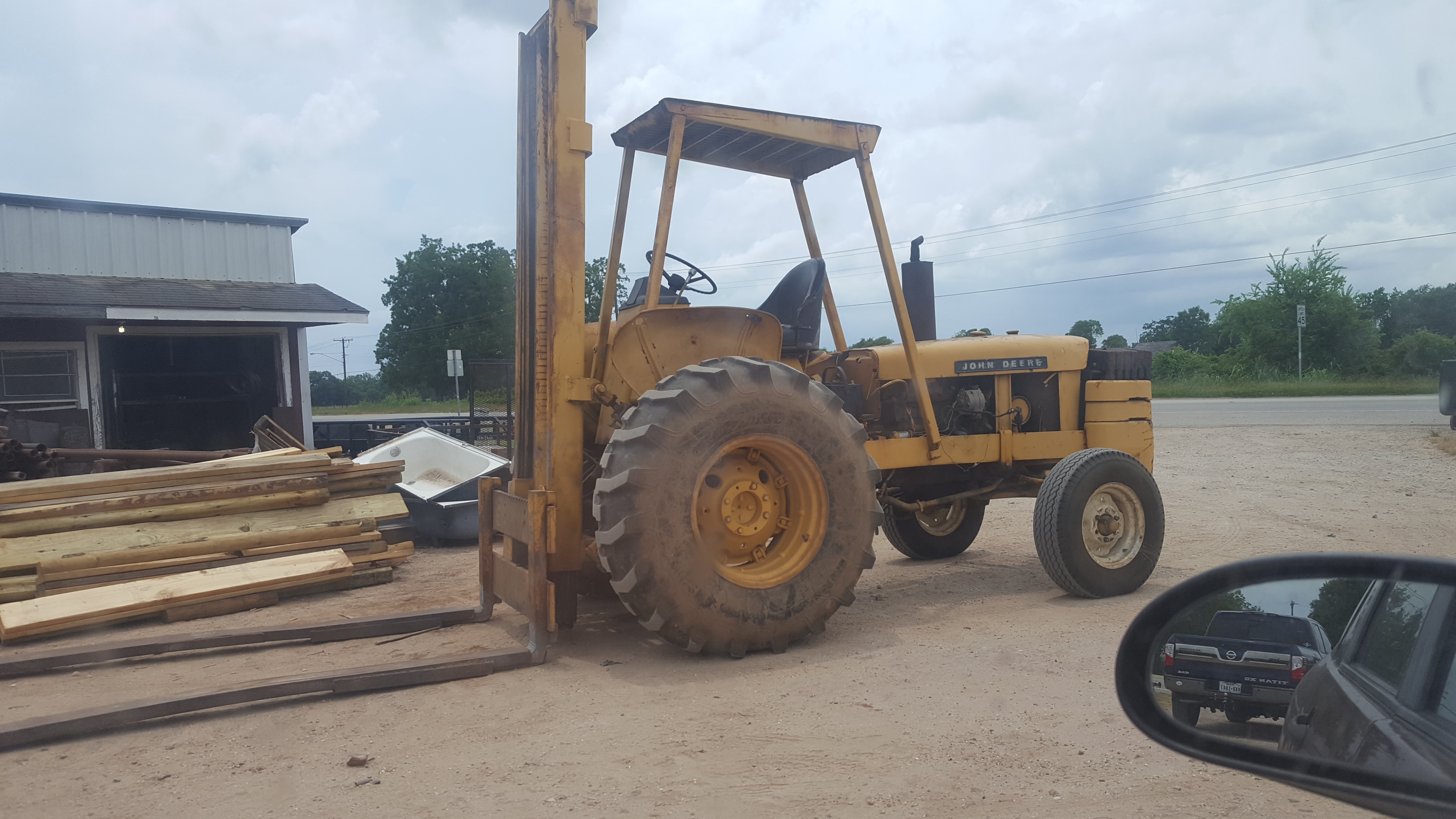

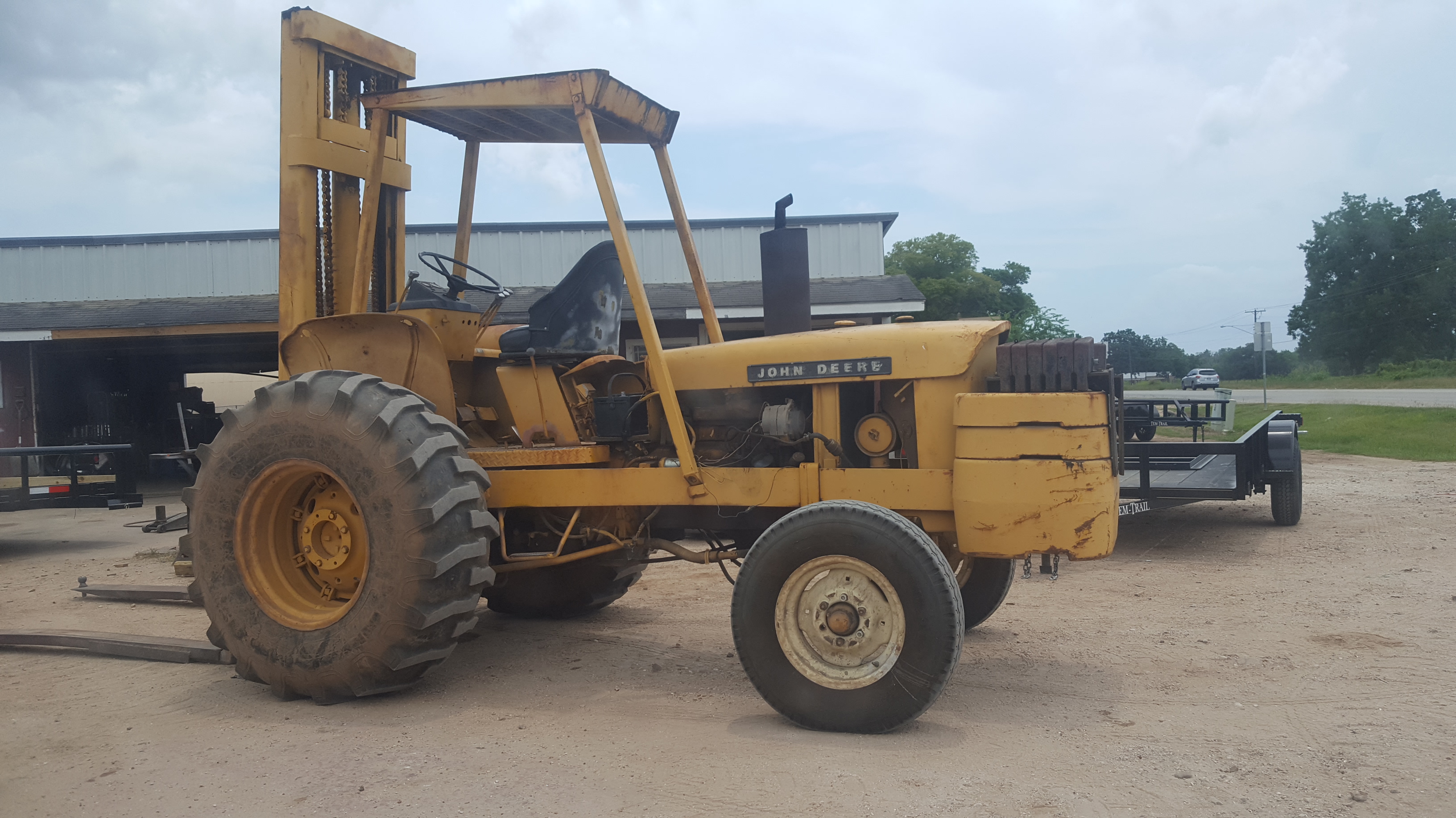

It is a reversedrive tractor with a forklift atach to the bigwheelside
JD beat them to the market by a few decades. I saw this at a place that builds trailers, shortly after I purchased my tractor with plans to build a forklift attachment. When I saw it I felt totally vindicated in my silly idea. That was before I discovered this forum and the fact lots of people have already done what I wanted to do.
