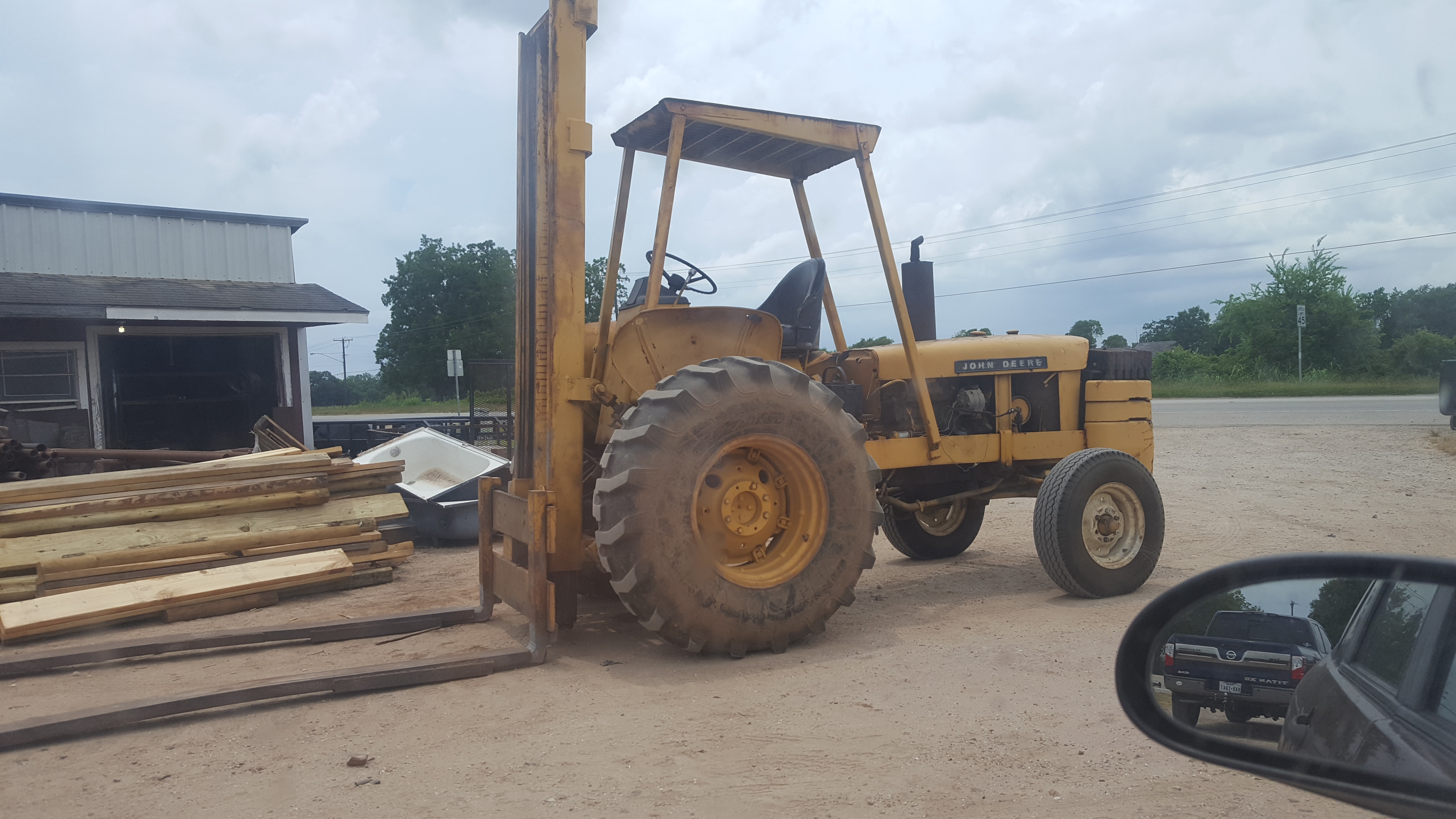

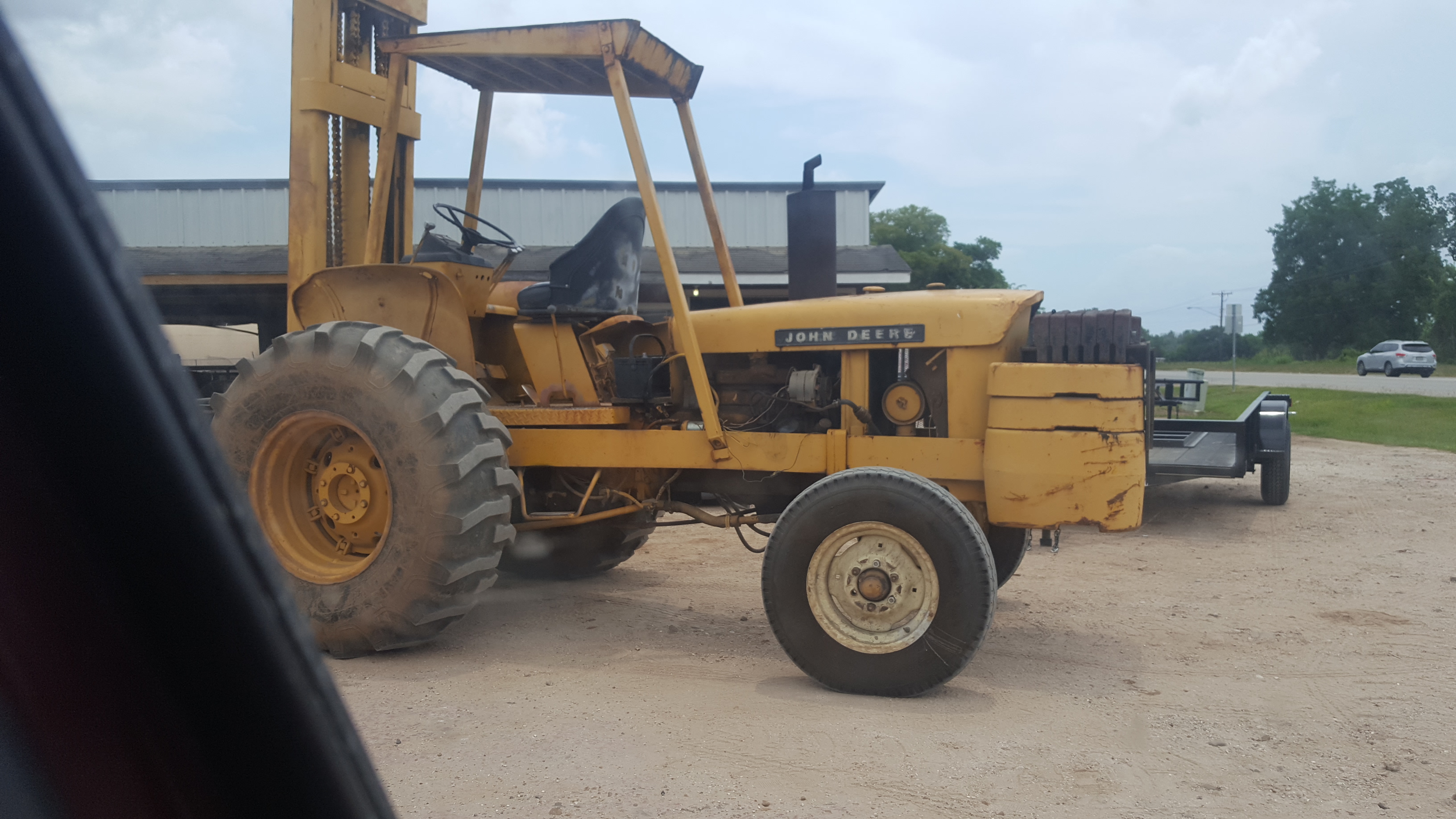

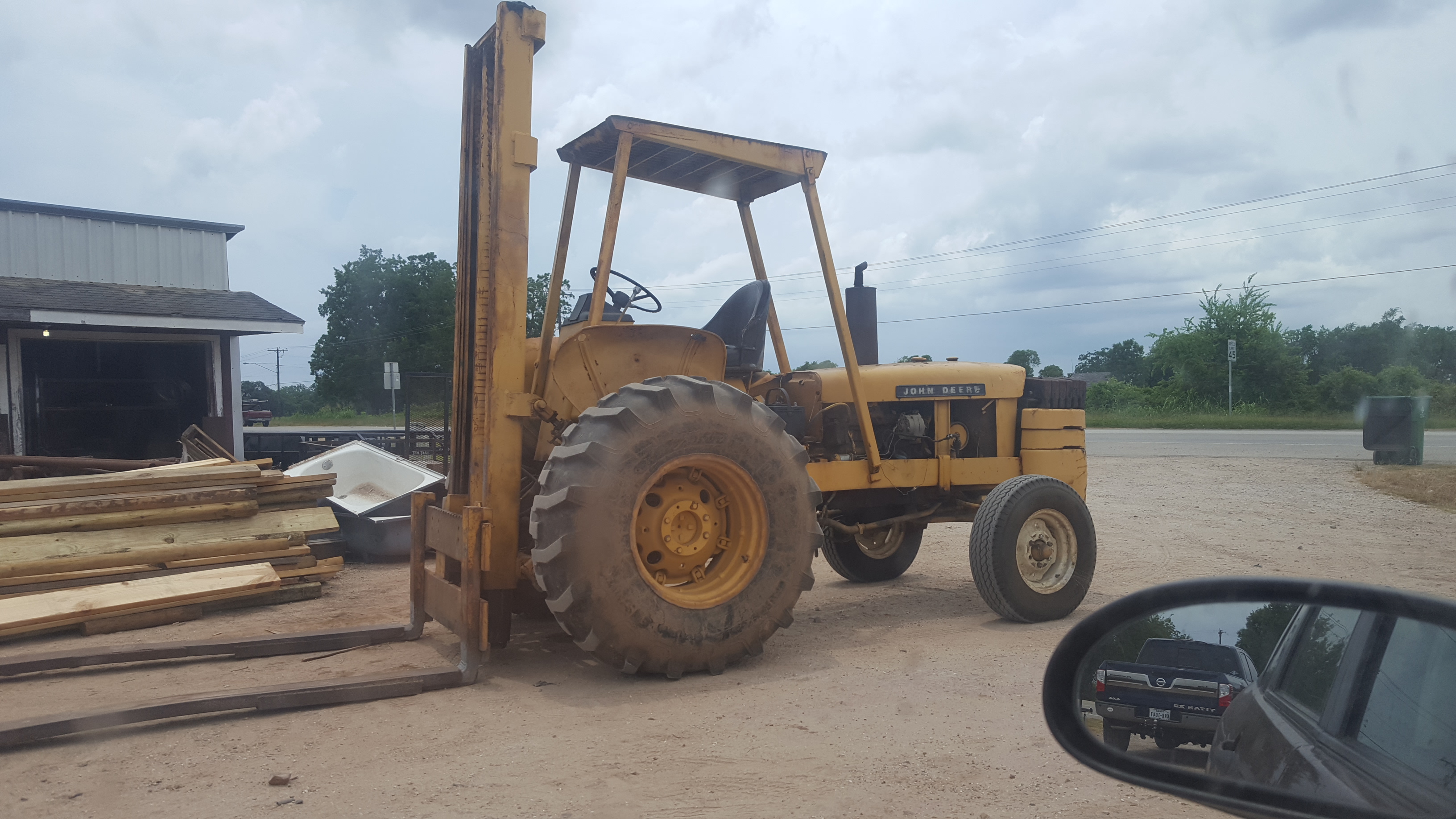

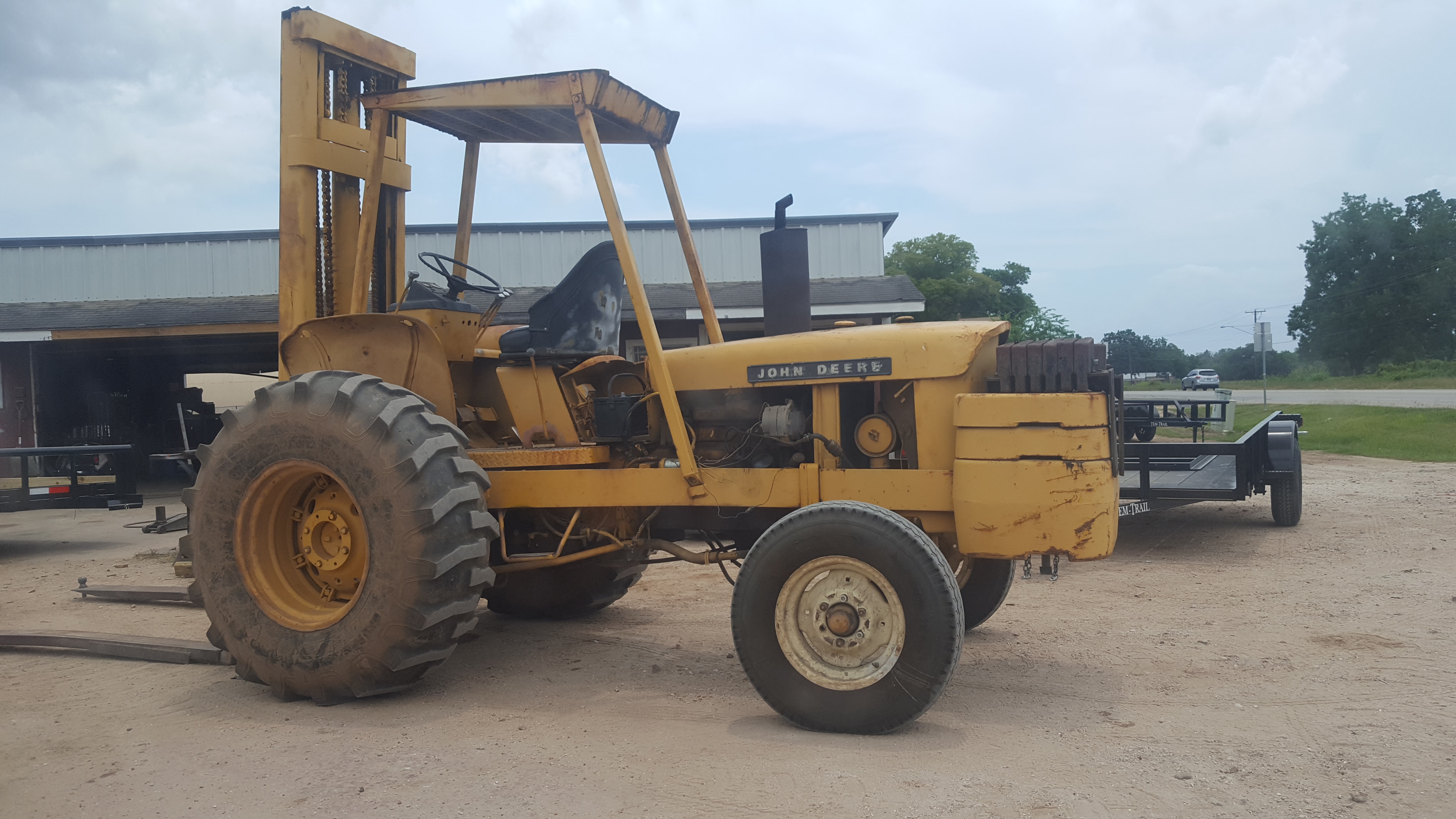

JD beat them to the market by a few decades. I saw this at a place that builds trailers, shortly after I purchased my tractor with plans to build a forklift attachment. When I saw it I felt totally vindicated in my silly idea. That was before I discovered this forum and the fact lots of people have already done what I wanted to do.

I don't know either, but I strongly suspect that the machine I posted was born in that orientation. If you Google "John Deere 480-B" you will see loads of pictures of machines exactly like it.

Look where the forklift mast is attached on that machine. I don't think it's the 3pt hitch. I think its to the frame, as are the two huge tilt cylinders.
I'd go get some more pictures of how that thing is configured and try to copy the design.

You're absolutely right, it's fixed to the rear (I mean front) axle. This page has heaps of pics.
I thought about doing the same thing. If I were to remove the 3-pt and bring the mast in as close in as I can get it, and mount it directly to the axle where the ROPS mounts, that would be awesome. It would make the tractor more stable, make maneuvering inside my shop much easier, all around good. But my axle is only rated 4,600lb and there's probably already 1,500 lbs of tractor sitting on it. I add another 1,500lb for the mast, and then my lifting capacity is only 1,600lbs. I'm going to be moving around CNC machines, very heavy. I would be much more comfortable with the forklift's axle handling the weight and the tractor just keeping the mast vertical.
