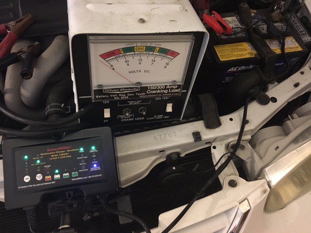

OK... so it did arrive... took a long time but arrived.
Had a car that was parked almost a year... just parked... battery stone dead.
Took out my new charger and nothing... which I expected.
So I get my jumper cables and connect in paraell from my car... so juice is flowing... hook up the new charger and now have life.
In 36 hours it has gone through several permutations de-sulfate, test, de-sulfate... last night it shows fully charged and good to go... car starts fine.
To fully report I will need to bring my load tester to see just what kind of reserve capacity a 5 year old battery brought back from the Dead has... AC Delco Battery.

It can take weeks of being connected to the charger to fully bring back a heavily sulfated battery.

Does it have a long-term De-sulphate mode/setting ? More time in that mode may help a batt sitting that long.
Post the load-test results when you can, that will be interesting. Add years to a couple of batteries, charger is paid for, right there....

Charger is fully automatic except for charge rate and type of battery...

Just ran a 300 amp crank test for 1 minute...
Battery dropped to 10 volt but held steady.
Put charger back on and it is in full charge mode.
PS for those following my other thread on WiFi this picture and post made courtesy of my neighbors WiFi
I had to rotate the laptop twice to get a steady signal but success!
