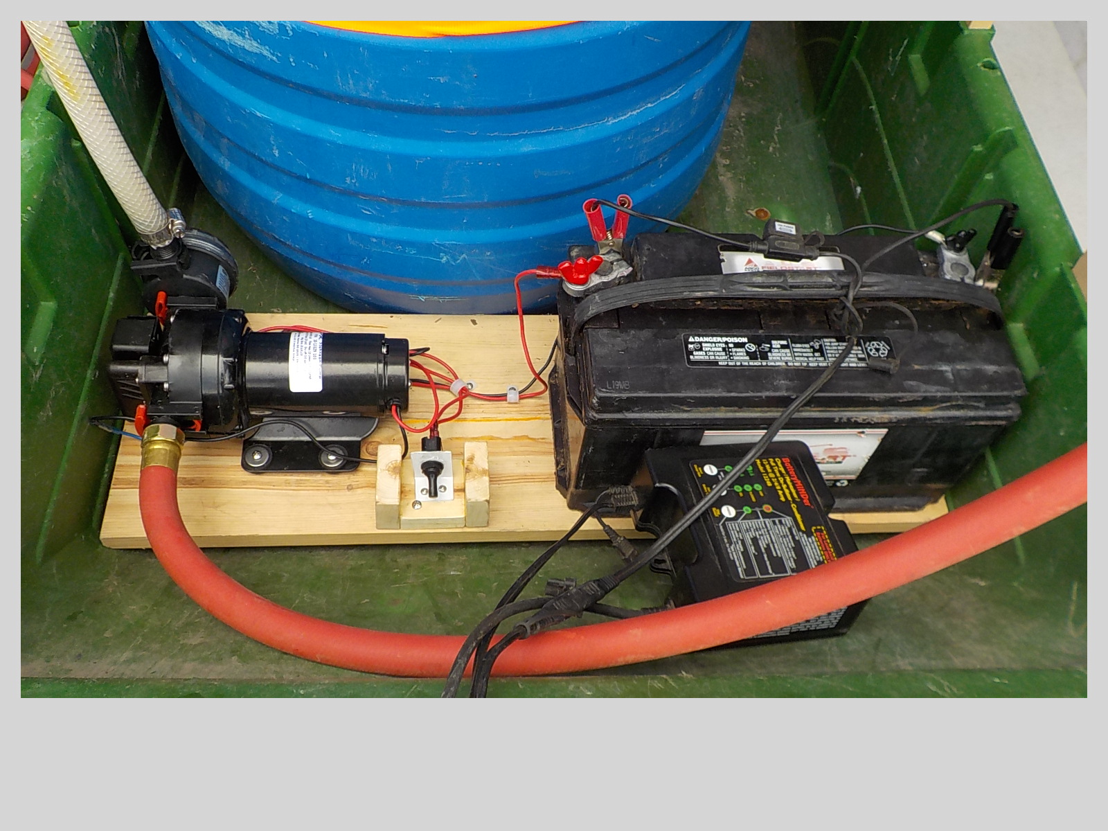

Our B&D Vectors smart chargers have 4/10/20/40 amp charging rates options. I often start out on 40 amps for a couple minutes to check the health of the battery. The one on the S10 was showing 7.6 voltages when I started the recovery and on 40 amps only started charging at the rate of about 8 amps with a slow rate of increase. After some time it did start taking the full 40 amp rate.
I cut it back to 4 amp rate which I prefer to use to recover dead batteries. This is a 2 year old FLA battery from WM I think. It has been discharged for several months so I bought a new 100' 12/3 heavy extension cord to give me the 200' reach needed for it and the dump truck and backhoe. Yes I should have spent that $59 many years ago.
We keep some 2/6 amp totally manual chargers to use with the automatics only running in Desulf mode on head FLA batteries. Set on the 6 amp setting a healthy battery charge rate will drop to 1 amp/16 volt output overnight I have found. If it will only drop down to say 2 amps then it is getting on the sick side. If it will only drop down to say 3 amps it is very sick. If it is on a diesel tractor do not park it out of the reach of 120 volts. If we can get the battery on the S10 to drop down to the 1 amp output reading on the manual charger I would pleased but highly surprised as well.
i am rocking with with the smart charger. I run a Desulf cycle then charge at 4 amp setting in Equalize mode (to get 15 volt output) until it finishes in Auto mode then I do another Desulf cycle then repeat until I get tired, recover the battery or totally kill the batter.
In AGM mode these smart chargers will not go into Equalize mode i figured out.
I short I think 2 amp rate is better than 8 amp rate to desulfate. I think on the two amp rate one can keep the charger on without any real harm if the battery is good. I have had the backup generator on 6 amps for weeks at a time (forgot about the sucker) without any negative results but they were not AGM. Some say AGM batteries can better take charging abuse but I do not have a desire to test that out on our 4 new AGM batteries.
Hey we do have that was new 5 years ago on an ATV that has not been touched because we blew it up right after putting the battery on it so that can be an AGM that I can test. :)
I think these chargers may be sold with the Stanley label today but seem to be basically the same China built chargers.
