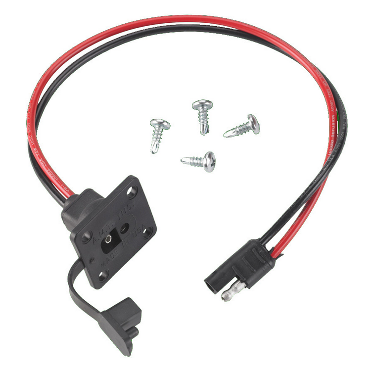

I'm thinking of adding one of these bulkhead fitting charger connectors to a couple of my "toys":
Flush Mount EZ Connector
Flush Mount EZ Connector with ring terminal and fuse
Just haven't figured out where I want to mount the one on my tractor

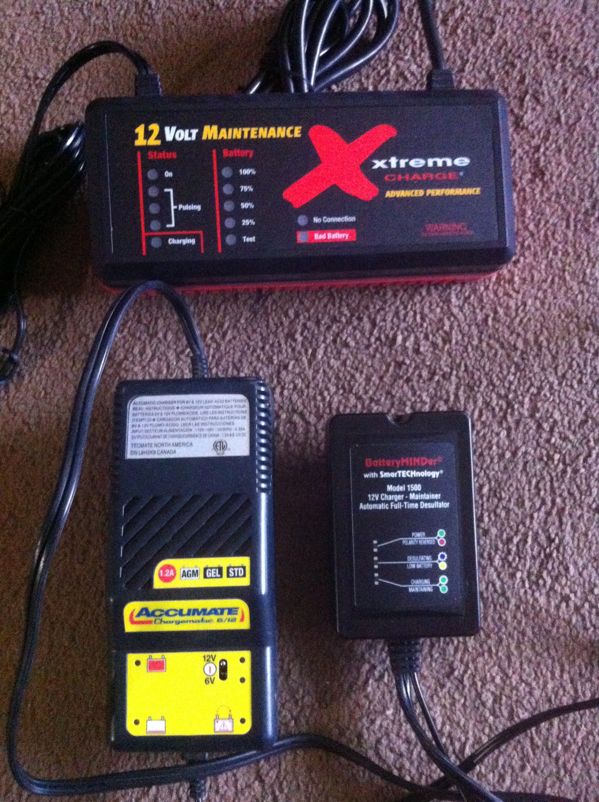

Here are 3 of my 4, and they vary quite in 'buttons and bows'. First, 'Accumate' apparently uses an iron core power supply like our 'dumb' chargers vs 'switching' type of 'BatteryMINDer' and what charges our handhelds. I kinda doubt that this aspect is as significant as the electronics and automation within, and if the 'PT Xtreme' is by far the largest it weighs about half as much as the Accumate.
I've braced up tired batteries that had to be topped up every 4-5 days, and with auto/float gear, to light their fires. After playing back forth with 'AM' & the 'B's, I just won't accept these as 'snake oil', and based on some batteries' seeming stronger if floated, and faded less during idle periods after. btw, I'm darn sure I haven't used both brands on any battery (autism :rolleyes:), so I'm happy to put my personal stamp of 'maybe you care' on 'em. :thumbsup:
I wish I could offer say, a controlled test of the now-three chargers, or monitor results with an o'scope to see what's really 'what' when one is OTJ. However, and unfortunately, the matrix of procedures would exceed the capacity of any lined paper I have on hand. Sorry :D That said, I could set up just about anything y'all suggest with the Pulse-Tech Xtreme that just came today (also means I'm adrift on where to re-connect which one next .. :confused2: ... old age .. :laughing:)
EDIT: Ultrarunner, please note that 'Accumate' 'does 6v'. It did a J.O.B on a 280CCA that wouldn't start w/o a jump (B&S 22hp). I did it 'the long way' for lack of confidence by disconnecting sometime after 'green', and reconnecting 24 hrs later. The first few days it was 18 hrs to 'go green', after a week maybe an hour or two. Yes, it was 10 days or so when the light would turn green inside of a minute. No guess whether I needed to disconnect daily, but falling on my old practice of soaks between cycles I hope it suggests that desulfating was at least as much the boost as depth of charge would be. My point is that the IMO Accumate shouldn't disappoint in 6v mode. :)

Just guessing - probably your arthritis will be the gating factor re. the best connector choice.
Flat 4 trailer connectors are cheap and widely available. Could be doubled up (2 pins per conductor) to handle more current on a 2 wire hookup. For pulling apart, maybe drill a hole towards the back of the body of each connector, and loop a zip tie through to make an easy pull ?
For custom wiring, Anderson power pole connectors are more expensive, but are scalable to major current levels and are easy to configure in custom/keyed orientations (a bigger benefit with more complex hookups than 2 wire). Should be available various places online, or if you can still find an amateur-radio store standing (or get to a AR flea market), they should be on the shelf.
Powerpole(R) Stackable Connectors, Anderson Power Products
Kind of like Lego 101 for the connector world....

yes, thanks, this is heavier duty version. Dave's idea of doubling up on a trailer plug was a great solution for how can I do this with what I have.
something simple hanging down would be ok; thinking of the receptacle end. Dave, pushing the plug in isn't so bad. It's pulling it out that is hard. And why getting a PTO collar off is becoming a real issue for me.

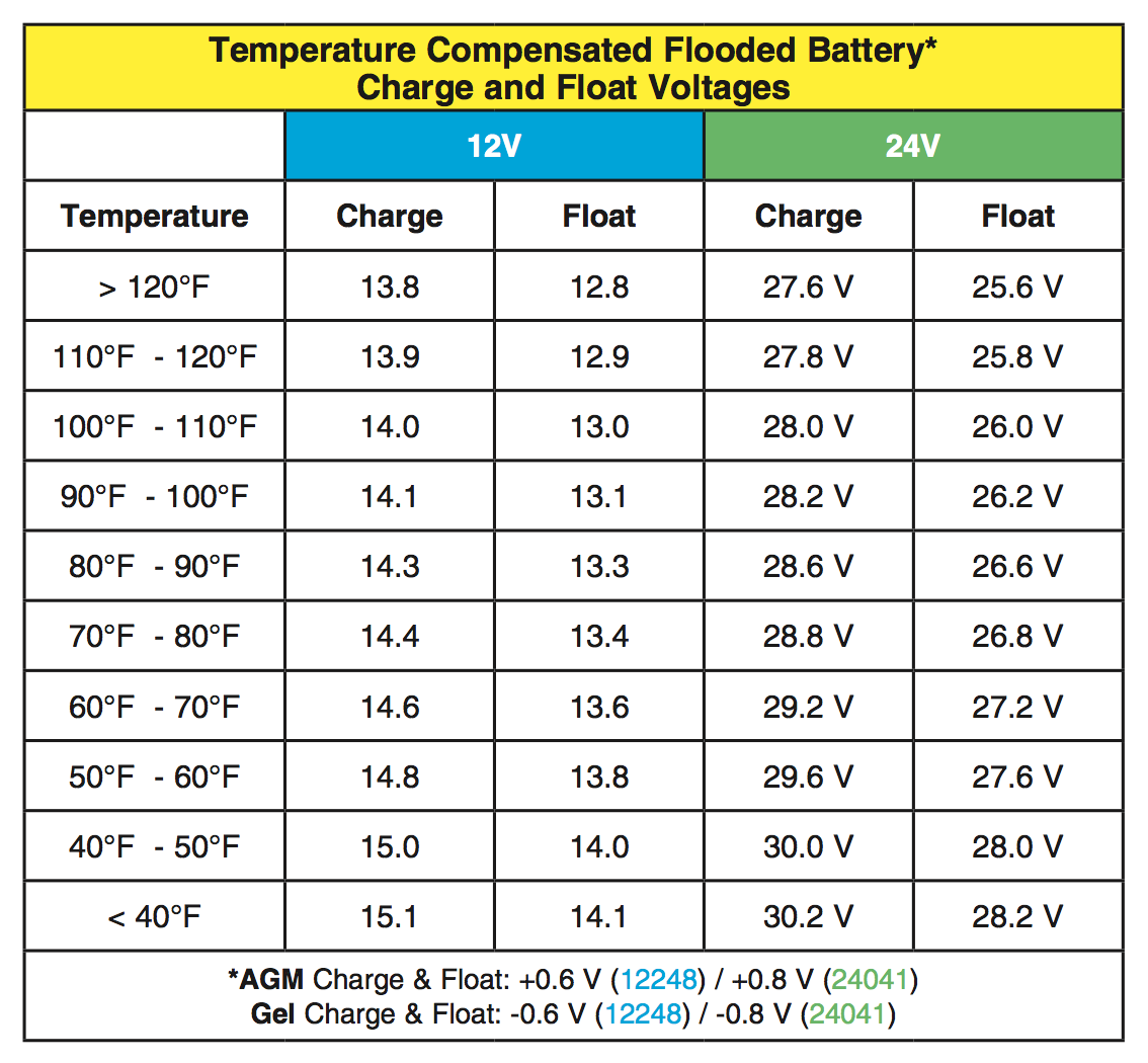

I have a Genius charger and wonder if I can battery recondition/desulphate in cooler weather? No mention in the manual. It's in the low 50's now and I wonder if too cold or if that even matters.
   / Smart battery chargers with reconditioning modes #60
Even a non-temperature compensated charger should handle the low 50s with no problem. THe recommended charging & float voltages for the low 50s only differs by 0.4 volts from what it would be for a temperature in the 70s.
Also: as the temperature gets colder, the recommended charge and float voltages go UP. So you won't fry a battery by charging it on a non-temperature compensated charger. The worst that will happen is you will not charge it fully (which is not great, but better than not charging it at all). I've attached the temperature compensation graph form one of my charger's manuals. (One of these days, I need to get someone to tell me how to attach a full-sized picture, rather than a thumbnail)
