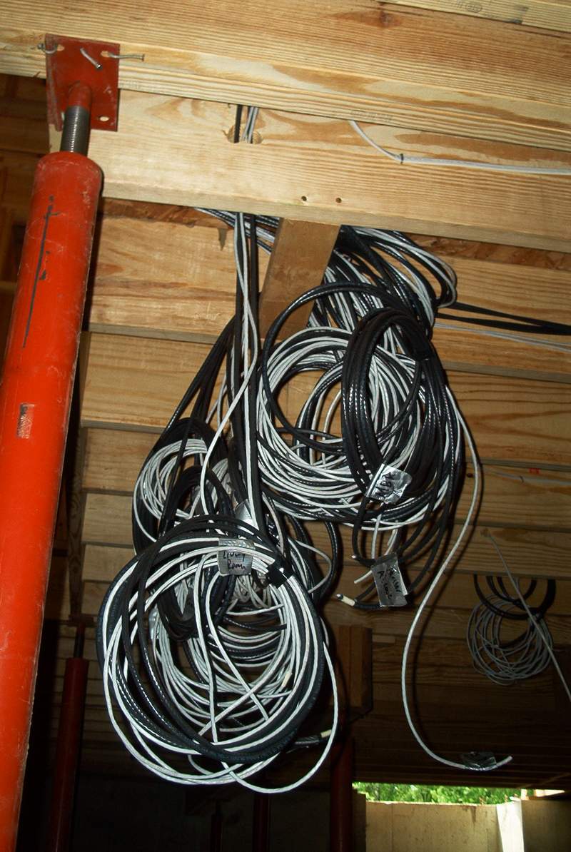

Here's a picture of the results of all my wiring efforts last weekend. Somehow, it looks more impressive in person. What isn't shown here is the speaker wires as I ran them to various entertainment center "zones" rather than a completely centralized system.
A quick tool review: Milwaukee "Hole Hawg" right angle drill is one kick a$$ piece of equipment. Good self-feeding bits are essential too /w3tcompact/icons/smile.gif

He He!!! I used the same labels on my wiring /w3tcompact/icons/laugh.gif

<font color=blue>He He!!! I used the same labels on my wiring </font color=blue>
Great minds think alike, eh David? Did you notice the highly sophisticated masking tape on some of the wires to differentiate dual runs to the same locations? Whatever works /w3tcompact/icons/smile.gif
   / Smart Home Wiring #38
That's where we differentiated; I used one band, two band, three band of electrical tape. (we were probably out of masking tape) /w3tcompact/icons/laugh.gif
