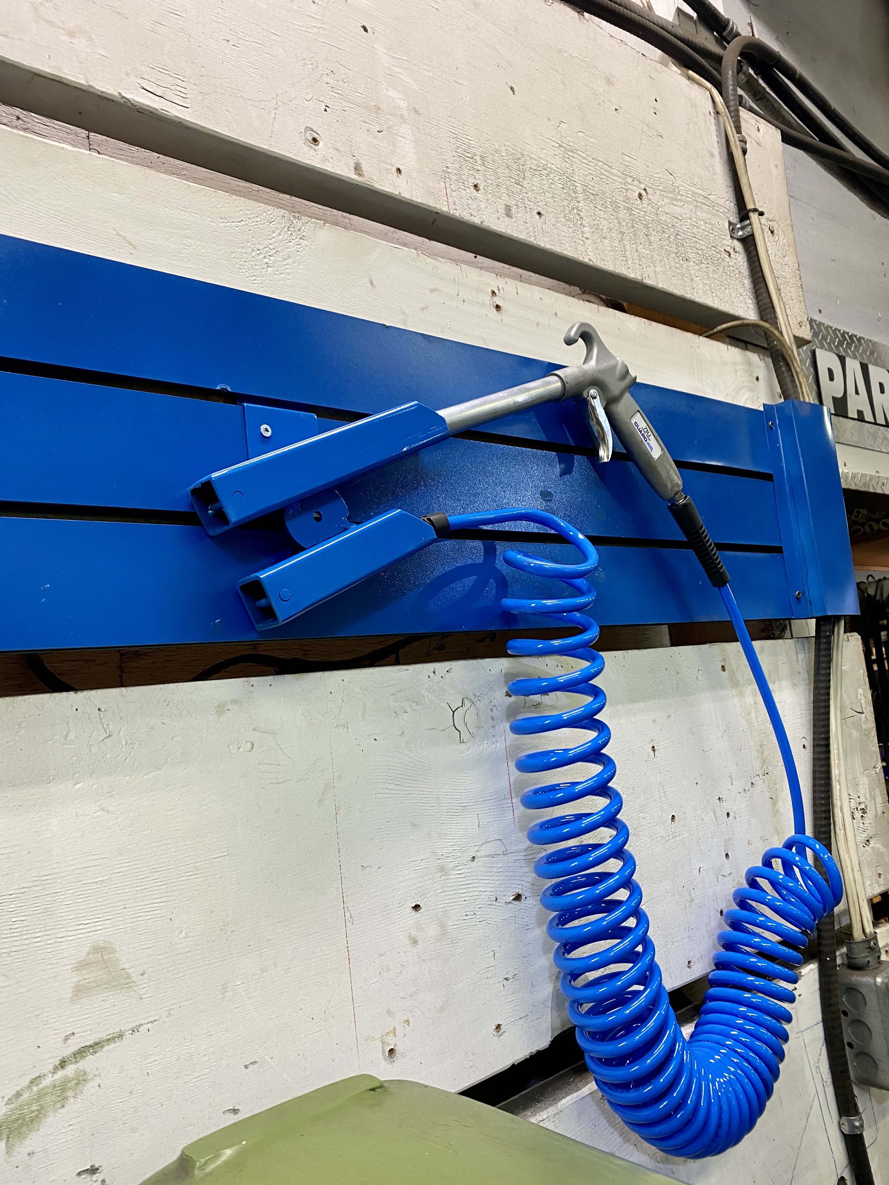

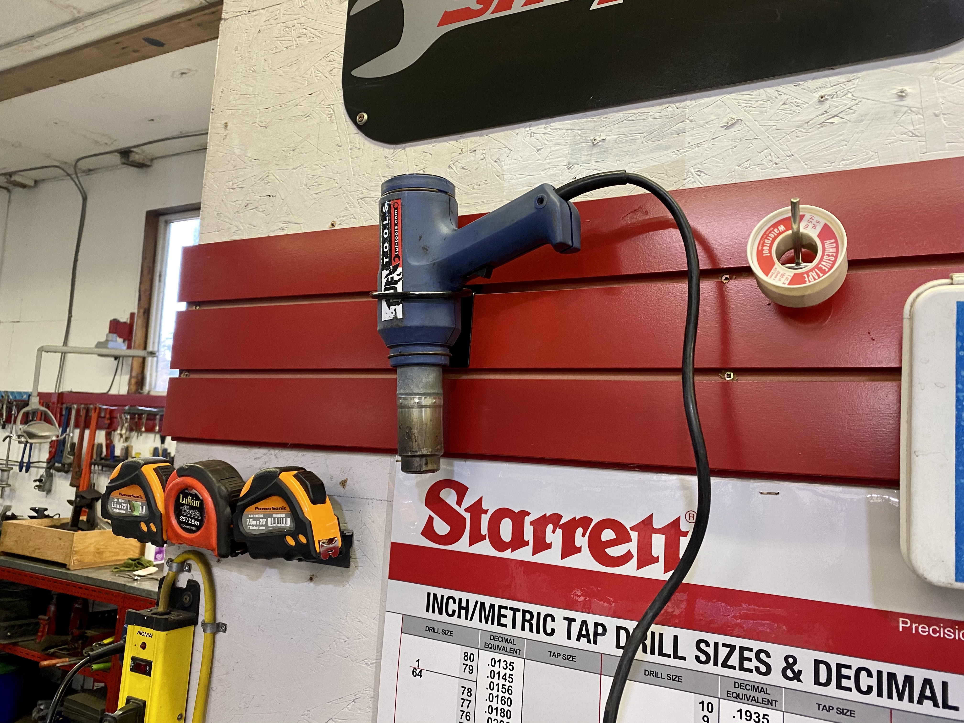

Custom hooks for those of you who use slatwall..

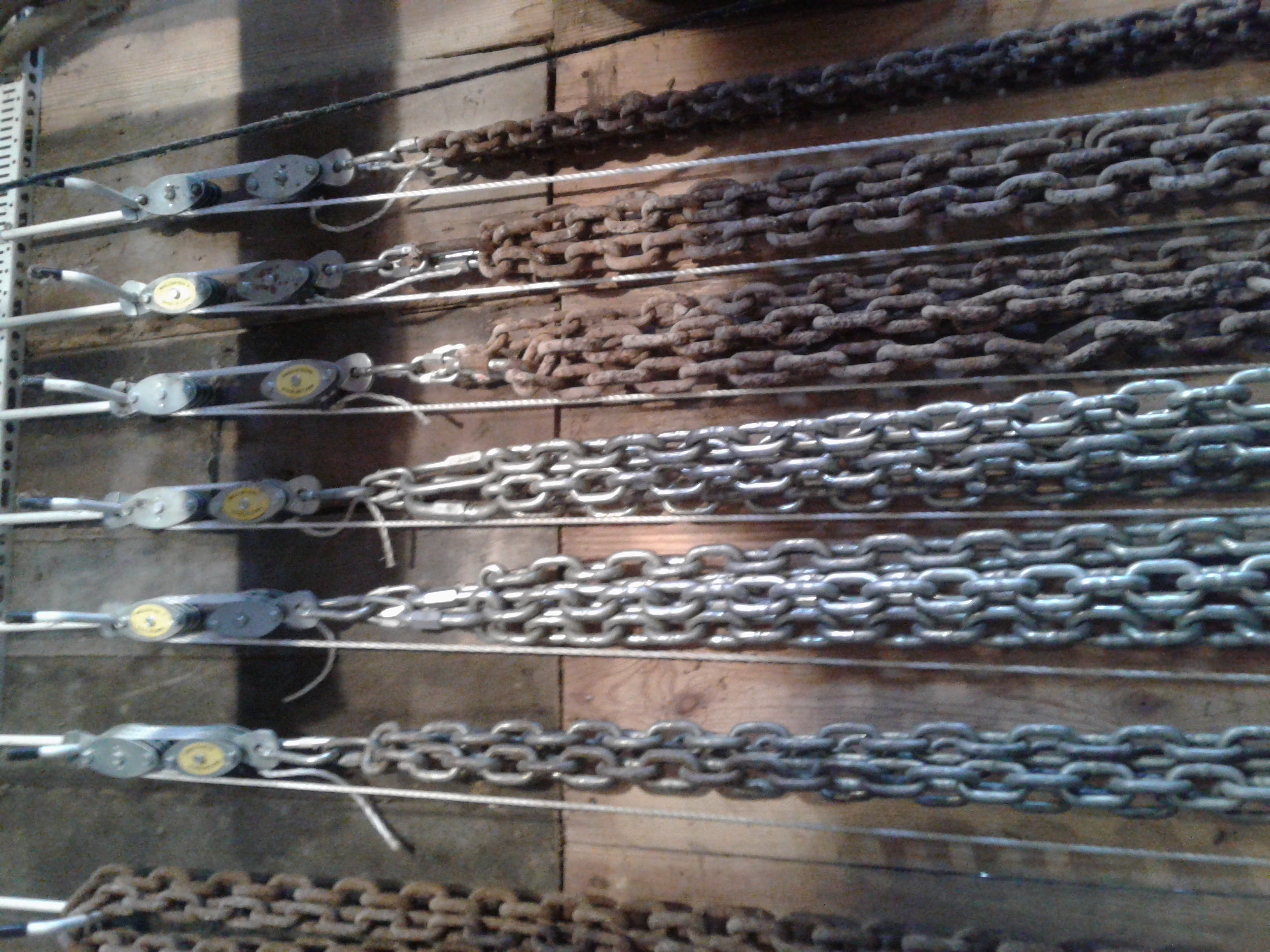

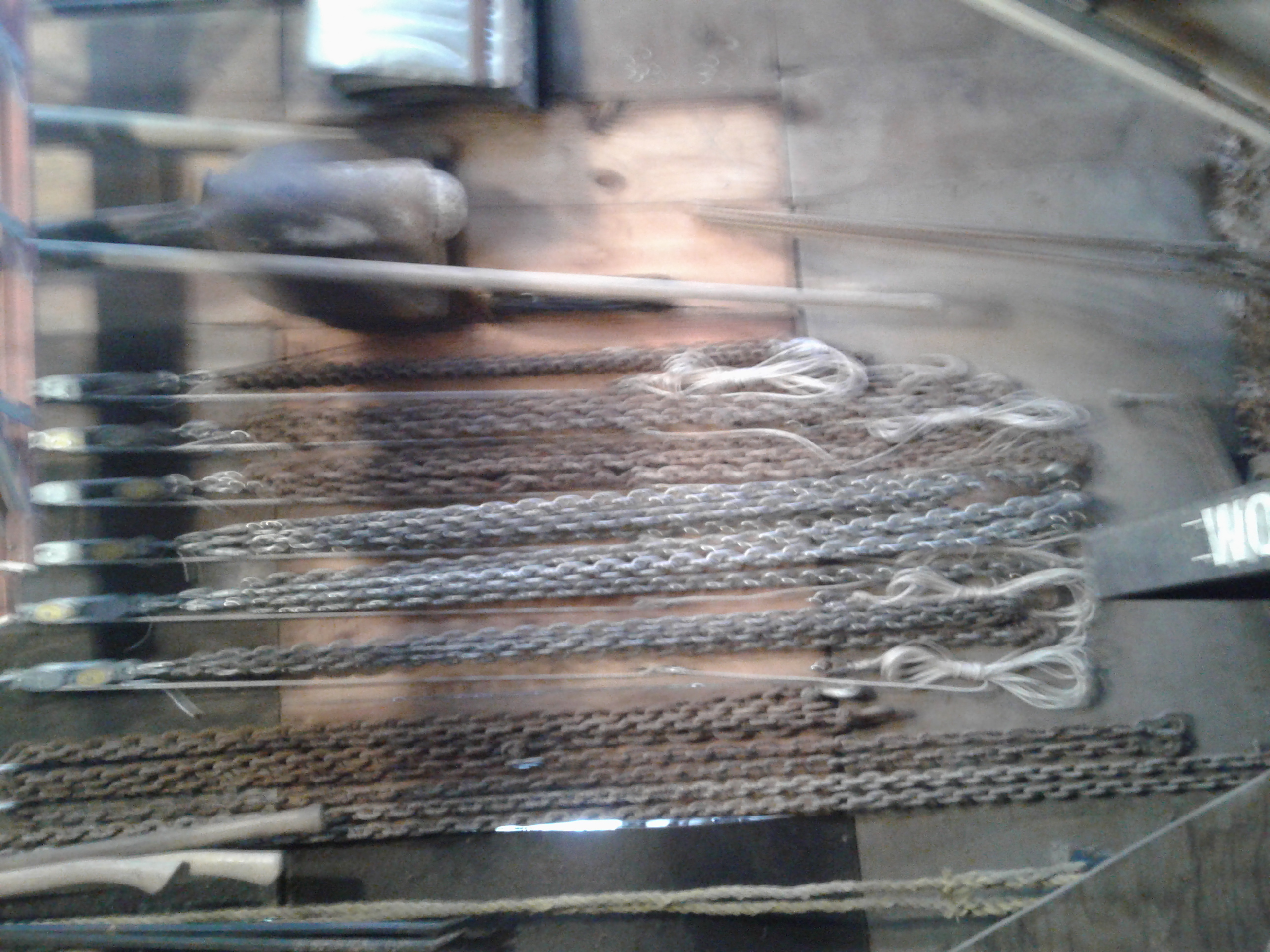

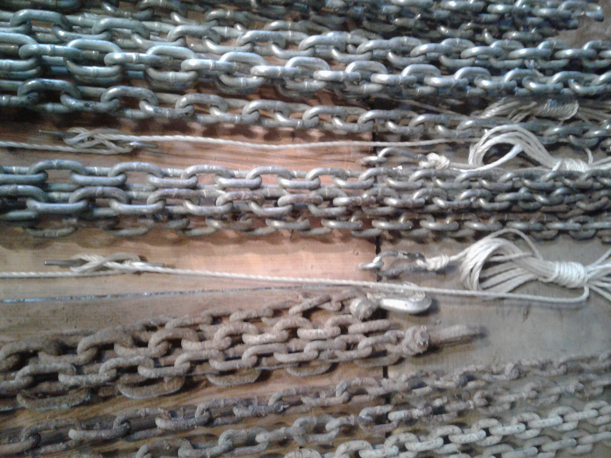

Chain storage idea
Harbor Freight and hunting departments sell small block and tackle sets for field dressing large game. 6 to 1 mechanical advantage, 10# of pull to lift 60# chain.
Chain prep: grab both hooks drag chain until straight. Now drag hooks back to center point. Opposite end is the 1/4 and 3/4 points. Install quick links here, they will be the lift points for the hoist. Some additional hardware for rope storage.
Chains don't get tangled, take longer to rust.

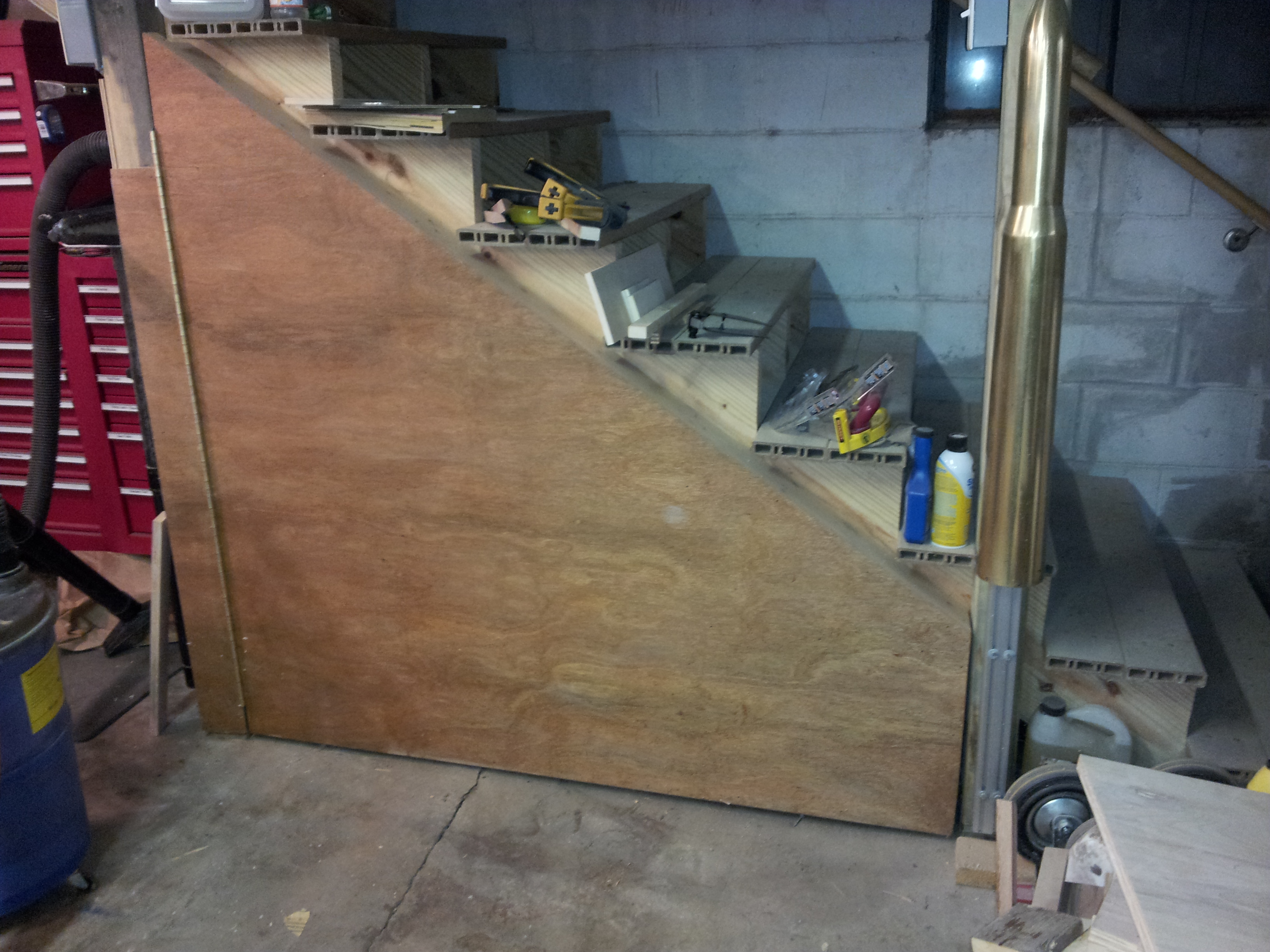

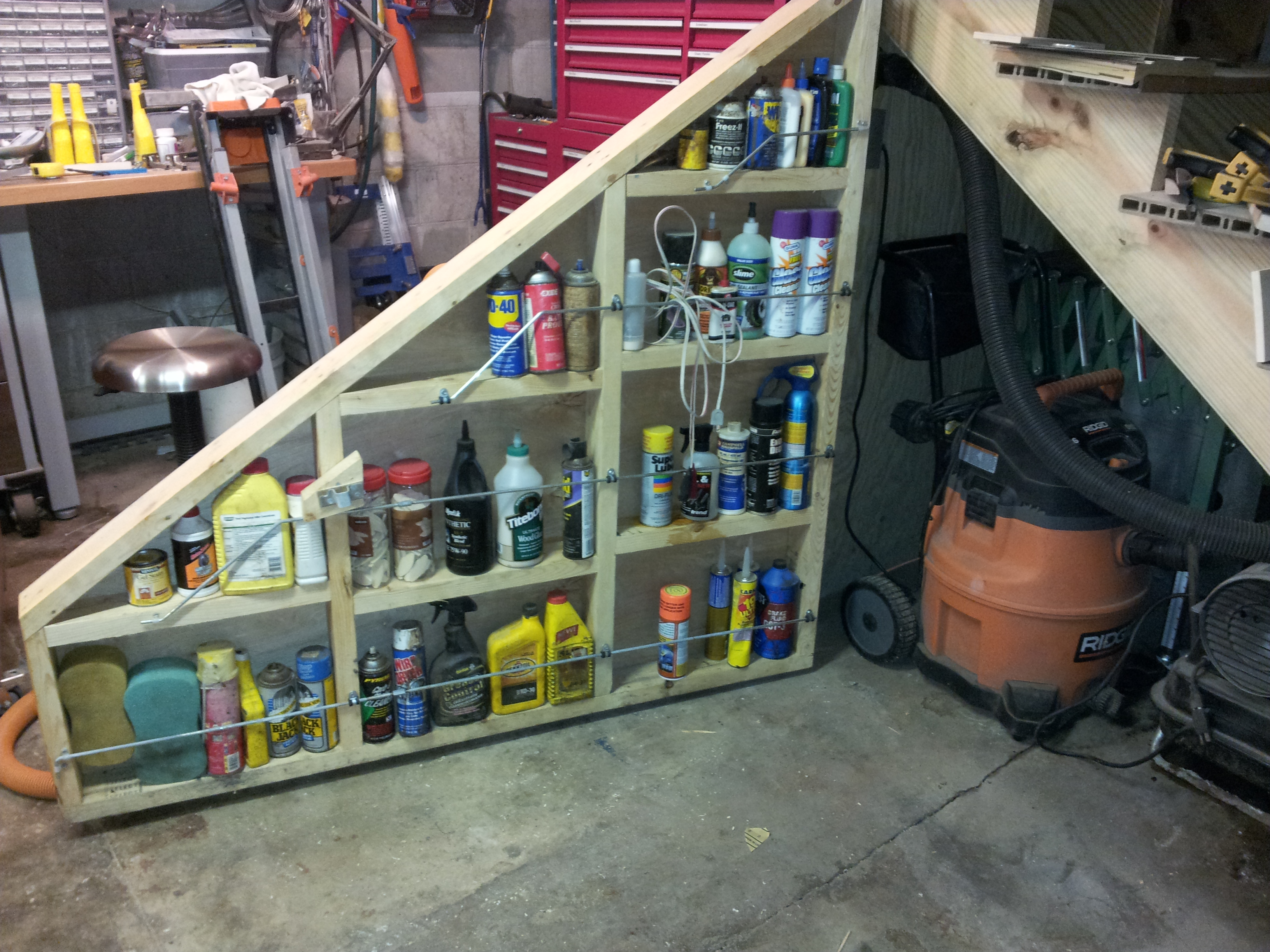

Homemade heavy duty hinge A.K.A. Mother of Piano Hinges
Bought 1/4" spring steel piano wire from hobby shop, 12 hinges from Menards. Removed hinge pins, ran 1/4" drill thru hinge parts, reassembled on 4' piano wires.
96 wood screws later, have large under stairs door for chemical storage. No problems in 16 years.

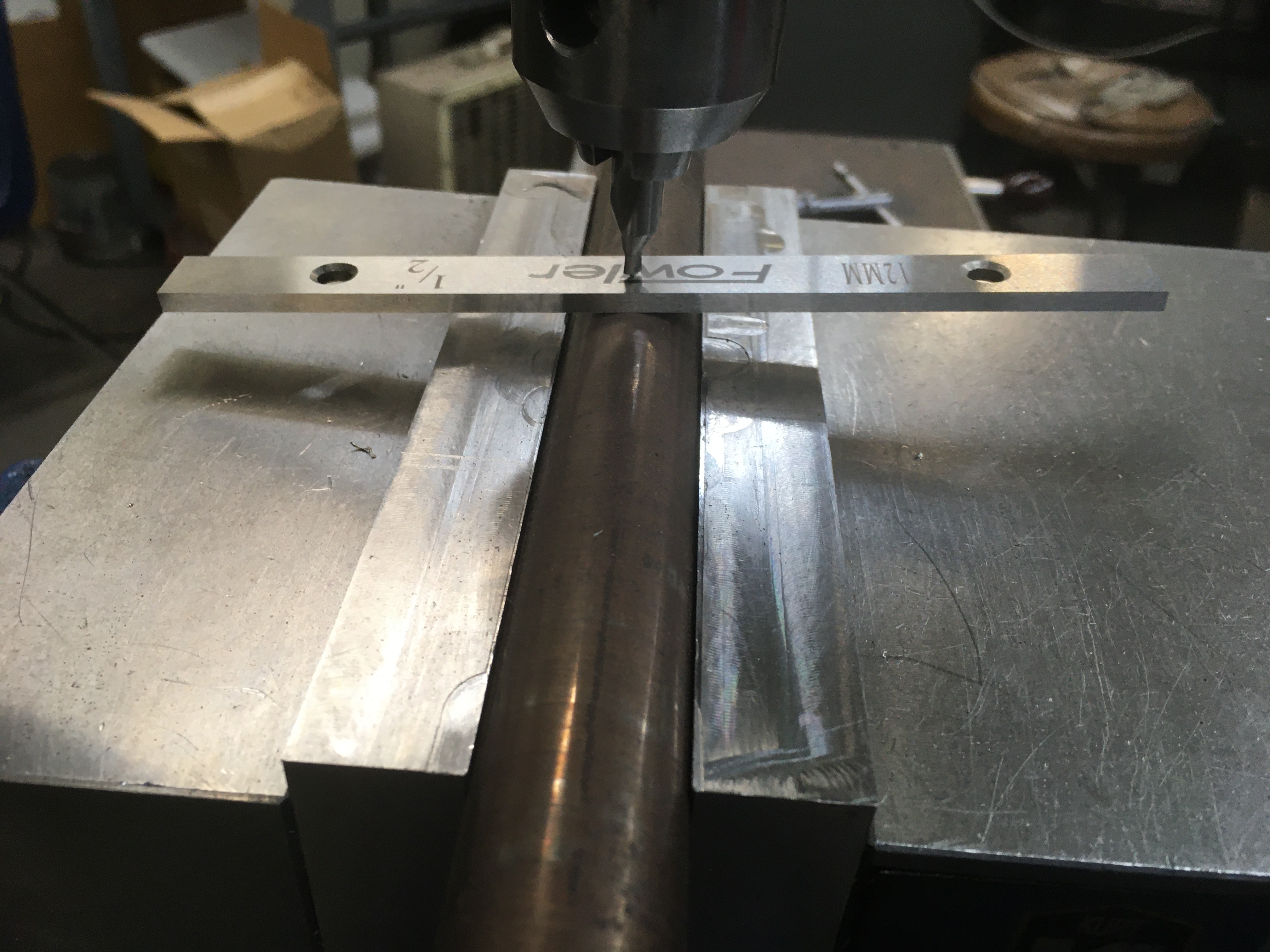

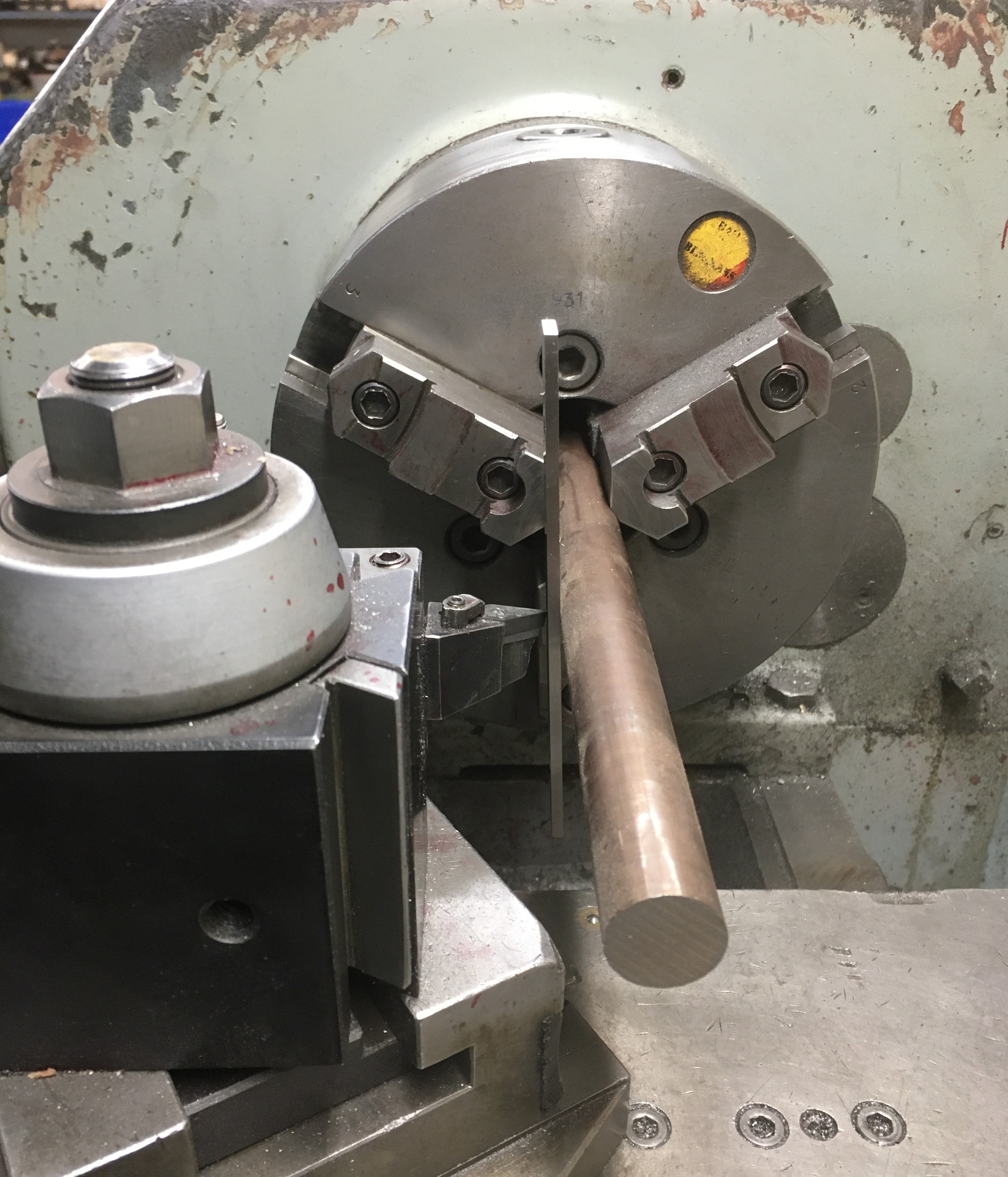

Most probably know this already but if you are needing to find the center of round stock to drill a hole, the quickest way I have found is to use a ruler or something straight on top of the round stock, then place the drill bit on top of the ruler. As the material is moved back and forth, the ruler will rock from side to side accordingly. Once the ruler is straight you are in the center of the material, or at least close enough for most purposes. The same can be done on a lathe to get the cutting bit in center.
