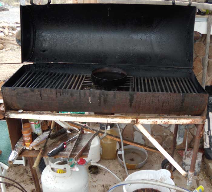

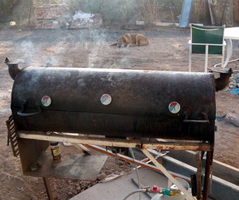

Here are some pictures of the smoker I built about 4 years ago. It will last a lot longer than I will. A simple & fun project. Also good for a novice welder to sharpen up his / her skills. It has smoked a turkey & ham at the same time, even had some room left over.
Old hot water tank, hinges, 4" pipe, 2 elbows, a little 1/8" sheet metal, some pipe and odds & ends. The burner that I used is too large and hard to turn down enough. Going to play with a burner out of a hot water tank. The 3 gauges came from Ebay and were pretty cheap.
Basically the burner gets the wood and charcoal hot then gets turned off or as low as it will go. You don't have to have a burner, its just nice to get everything hot and smoking.
Fish do not take very long to smoke at 225 degrees and come out real good. Roasts & turkeys take 4 to 6 hours.
