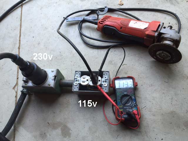

I have a strange situation, see if I can explain it. I changed my 4-wire outlet to 3-wire (in another (thread). It runs the welder just fine on 230v. I bought a large 50-foot extension cord for $25 and then configured the outlets how I wanted (as in the pic).
Here it shows 113.3v. If I pull the trigger on the angle grinder the volts goes to zero (~230mV) The generator will NOT run a 115v tool on the duplex outlet (off one of the legs). Does anybody know why?

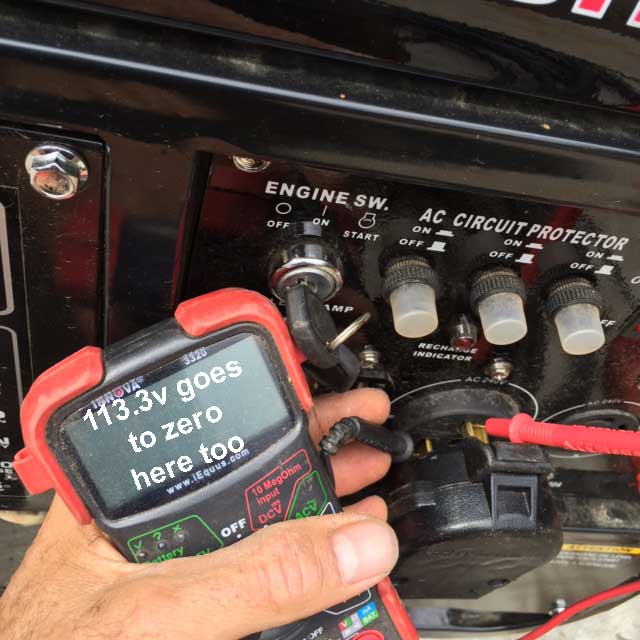

I thought it might be a bad conductor in the cord but if I measure the voltage directly at the outlet (the same leg) it goes to ~zero (leg to ground) the same as it does out at the extension duplex. If I measure the other leg it goes to 230v (leg to ground).
440253d1441776480-smokin-deal-10-000watt-generator-xp10000e_duplex_problem2-jpg
It seems this generator objects to an imbalance in draws from each leg.

do you have 230v across both hots? and 115 from each hot to ground, and each hot to neutral? ( is that a 4 prong plug.. I can't see on my phone ). If you changed any outlets.. did you hook neutral back up? if not.. you could just have 230v, hot to hot...

Yes yes yes, but 3 wires, no neutral.

Is this a floating neutral or bonded neutral generator . There is much confusion out there about what ground is, what neutral is and what each is supposed to do.

if it is not bonded neutral, that may be the issue.
it may have a safety ground, and 230v hot to hot, but may not have 115 h - n
   / Smokin' deal on 10,000watt generator $649 (Today only) #78
Has it been tried using just one hot and the neutral?
my smaller 5500 watt gen does not have earth ground tied to neutral internally in the gen set, the green ground is only supplied by physically supplying an earth ground.
Sounds like you have the no neutral being supplied to the neutral wire in your 120 volt extension cord?
EDIT- Just as Soundguy alluded to- got to have a neutral to complete 120 volt circuits Glad it is functional

It has 115v betw hot-to-ground, but won't put any power thru that circuit. Not using the neutral wire, it's isolated.
I think your on it. It had a 4-wire outlet, I used only 3 wires (Hot-Hot-Ground) Green/Y goes to the eqpt frame. (I isolated the gray(neutral) ). Heres a pic from the other thread.
414830d1425421269-need-220vac-electrical-help-change-img_0203-jpg
Want to get the duplex (115v) outlets on the end to work. Is this problem because the neutral is isolated, but should be grounded?
