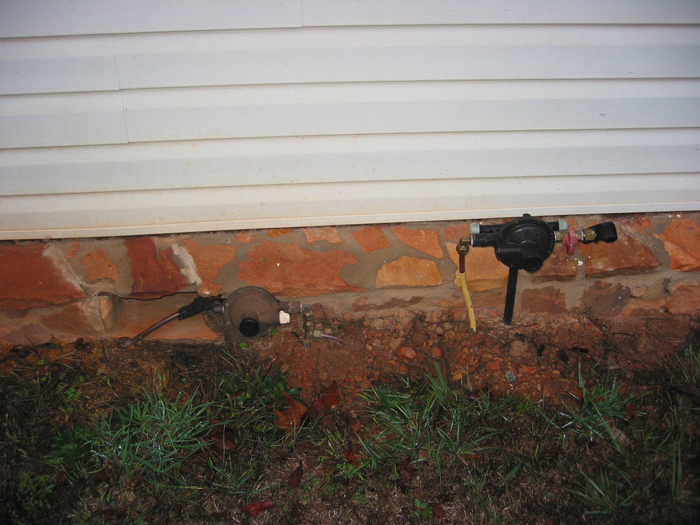

My setup seems to be exactly like yours, i.e. high presure regulator at the tank, copper line to the house to another regulator. The LPG tech needed to T off of the house supply regulator to a low pressure regulator for the generator. I think he set the generator regulator at 12 pounds. Here's a picture of how mine is rigged:
The cross pipe in back of the new regulator is for a brace only and has no other purpose. Also as an aside, I asked the LPG deliver guy last December if this setup was possible. They said sure, but advised me to place my request in April or May after the winter rush passed and they were sitting around looking for something to do. Otherwise, the price would have be higher.
With this setup I have a heavy duty 6 ga extension cord to run to my water pumps and transfer box.
So far I've only used propane in my generator. I hope to be able to continue with that system, but I do have a gasoline supply just in case.

Would be so kind as to show or explain how it was connected to the generator when it does happen? I have the regulator like yours for my grill I want to tap off of but the final hook-up is a concern.

I don't have my generator out by the connection right now, but in the interim, the black regulator on the right has the same connector fitting as the propane bottles. It has a dust cap on it right now just to keep it clean, but it's the same fitting that the bottles have. The generator just plugs right into that line same as with a bottle of LPG via a little pigtail that came with the generator.
I did buy a 15' LPG extension hose from HF that could also be used if I didn't want to sit the generator that close to the house. The hose was bought primarily for my weed burner, but it's plenty large for the generator.
