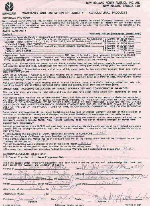

Murph, I am attaching a copy of the New Holland Warranty for all tractors and agricultural equipment. When I bought my tractor, this document was explained to me in detail by my dealer. We went over every point and limitation. At the bottom of the document there is a block for reassignment of the warranty and then the signature blocks at the bottom. My dealer wanted me to understand every detail of the warranty, but it may just be that everyone doesn't get as good a job of explaining things as my dealer did for me.
Here is where to look and what to look for:
Under "Basic Warranty, Product," notice the second and third lines are for Compact Tractors. The basic warranty is 24 months/2000 hr, but there is a sub-paragraph only for Compacts that is an "extended powertrain warranty" for a period of 12 months. That is the engine, transmission, main drive axles and auxiliary drive axle. Therefore the total warranty time on your powertrain is 36 months. /forums/images/graemlins/grin.gif
Is that cool or what? /forums/images/graemlins/cool.gif TCs have the best warranty of all New Holland tractors. /forums/images/graemlins/smile.gif
So Murph, I just wanted to post this so not only you, but everyone who has a question can see the actual documentation and not just "oral history."
Would it make you happy to find out you actually have even more years of warranty on just your engine? Would 5 years and 3000 hours get your interest? Well, just read my next post and see if it doesn't give you a warm feeling for the ol' EPA. /forums/images/graemlins/shocked.gif Seriously! I think you are gonna be surprised. /forums/images/graemlins/cool.gif

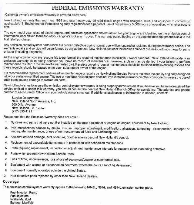

So what did the "stinking government" ever do for me? /forums/images/graemlins/mad.gif
What possible good could come out of the EPA? /forums/images/graemlins/tongue.gif
Check out the attachment. /forums/images/graemlins/cool.gif It's page 0-1 from my TC Operator's Manual. Have you read that part of your book, or did you just skip right over it? /forums/images/graemlins/smirk.gif
My engine is guaranteed to meet EPA emission standards for a period of 5 years. This warranty covers fuel injection pump, fuel injectors, intake manifold, and exhaust manifold. Paragraph three is my favorite. I almost have it memorized. /forums/images/graemlins/blush.gif ...just kidding. /forums/images/graemlins/smile.gif
"Any emission control system parts which are proven defective during normal use will be repaired or replaced during the warranty period. The warranty repairs and service will be performed by any authorized New Holland dealer at the dealer's place of business, <font color="blue"> with no charge for parts or labor (including diagnosis) </font> ."
They even provide an address to write and phone number to call if you think the warranty is not being administered properly.
So what is the emission standard? Well, that's not as easy to find. If might be in my Repair Manual, I'll check. Notice at the bottom of the page the Class III engines are called out: N843L, N844, and N844L. Surely, all other classes have the same warranty, but probably have slightly different standards.
So if your tractor coughs, spits, sputters, smokes, and generally makes you miserable, it may not be meeting EPA emission standards. If so, you have a warranty to protect you and you should use it.
I hope I have been helpful to everyone on this issue. We pay good prices for our tractors and we should expect them to work well. /forums/images/graemlins/cool.gif /forums/images/graemlins/smile.gif
