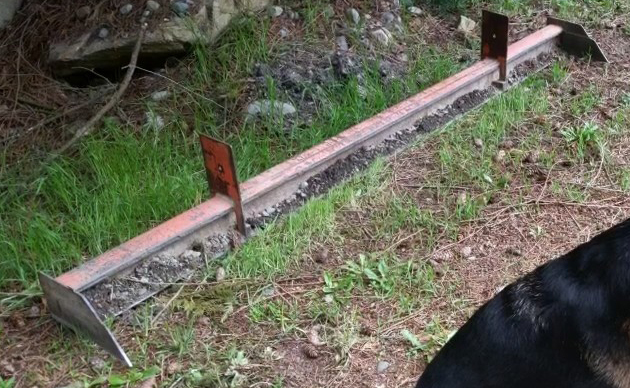

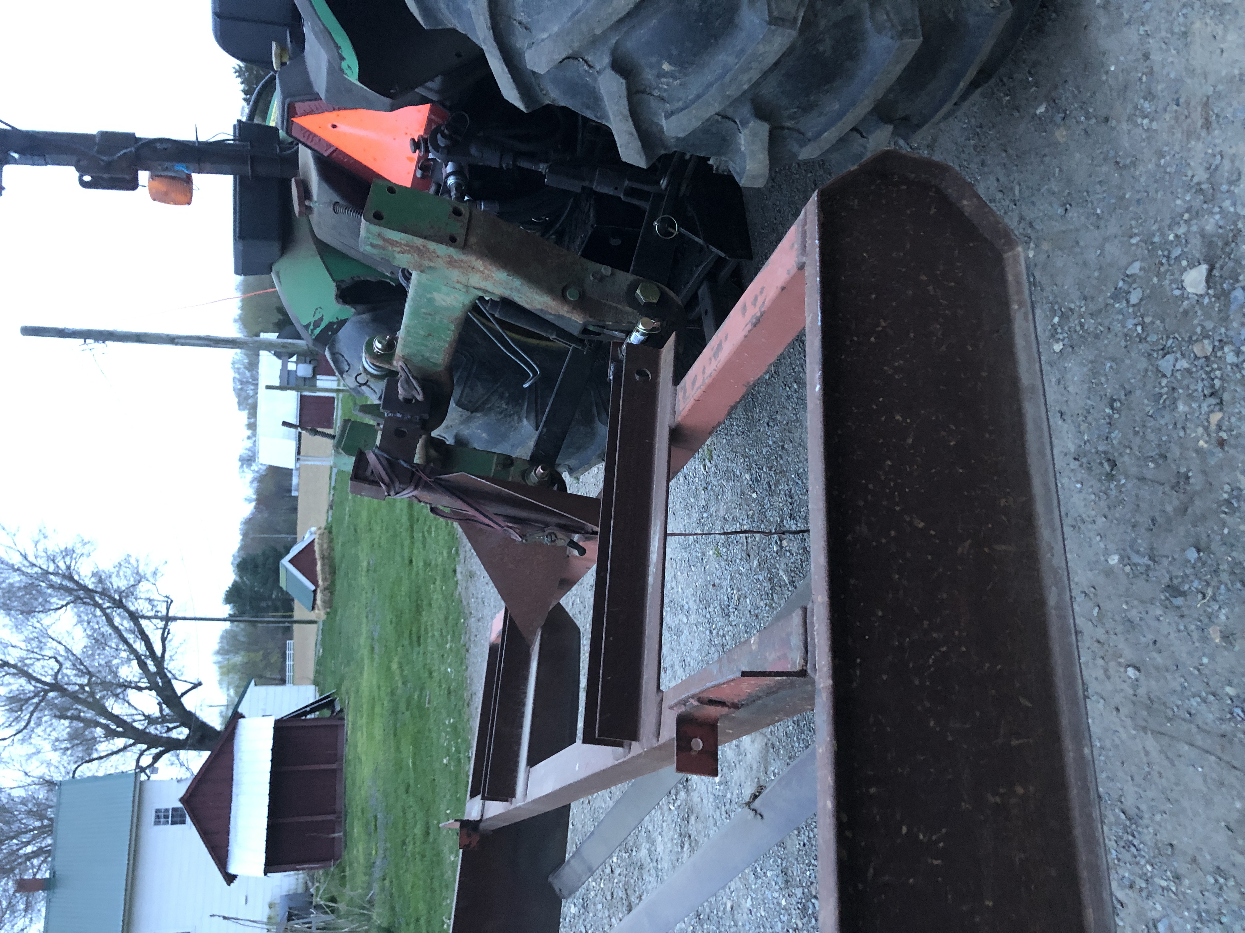

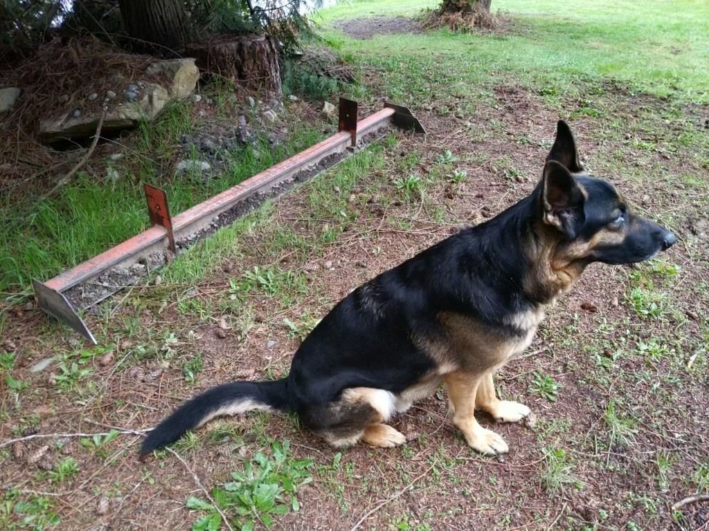

The rail weighs 200 lbs added to the 400 lb box scraper. I have since added end plates to the rail to control spillage over the ends of the rail that tends to create brems at the edge of the driveways.

#13
The only problem with perpendicular anything, is that it ejects material out the sides, and off your driveway.
If you weld some oversize end plates onto the rails that should hold the gravel in front and under the rails instead of spilling over the ends ;) I had the same problem until I did that.

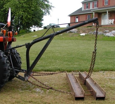

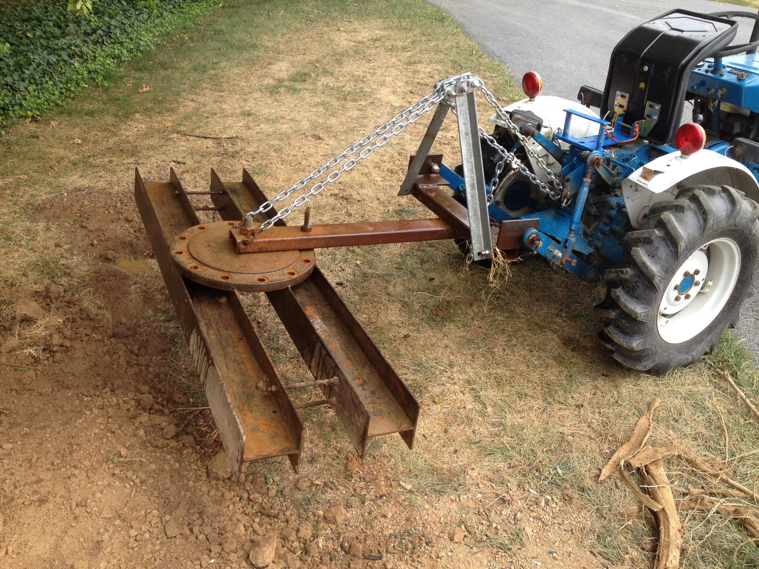

Since we paved our driveway years ago, this doesn't see much use. Every now and then it does come in handy. The original design used the boom pole for lifting and it was a bit cumbersome. Angling was done by shortening the chain on one side or the other.
A few years ago i discovered an old pipe flange out behind the shop and did some mods so the boom pole wasn't required.
Love the ingenuity with the pipe flange. That great thinking out of the box.

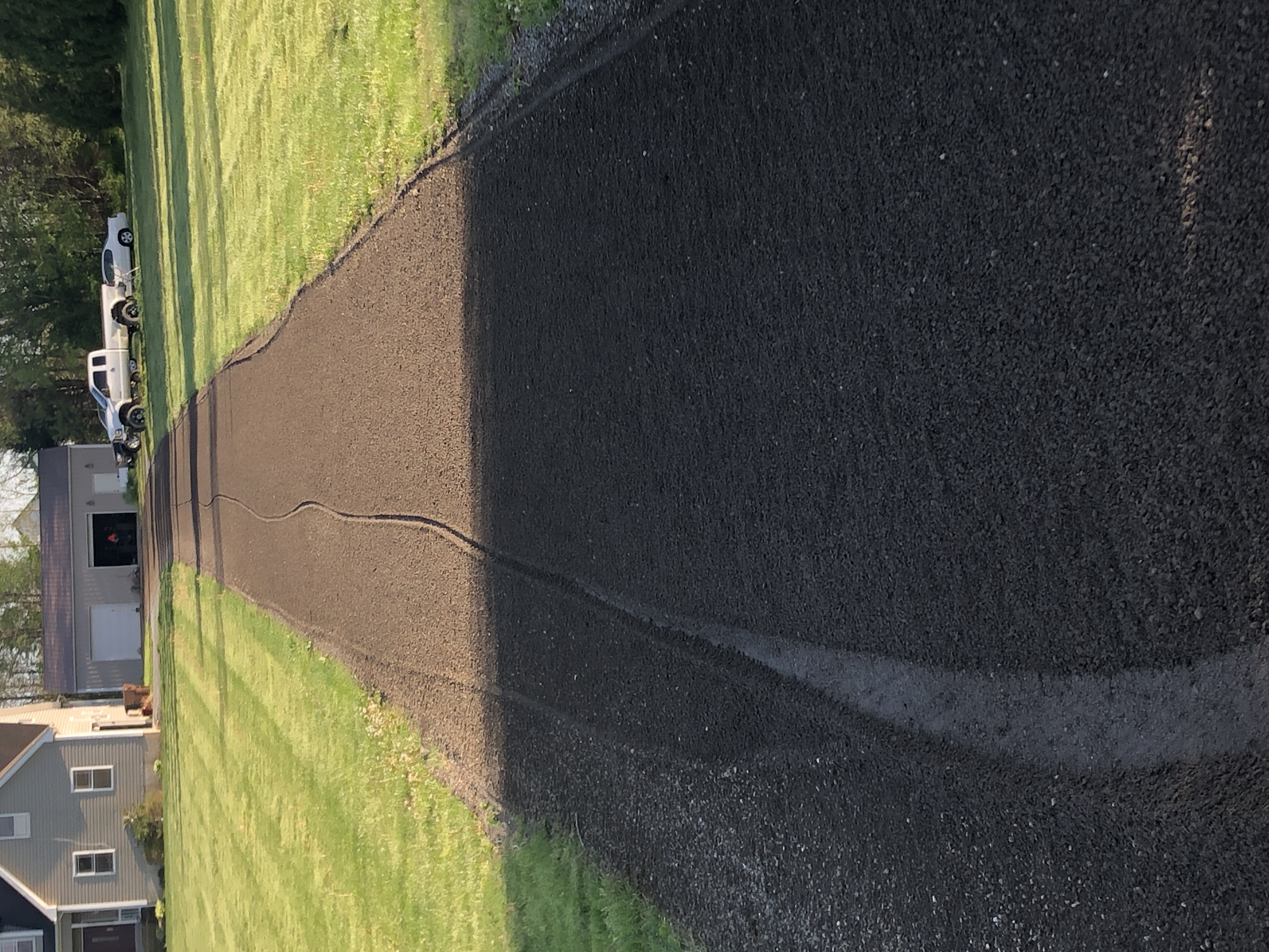

if you can find a land plane/ gravel grader get one - its a must have for gravel driveways. Here is some millings I spread the other day- don't mind the rut - i had a chain dragging and didn't realize it - it was totally smooth when done just didn't get a pic
