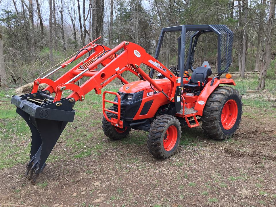

I received the Spartan stump bucket. So far I like it. Went out and plucked out one small stump (about 5 inches) just because I felt I just had to use it. shoved a tooth right between two roots and under the stump and pried it up in one motion utilizing the leverage from the built in pivot point. A key thing is that the bottom is the same width front to back so it will go into the ground easier than one that is shaped like a pyramid (I don't understand why the pyramid design exists)!
I don't have problems with visibility like others mentioned. I can precisely place each tooth. Construction is plenty heavy for my use (not as heavy as some). The sides are 3/8". The bottom and back are 3/16" with 3/8" reinforcement strips underneath the bottom. The cutting edge is 3/4". The teeth are much larger than a standard tooth bar and look like they could take a lot of abuse.
The welds are a little disappointing. The bottom and back is welded from the inside (good) but not from the outside it doesn't look like the weld goes all the way through. I may have some additional welding done on it from the outside just to make sure it's good to go before I tear up my concrete porch. (it's light concrete ~2" thick and I haven't seen any rebar in the spots what are worn and cracked)
Below is a picture on my tractor. If nothing else these things look mean! :D

Good deal! It looks like it is sized right for your tractor. :thumbsup:
The teeth are bucket teeth for construction equipment. They come in different sizes and styles, so write down any brand or numbers on them, in case Spartan ever goes out of business and you need a replacement tooth.

The professional series is for machines 5000 pounds or less. This worried me a little before I saw it. I talked to someone on the phone, told them my machines weight with loader and filled tires and they recommended the industrial because they didn't think I could hurt that one. I commented that if I did something stupid with the industrial one I could pop my curl cylinders because it's three times as long as the bucket my curl cylinders were designed for. They understood my concern and said that they didn't think I'd hurt the professional series as long as I wasn't ripping up sidewalks with rebar. After I had it in front of me I realized there was just about no way I would ever damage this thing other than popping a weld if it happened to have a bad weld. I think it is well matched to my machines size. Robust enough, but not unnecessarily heavy.
Incidentally I did a test for the curl cylinders that make me think I did get the right length. I dumped the bucked so it was straight down with the tip buried in the ground. I put the tractor in 4WD 1st gear at idle (0.4 mph). I let out the clutch and tried to curl the bucket. The tractor didn't move the curl cylinders didn't move. I was hitting the relief valve but the tractor couldn't extend the cylinders anymore than they were with the valve open. I was actually expecting the cylinders pull the bucket back more and extend the cylinders but it didn't happen. So this means that with this length bucket, I'm unlikely to ever hurt the loader even if I slowly run into a huge underground rock with the valve closed and bucket pointed straight down. In that scenario pressure in the cylinders is unlikely to go much over normal operating pressures before the wheels spin, so well below what would hurt anything. With a longer bucket I'll guessing the tractor could have pushed forward and extended the curl cylinders more and I would have needed to be very careful with it.
