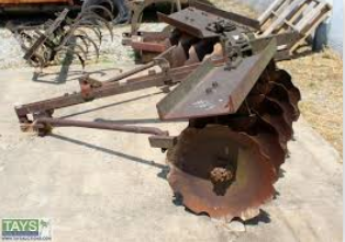

I'll say it again, a Bog Disc would be my weapon of choice. It is not just a bigger disc. It is a HEAVY disc with large blades on steroids and testosterone. It is designed to chop and penetrate. It would serve you well if you can find one.
