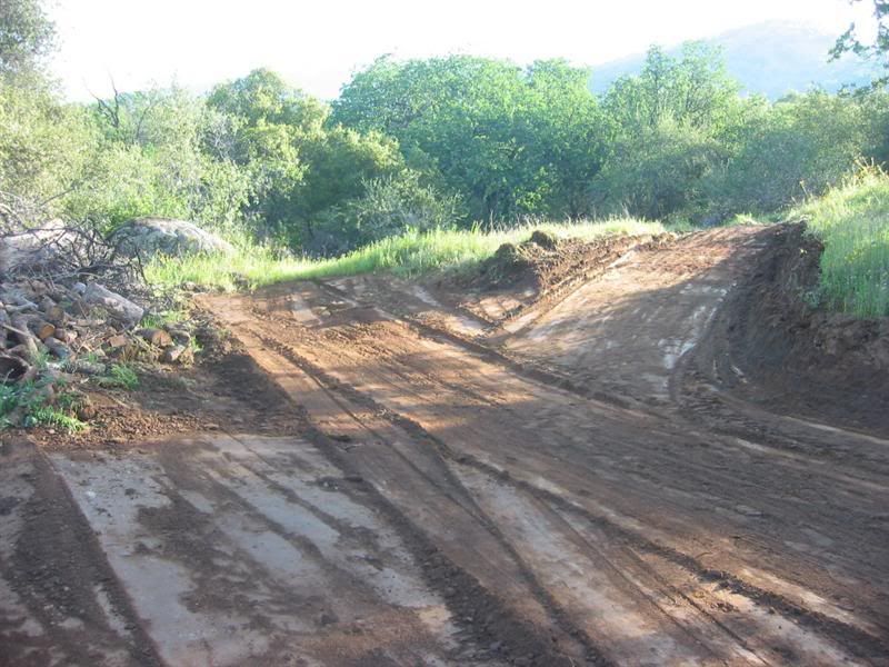

It's a lot better than what I had to work with. I'd do like a couple fellas told you. If you already have the box blade, put the rippers all the way down and drag it behind your tractor. Don't sink the teeth all the way in though ... suspend the boxblade so only about 4" or rippers go into the ground. That will allow the rippers to work without moving any dirt. It does a couple things for you. First, it busts up the hard surface and will mix the soil a little. It will also pop out any rocks so you can get them out of there. Ripping like that with a suspended boxblade will also naturally move a little dirt from high spots to lower spots. It also softens up the area so you can then drag dirt either with the box blade or use the fel bucket to level and smooth it better. Then get yourself some compost to spread over the area and till it in. You won't have to worry much about the rocks you've already removed.
It just takes a little tlc and time.
BTW, you CAN get pretty good with the boxblade and really get things level after a lot of practice. Here's a 100" x 200' pad for my barn I did with only the boxblade, much in the manner I described (except no tilling).
I got it pretty flat.
Rob-

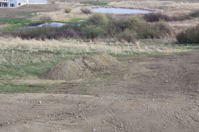

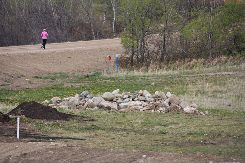

Well that job is done, maybe not well done, but done. Sorry for not updating sooner but it's been busy.
The earlier pictures did not really show the terrain well, I should have waited for the sun to be in a different position. I started out with the box blade, but with some of the dips and hills being over 4 feet it was tricky in some areas. But it did bring out a lot of rocks. Then I borrowed a discer and tried that.
After loosening things up a bit I moved alot of the covering clay into a pile. This pile will be moved to the top of the hill next to the house. In some areas I got right down to the topsoil, other areas probably had a foot of clay on top. In the end the contour of the hill is nice. A lot of stone removal, and I'm not done yet. Largest stone being about 3x4 feet, dozens of 2'+. I'm sure I will use those in another project in the years to come.
Then I tilled to mix everything up, that was hard on the tiller and of course found some new big rocks. Last I pulled a large piece of railroad track around with the quad, and that found a few thousand more rocks. **** rocks.
After seeing what some of you can do with a box blade I am determined to get better with it.
Thanks for all your suggestions, it is greatly appreciated.
Next project a 6' x 25' retaining wall with a staircase.

The area looks good. If you want to go one step further removing rocks, rent a skid steer with a landscape rake (rock hound). I have used them a couple of times in the past with fantastic results. I just used one again this past weekend to plant an area very similar to yours in rocks/soil consistency with great results. I went over the area a couple of times. The landscape rake also does a great job of smoothing the soil you have loosened.
