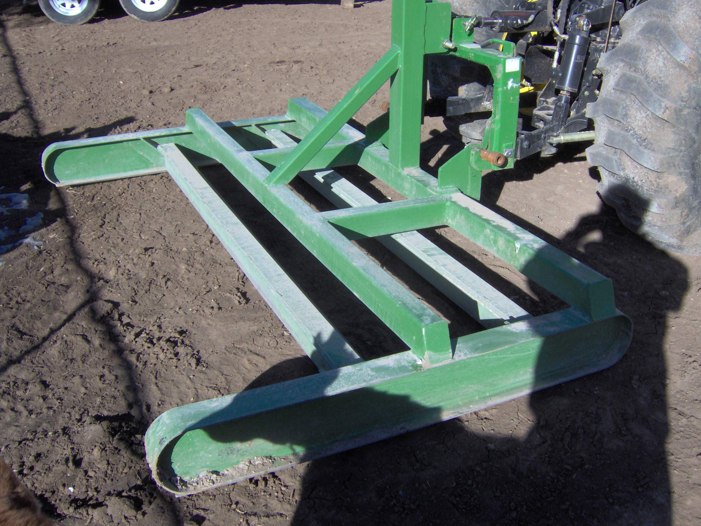

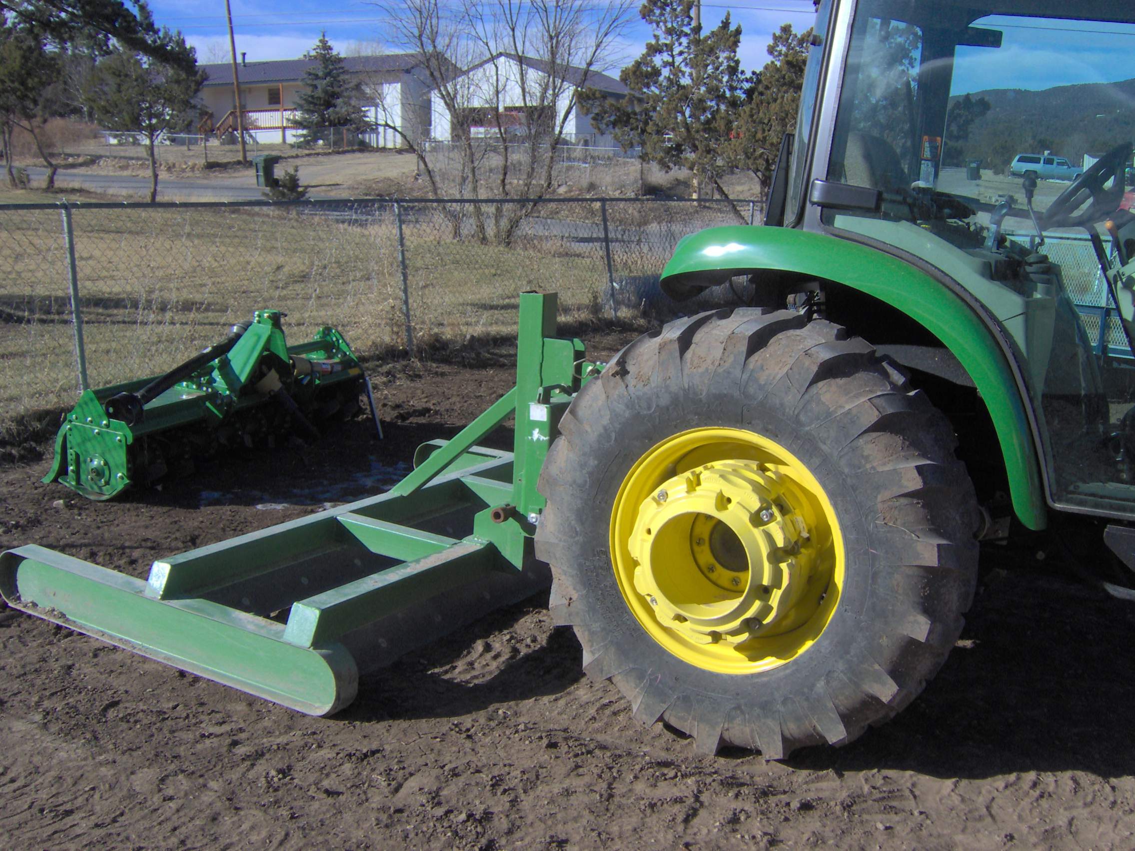

You should be able to use your boxblade and chain harrow to smooth it out. I built this landplane for my 4520 and this would work extremely well for your purpose. If you need more loose dirt to smooth with then run the disk harrow over the ground too. Here's pictures of the landplane and my rear lawn I used it on.
