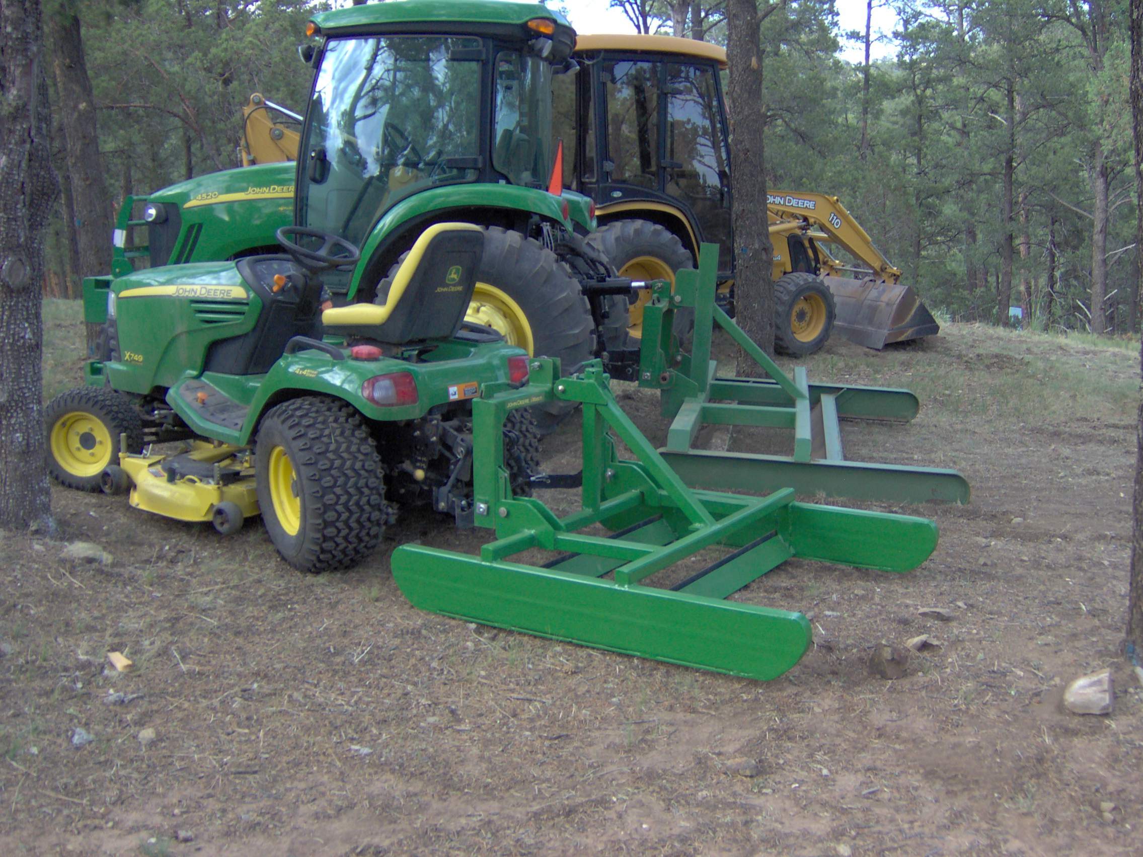

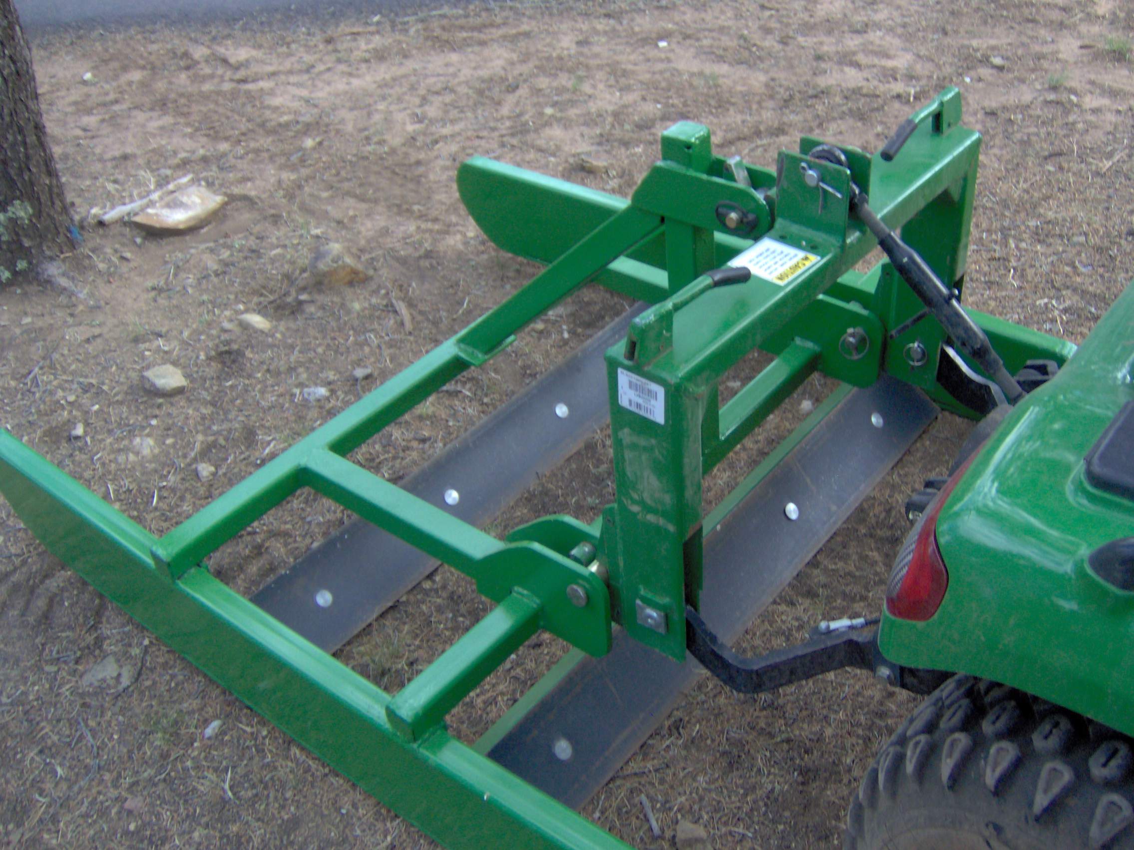

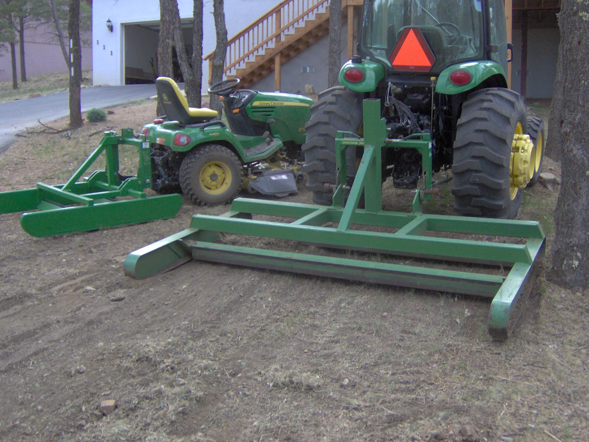

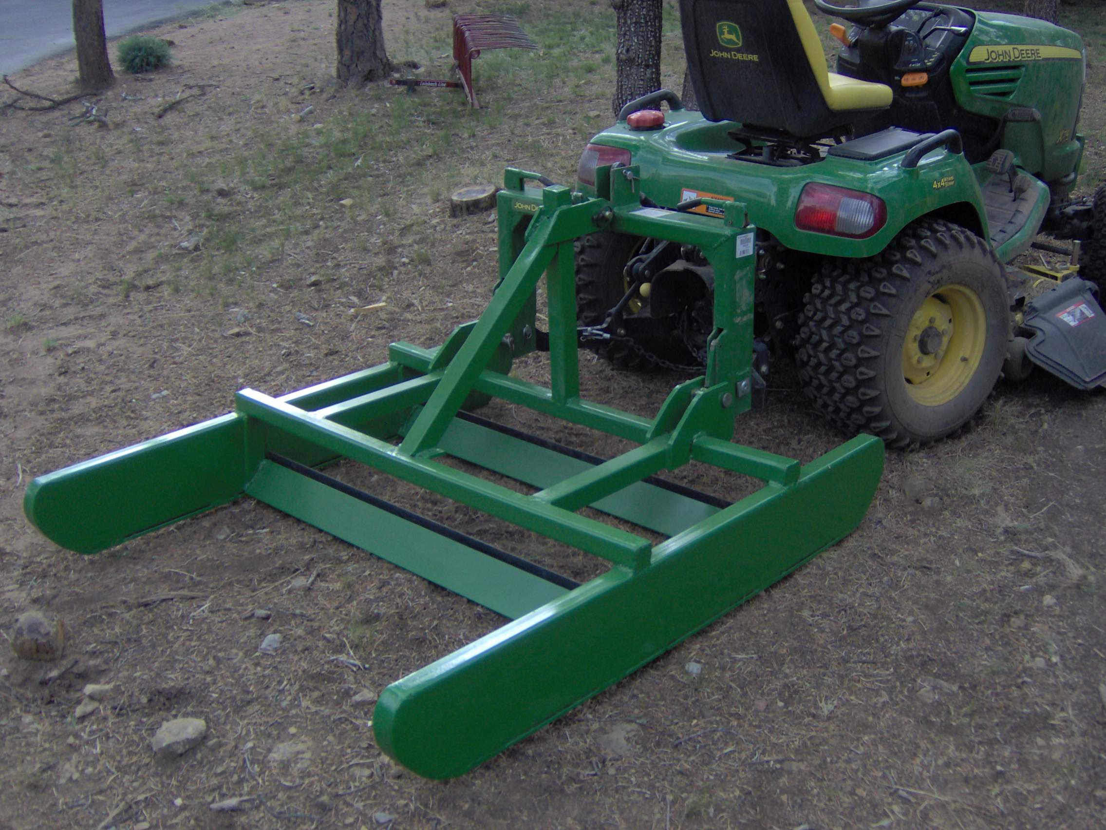

If I were going to build a landplane for your Kubota in the avatar it would be a six foot wide with six ft long skids. The skids would be 12"x3"x1/4" rectangular box tubing with a 3"x1/4" flatbar wear strip to wrap arond the bottom and close in the ends. For the frame I would use the 4"x4"x1/4" square box tubing. The blade carriers would be 5"x5"x5/8" angle iron and the blades i recommend are the double edged reversible 6"X72"X5/8". My latest build has Canadian blades and seem to be real good. The larger landplane has similar blades I purchased from the Cat dealer which are very good too. There are some additional pieces needed to attach the blade carriers to the rectangular tubing so that you can make the skids adjustable.
I use my two landplanes quite alot in my jobs and feel the rectangular box tubing works better for the skids because the rocks don't have crevices and ledges to ride on. i found that using the wide flange beams worked well enough but carry too many rocks that can easily fall off on the roads and lawns where they are not desirable. i should add that with the higher steel costs today you can buy all the blades, hitch pins, plow bolts, paint and steel for around $800 to $1,000 US. If you can scout around and find some deals on drops which is what I have done you can save some money likely get it down to $600.
Here's some pics of the 48" and 96" landplanes I built.

Thanks! I've got a source for some grader blade, I've been meaning to get some replacement edges for my rear blade anyway. I might pick up a couple more pieces while I'm there, enough to build a landplane with. As for the rest, I'll probably end up buying new steel if I can't find it at the scrap dealer near me. If I do build one it'll be a summer project, in the queue along with a QA for my loader and a dump cart for the ATV. Doesn't look like I'll get much time for golf next year;)
I hope the X749 in your picture has 4-wheel steering, if not that looks like it might have hurt!
