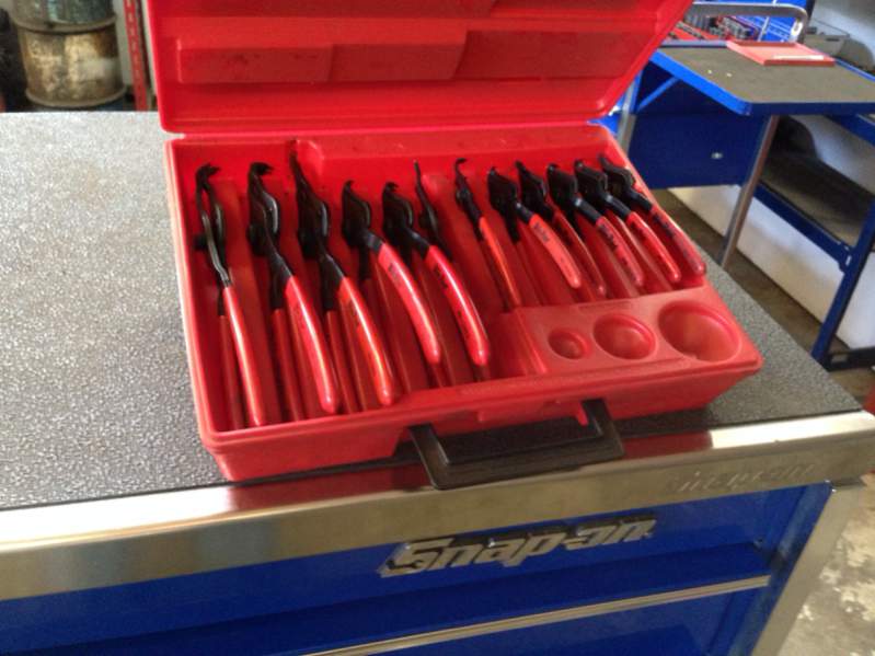

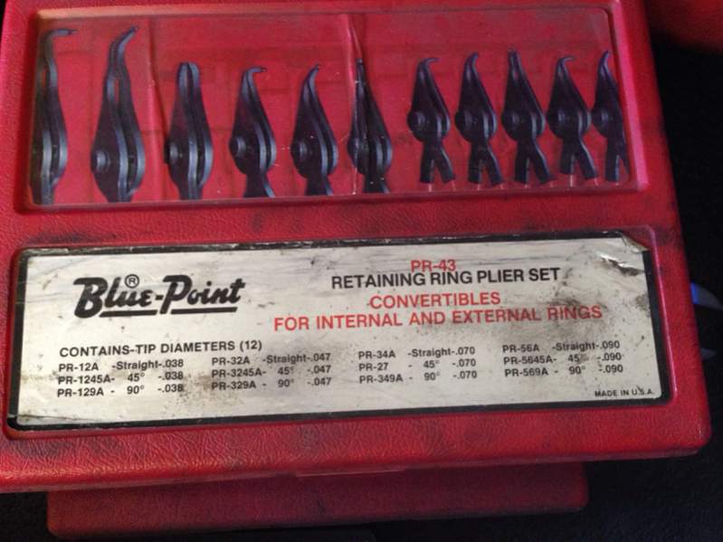

This is the set I've had on the farm since the mid 1980's.
I'm sure it paid for itself in the first couple of years.
Terry

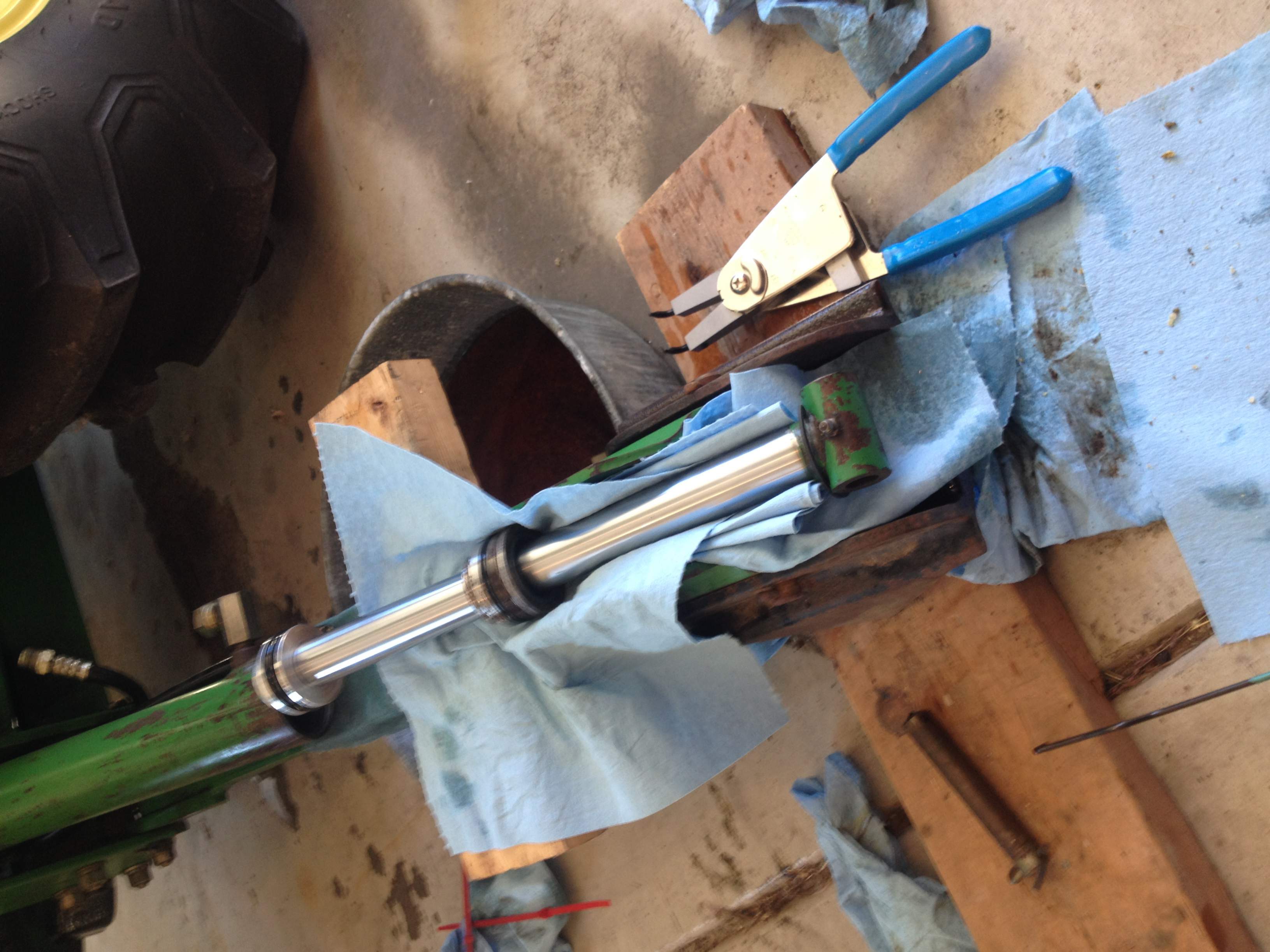

Success! I went with the Channellock 929 as a mid-priced option. Couldn't justify the Proto's for as little as I'll use them. I rebuilt one stabilizer and both swing cylinders on my backhoe and they are now leak free. Messy, dirty job but nice to have it done. The pliers were a bit clunky but worked well enough. I can see where these wouldn't be the choice for someone doing this work routinely. Thanks everyone for the suggestions on the pliers.
