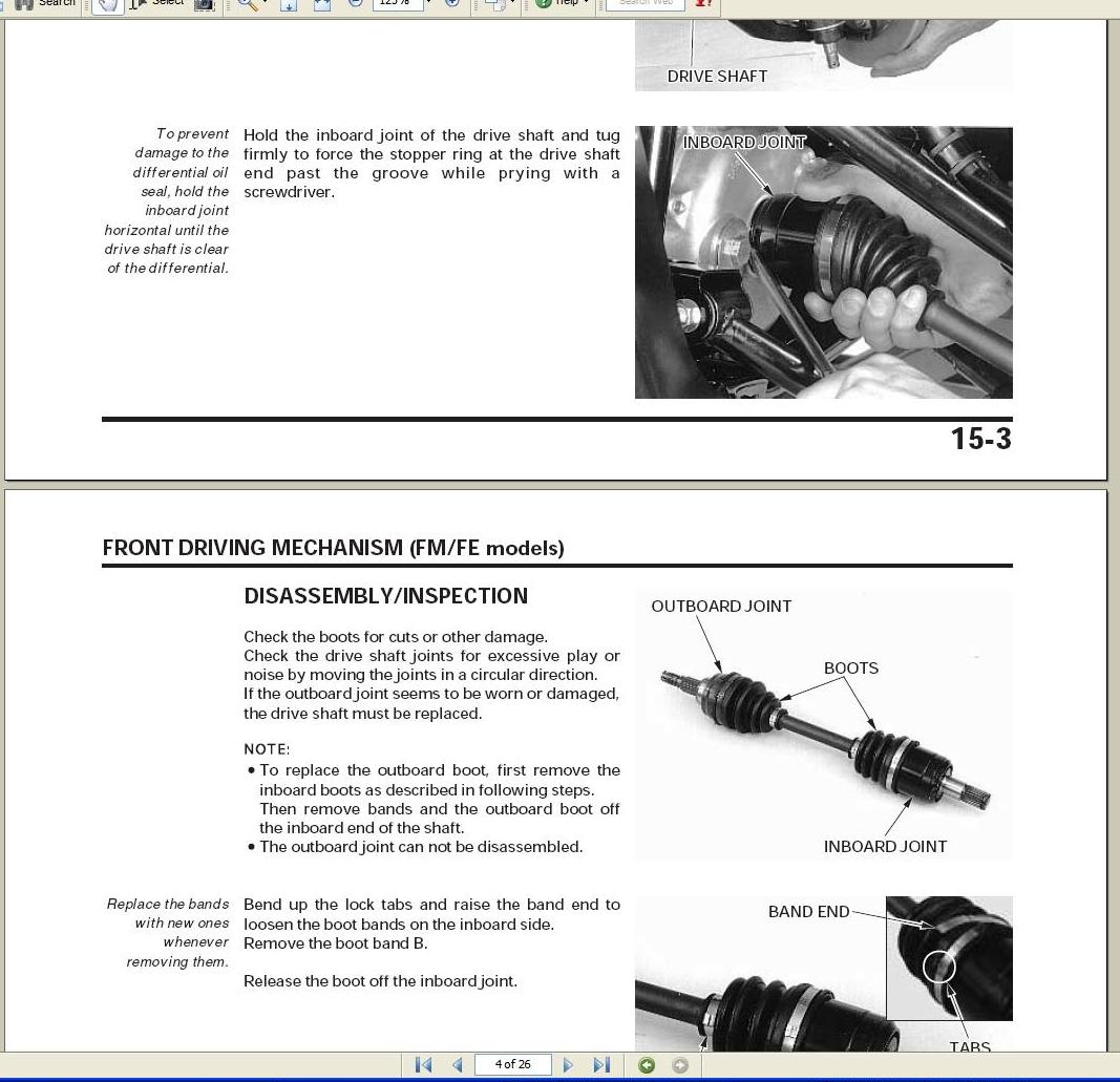

Pretty sure, but of course now the pressure is really on!! :D I guess my shop manual is at the weekend place..I hope..and the next trip isn't until Friday. But here is a screen shot of my Rancher which I believe is the same.
Hopefully I'll find that manual!!!!!

That's exactly what my axle looks like too. I printed it out and will take it to camp. Hope there is nothing special about the repairs. If I have time this weekend, I might take a bunch of photos to show the axle and rear brake repair too.

Any news or are you still on the road? I FINALLY found my manual!! That's one bad thing about having 2 places. You need 2 of everything OR what you need is always at the other place.
Anywho, my manual only goes up to 1995. I didn't look close this weekend because it was the Ranchers turn for work. The manual shows u-joints but I may have CV joints in my 1999 model. The manual says a slide hammer to pull them straight out. I hope you checked those boots because that's what kills most CV joints when they get dirt in them.

After making notes of what I thought was broken, I went on line to order new parts. A whole new right rear axle assembly complete with CV joints and new rubber boots, a new right rear brake caliper and a new foot brake cable assembly. The rotor was fine so I did not buy that. After receiving the parts, I finally had time to dis-assemble the CAT and make the repairs. One thing I was not sure of was how to get the old axle out of the rear differential? You can see I posted here and got help. You can also see in the following photos that all you do is stick a screw driver blade behind the CV boot and pry while pulling hard, exactly as described in this thread. It popped right out.
