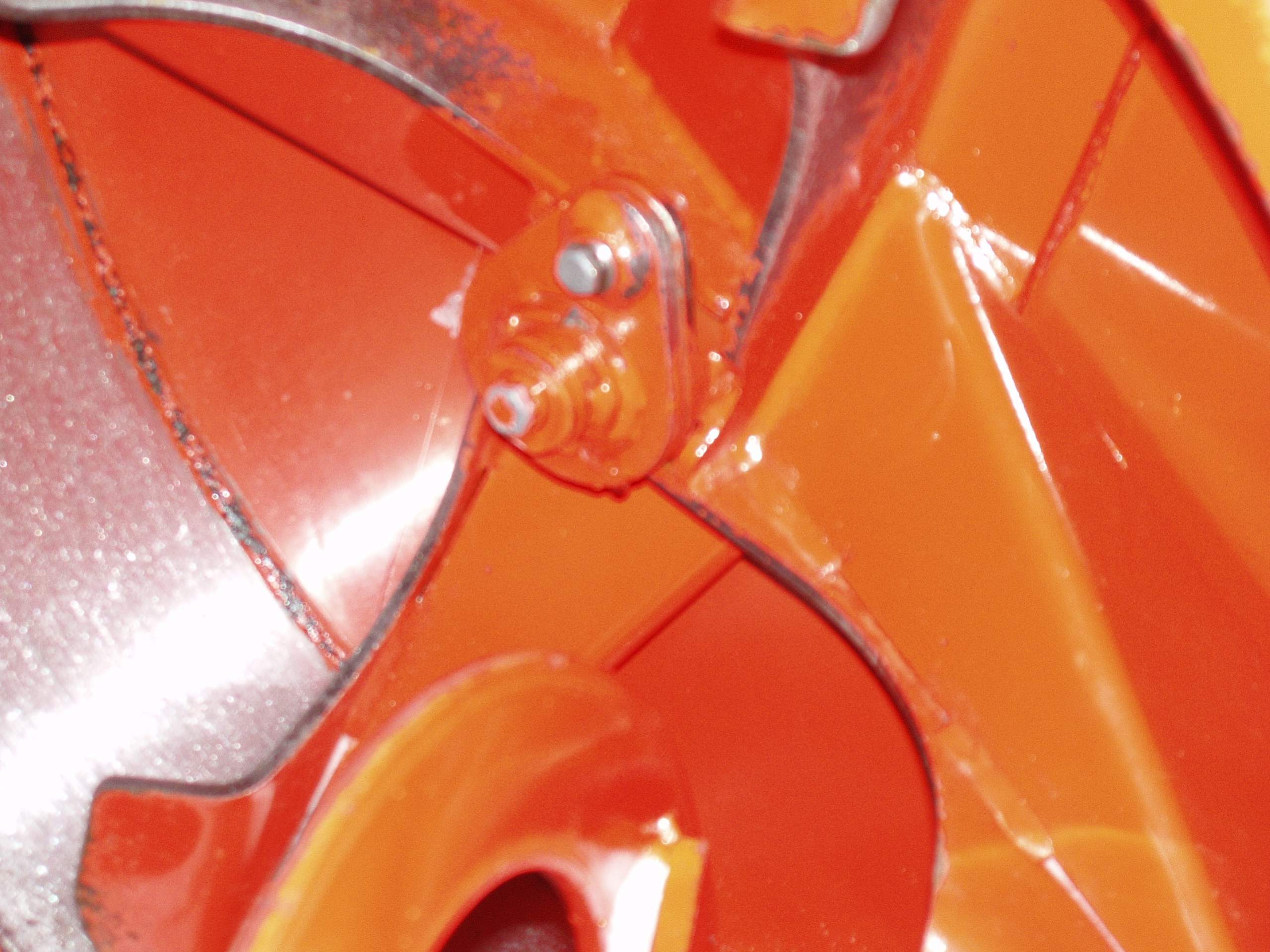

snapped chain.....twice

my experiance is if the shear bolt is loose the hole will wear,making it oval.Also about rocks getting into the chain,the augur is designed to pull snow from the sides of the machine and throw it into the impeller.If you think rocks are getting into the chain just get a guard for it.I think your shear bolts are to high a grade.Sometime they get labeled wrong.Use grade two on augur and grade five on impeller and change the chane to a higher grade chain.If its a 60c chain go to a 60hcrw
   / snapped chain.....twice #62
my experiance is if the shear bolt is loose the hole will wear,making it oval.I think your shear bolts are to high a grade.Sometime they get labeled wrong.Use grade two on augur and grade five on impeller and change the chane to a higher grade chain.If its a 60c chain go to a 60hcrw
Most all shear bolts only ride on the bolt and the holes do wear. However on a blower the parts are under power and should not move around too much when in use.
The Rad blowers are unique as they clamp 2 plates rather than going thru a shaft. Whatever the mechanism the bolt must be the drive or it cannot shear.
Also Rad who makes the blower in question clearly states grade 5 shear bolts.
Sometimes a softer bolt will stretch and not shear.
I will stick with what the manufacturer says to use.
   / snapped chain.....twice #63
I spoke to both of my dealers this morning and they said Kubota does not give a spec for shear bolt torque.
They both did say that they should be snugged and then backed off so the bolt could be rotated but the parts did not rattle around.
They both said too tight and they will not shear reliably.
Hope this helps someone.

Thanks. Didnt see that. They are differemt than mine. ... In that case tho I do not agree with Kubotas advice. If the shear bolt is not snug in that arrangement the joint can open some by spreading. That corrupts the shear. A shaft in tube design does not need to be snug since the shear area is well controlled by the size of the parts.

Kubota's advice is JUST snug not loose, but so that the bolt can be rotated some. I assume by light wrench pressure.
Mine is 4 winters old and I have no wear yet by using this method.

Negative, the bolts will shear when something gets into the augers(or fan) bad enough to stop them, but I think you are getting rocks into your chain, which is before the augers. Thus snapping the chain.
A 2 to 6 inch rock getting in between the chain and the sprocket is probably going to cause a problem.
(Blower picks it up with the snow......snow packs it into the the sides...........gets lodged between sprocket and gear...........snow keeps piling in pushing rock into sprocket.............)
I think we've found the problem.
What lead me to this conclusion was the amount of paint wear (and the pattern) on the blower, in such a short period of time.
I'm with you on this one, sounds and looks like rocks/gravel are running
thru the blower fairly regularly, and the bigger ones may be in the auger,
but smaller ones may very well be in the chain/sprocket area.

They are tight, but i am going to loosen them a bit before I use it again. Had to put the blade on since it rain and turned the road to slush. We evn had to get the old TD-6 out to help clear the roads. I found something the tractor had a hard time doing and didn't want to tear it up.

I may have missed where you said what the shear bolt was.
A lot of times I'll see people using any old bolt or rod in place of the shear pin/bolt.
Such is a disaster waiting to happen.
Regular bolts are hardened metal. Shear pins are soft metal specifically to be cut through. I've made "shear pins/bolts" from scratch by cutting rod stock or from regular bolts and heating them red hot and letting them cool slowly without quenching in order to take the temper out of them, rendering them much softer than normal. Still not the best solution, but can work in a pinch.

Woah right there! Once you have blown the chain once, it will not hold the same again! All the links on the tension side of the original blow will always be weak in the future.
I chased the first chain I had on my blower with master links before I learned and bought a 10 ft roll. The new chain drasitically reduced my problems from a break every 5 hours to about a break a season. (I put about 100 hours a winter on blowing)
I also reduced my shear bolt size and grade but it still breaks chains before bolts.
Okay I am about to give up. Snapped the chain twice again. Once yesterday and again today. I have the 60H on already and the bolts just won't shear for some reason. It has the right bolts. I now have 5 master links in the chain. I did get a new chain so might change it out. Just don't understand this problem.

Woah right there! Once you have blown the chain once, it will not hold the same again! All the links on the tension side of the original blow will always be weak in the future.I chased the first chain I had on my blower with master links before I learned and bought a 10 ft roll. The new chain drasitically reduced my problems from a break every 5 hours to about a break a season. (I put about 100 hours a winter on blowing)
Exactly, and once a rock goes thru the sprcket, even though the chain didn't break at that exact time.........the chain is substantially weakened.
Best advice is to keep rocks out of the blower, especially one with an exposed chain.
   / snapped chain.....twice #79
Looking at your pics and noteing the hours of usage suggest that you blow lots of rocks.
(your blower housing is really battle scared for those low hours)
Every rock hit weakens the shear bolt a tad more each time and every bolt sheared puts a good shock load on the chain.
As stated in another post, once the chain snapped it snapped the weakest link but then all the other links became that much weaker.
I don't think the blower is much at fault but rather your drive is.
I'd suggest a new chain and adjust the skid shoes higher to avoid plucking stones.
I know that blower and it is real tough but there is just so much it can take.
